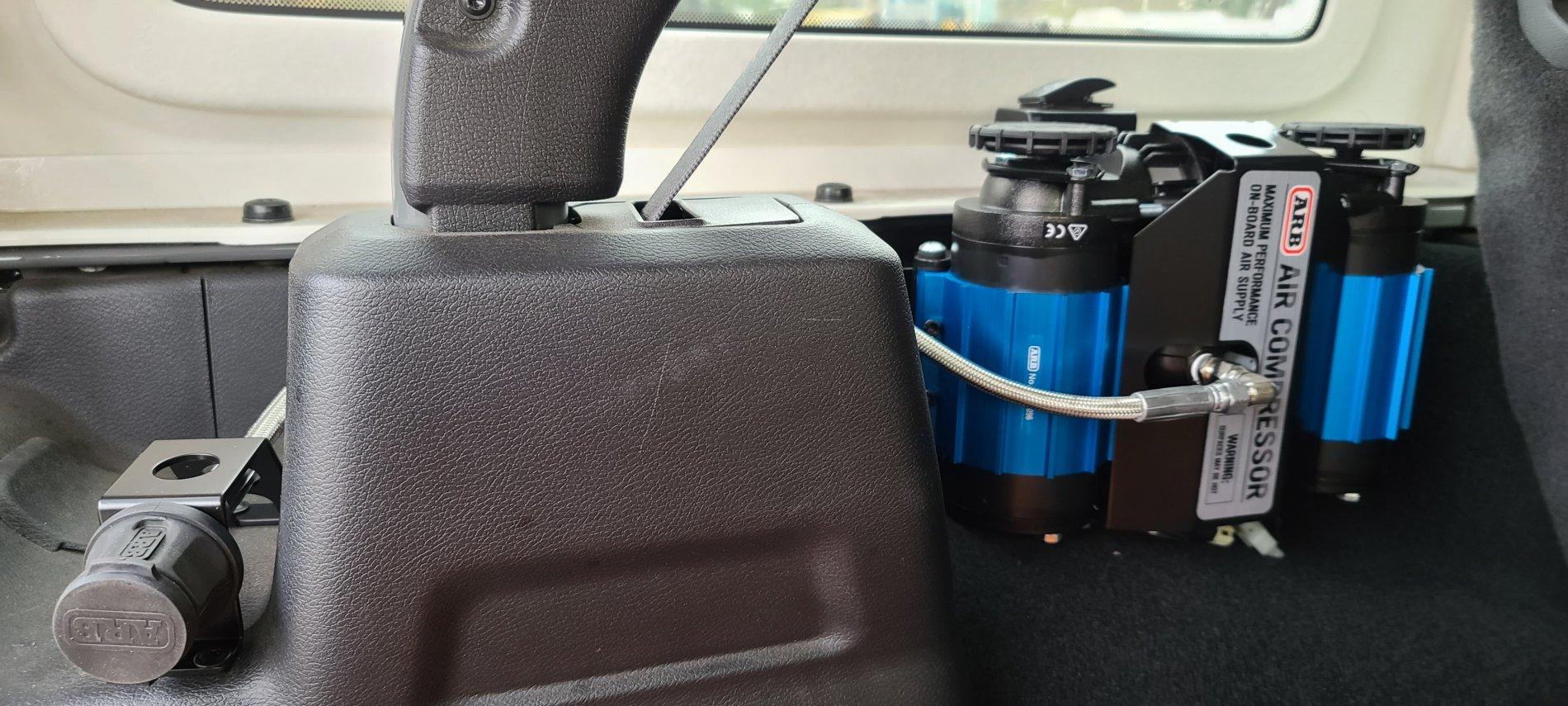

...having lots of water in the air lines, has been like that since day 1.
Any tricks to get rid of the moisture build up?
Am I doing something wrong? Mounted in the rear inside cabin.

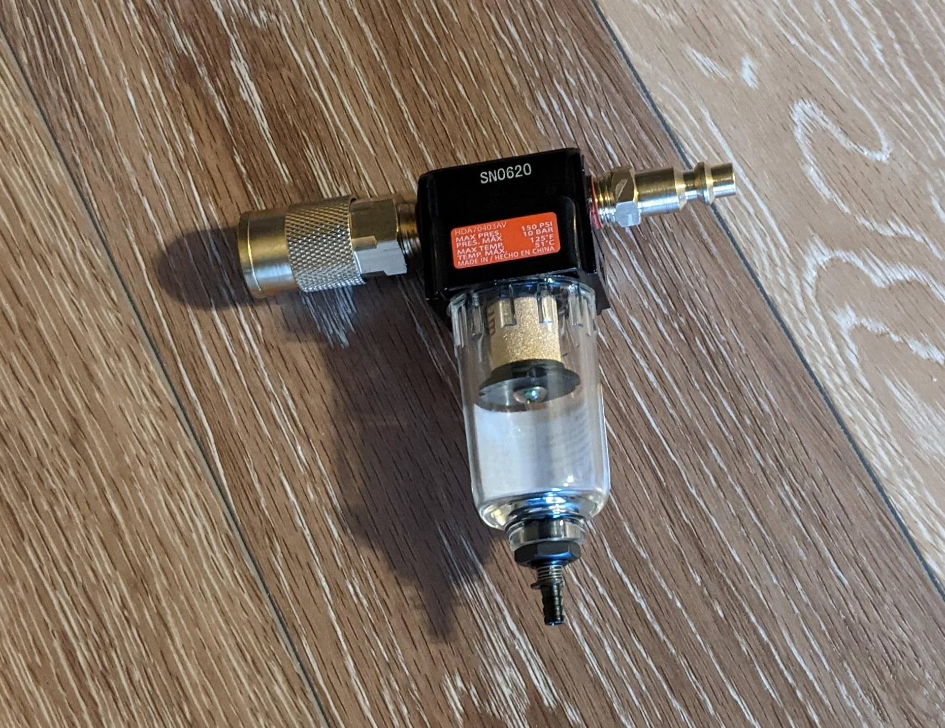

You should build an inline filter and plug it in before your hose whenever you use your air compressor.

I've been thinking of adding one of these. Note that you want the filter located far enough away from the compressor, where the air has cooled down enough for the moisture to condense. Also, don't want it too far away and have moisture collecting in more piping. I'd put one between my relocated coupler and air line.

I keep the filter in my bag of air stuff and just plug it into the coupler before I plug in a hose. I have basically the same set up as you but I have a JL.

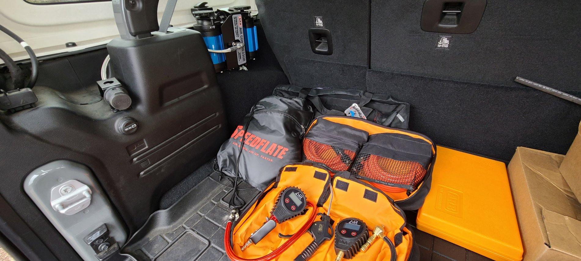

I just so happen to have an empty pouch in my medium size arb bag. I also want to add a regulator to the arsenal.
Do you have links to your bag of goodies here?
