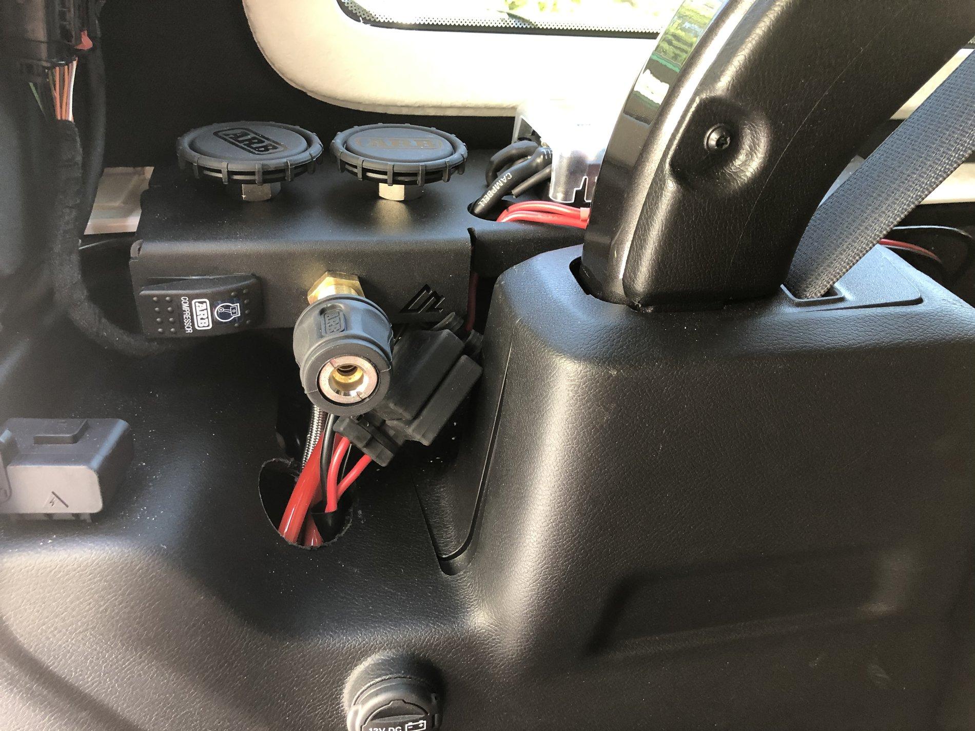

I went with American Adventure Lab and added their fuse panel and air chuck mounting solution. They are neat people and they build quality stuff.
