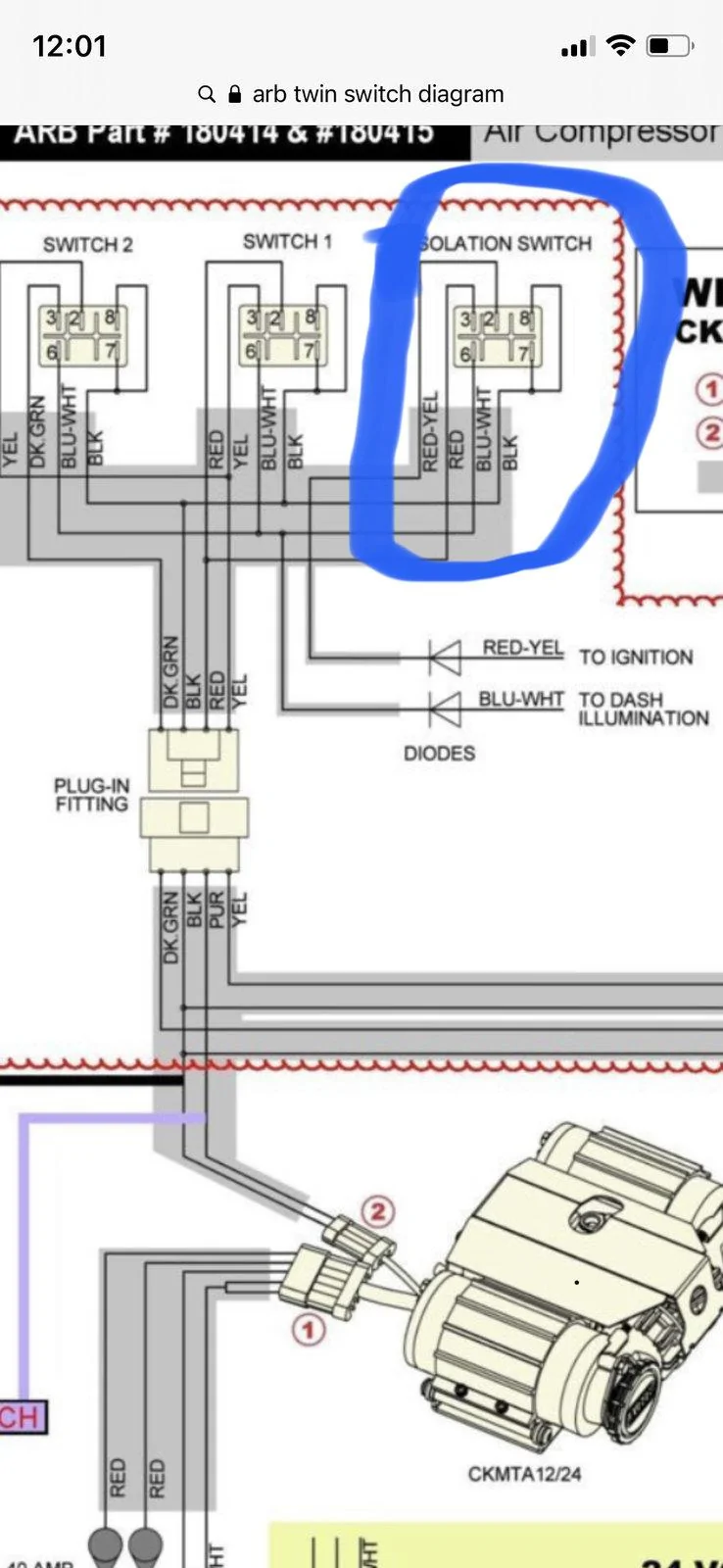

So, if I want to just use the ARB switch on the ignition wire under the glove box, any idea which lead I connect it

Right now I have the ARB twin on aux4. I’ve decided to use the ARB switch instead of my aux switch. I don’t care about the dimming function, but can I split the under dash ignition wire into 2 and to light up and power the switch? And obviously ground the switch as well.

I know which wire is the ignition wire, I meant how would I wire that to the ARB switch to also have the LED work. I don’t care about it dimming.
Could I just split the ignition wire into two wires and run it to 2 and 6 on the ARB switch so it has power and light to the switch on ignition? Then the purple wire from the compressor to 3 and then 5 and 6 to ground?
EDIT: 7 and 8 to ground
1. Just run one wire from the ignition switched lead to 2 (input), and then run a small jumper from 2 to 6 (switch lighting). Keep in mind the switch will be lit at full brightness whenever the ignition is on (may be distracting at night).
2. Yes, purple wire from the compressor goes to 3 (output) on the switch.
3. Not sure where you got 5 and 6 to ground. Diagram shows 7 and 8 to ground, no?
I took a different approach to switch lighting. Hooked mine up to the dome light circuit so it comes on full brightness when I open the door, and then fades to black after closing the door. Takes a little bit of digging in the harness under the seat, but I’m happy with how it turned out.
Yeah I must’ve been looking at a different diagram or something, but yeah ground to 7&8.
Does the black ground wire from the compressor need a split for 7 and 8 on the isolation switch, or do one of those positions need a chassis ground strap? The schematic looks like a jumper, but my main power harness extension from up down air came with a small 12" long black ground strap with an eyelet on one end and a female spade on the other. Not sure what else that could be used for. Thanks for the help and clarification!
I’m not familiar with the Up/Down kit. I could see using a ground strap for the compressor maybe, but the isolation switch has such minimal draw, it would be complete overkill for that. You could really tap the switch grounds into any ground.
I performed surgery on the ARB harnesses, stripping out all the unnecessary wires and shortening everything to meet my needs. I ran a heavy, dedicated ground for the compressor back to the ground post behind the passenger side kick panel. I ran a small, shared ground wire for pins 7 & 8 back to that same post. 7 & 8 were jumpered together behind the switch.
You could tie them all together if you wanted, I just don’t like splicing a small wire into a large one if I don’t have to. Separate wires also made sense since the compressor also had them separated into two different harness connectors.
