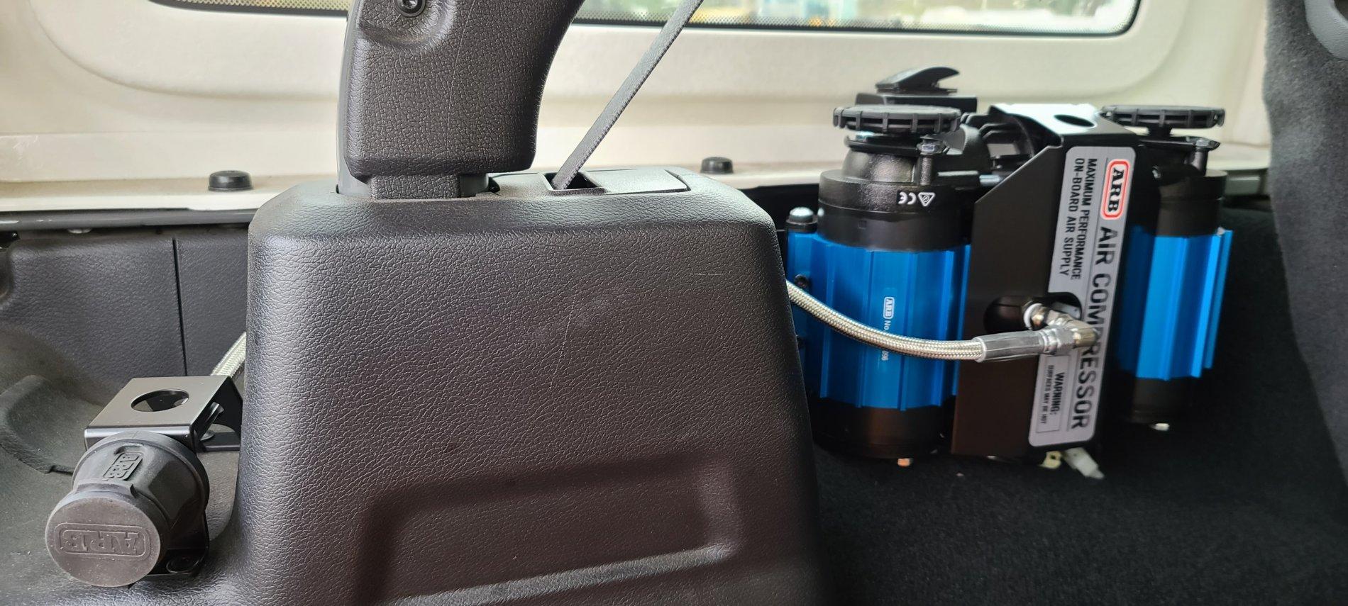

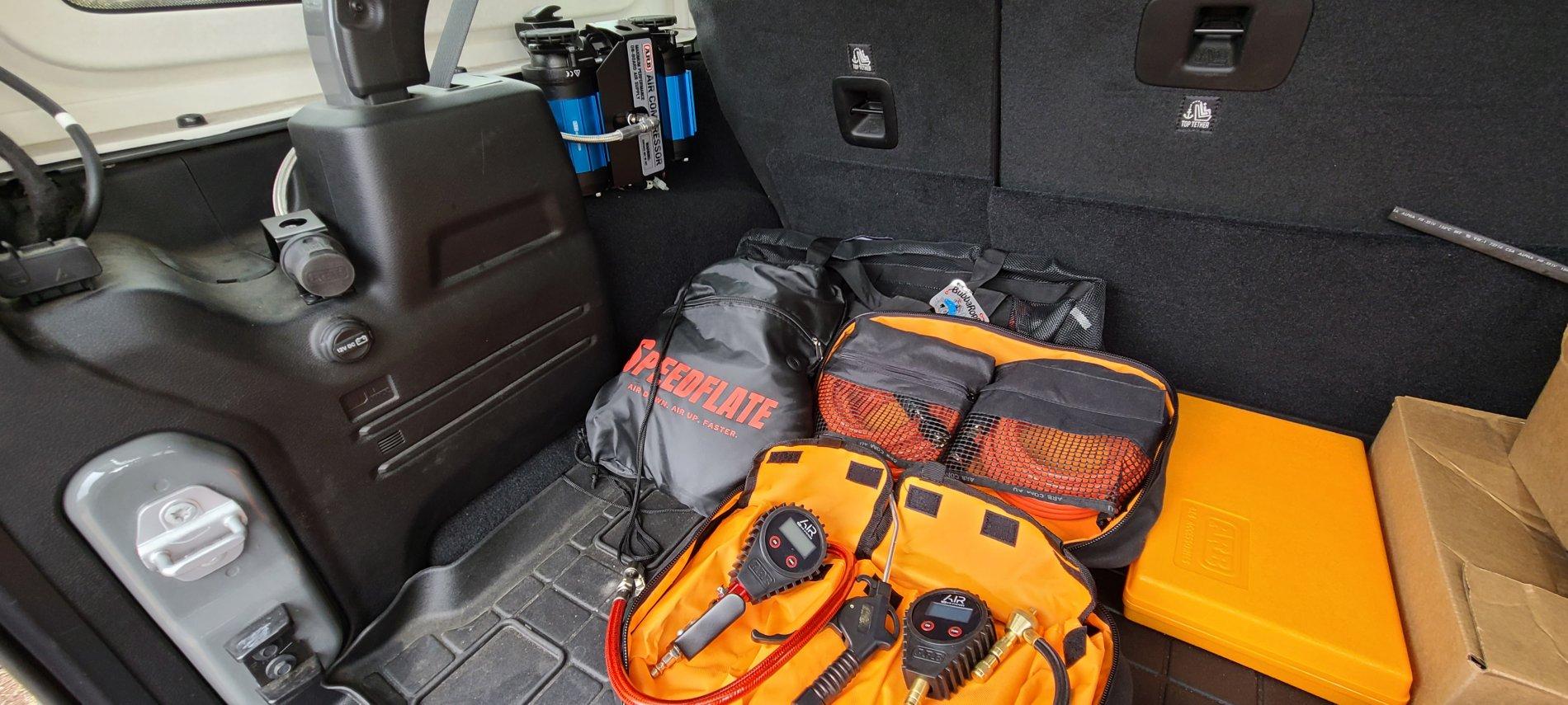

Same here. Didn't want to cram it under the hood, due to heat concerns. Aftermarket high tuck fender liners don't leave enough space in the wheelwell location. So, inside seemed to make the most sense for my specific needs. I used a .5 meter stainless Teflon braided line and a remote coupler bracket to reduce the reach and to give the air a chance to cool down.

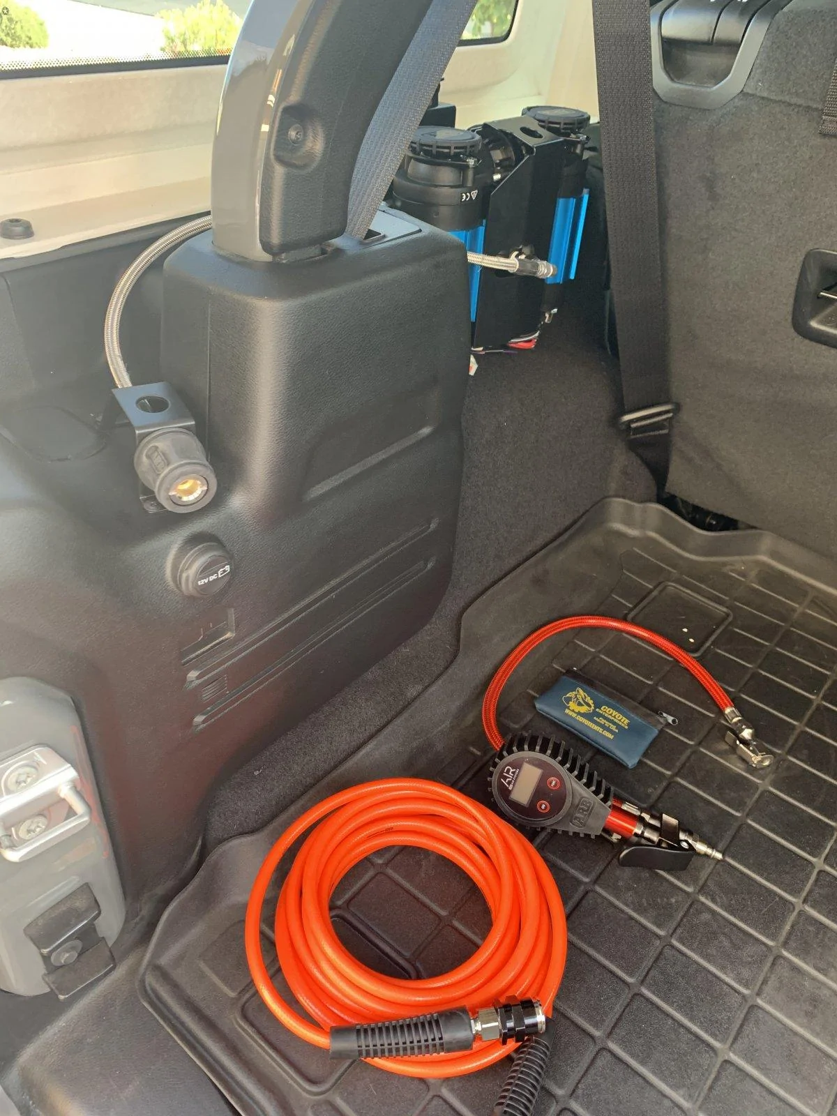

I copied Headbarcode. Used the Moore Mount. While it’s loud inside it doesn’t take long. My wife and dog have stayed inside with no issue.
