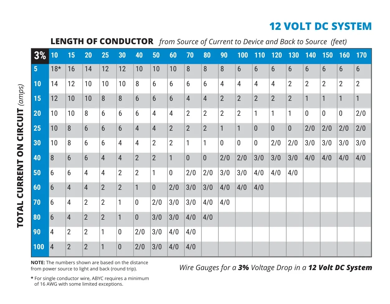

If you know the component current draw and the length of the wires, you can use the chart below. You size the fuse to protect the wire, not the component. If your wire is capable of only 40 amps safely, you fuse to that. If your component blows the fuse regularly, you need bigger wire and fuse.
Jeep Wrangler JL ARB Twin compressor wiring question wire sizing chart
