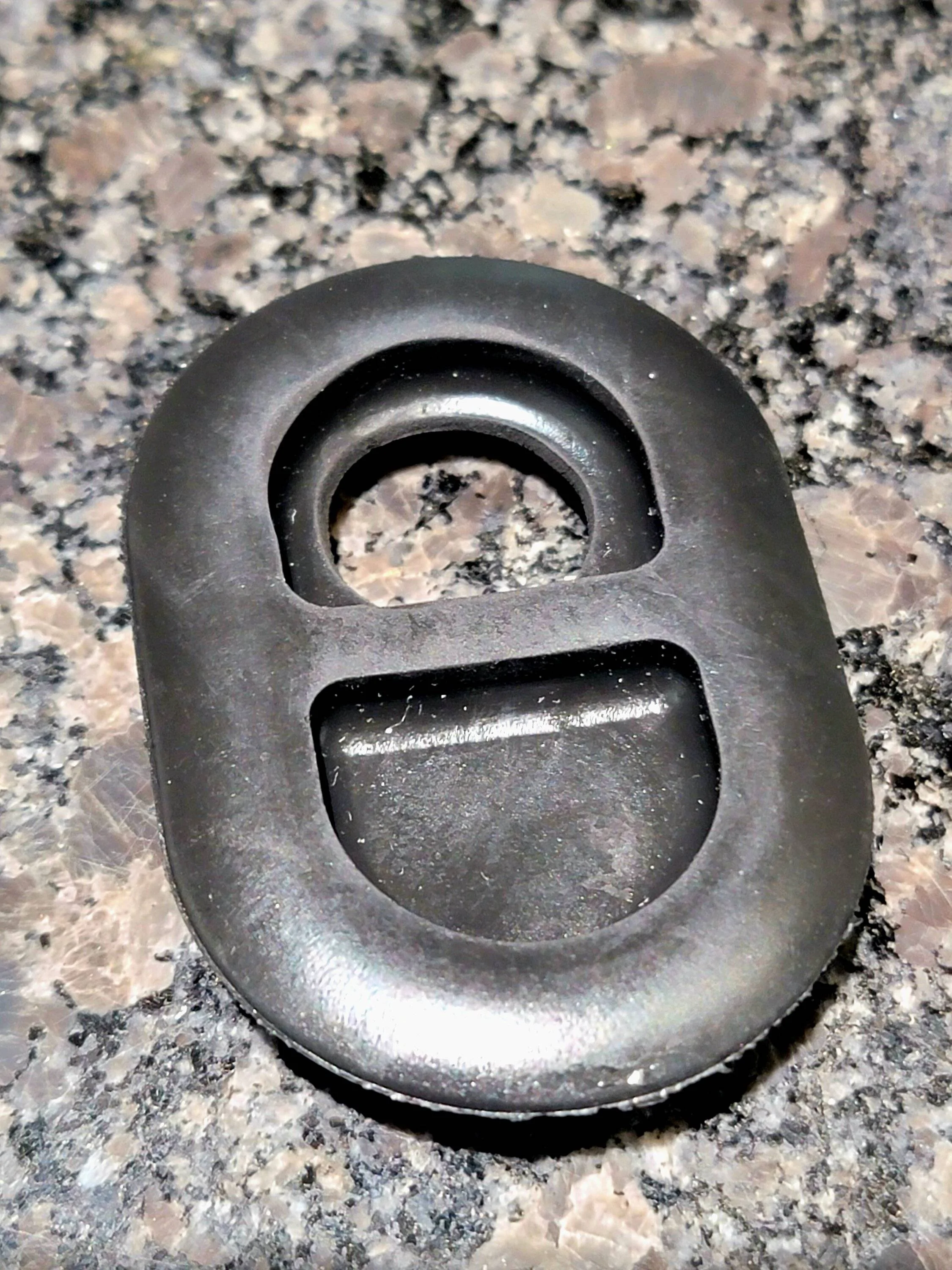

There should be a grommet in the lower kick panel where your aux wires come through that you can run the power wires back up to the battery. It may be better to pull the inner liner or entire fender to make it easier on you. There should be a trigger wire in the ARB harness that you can wire to the Aux switch to turn it on and off.

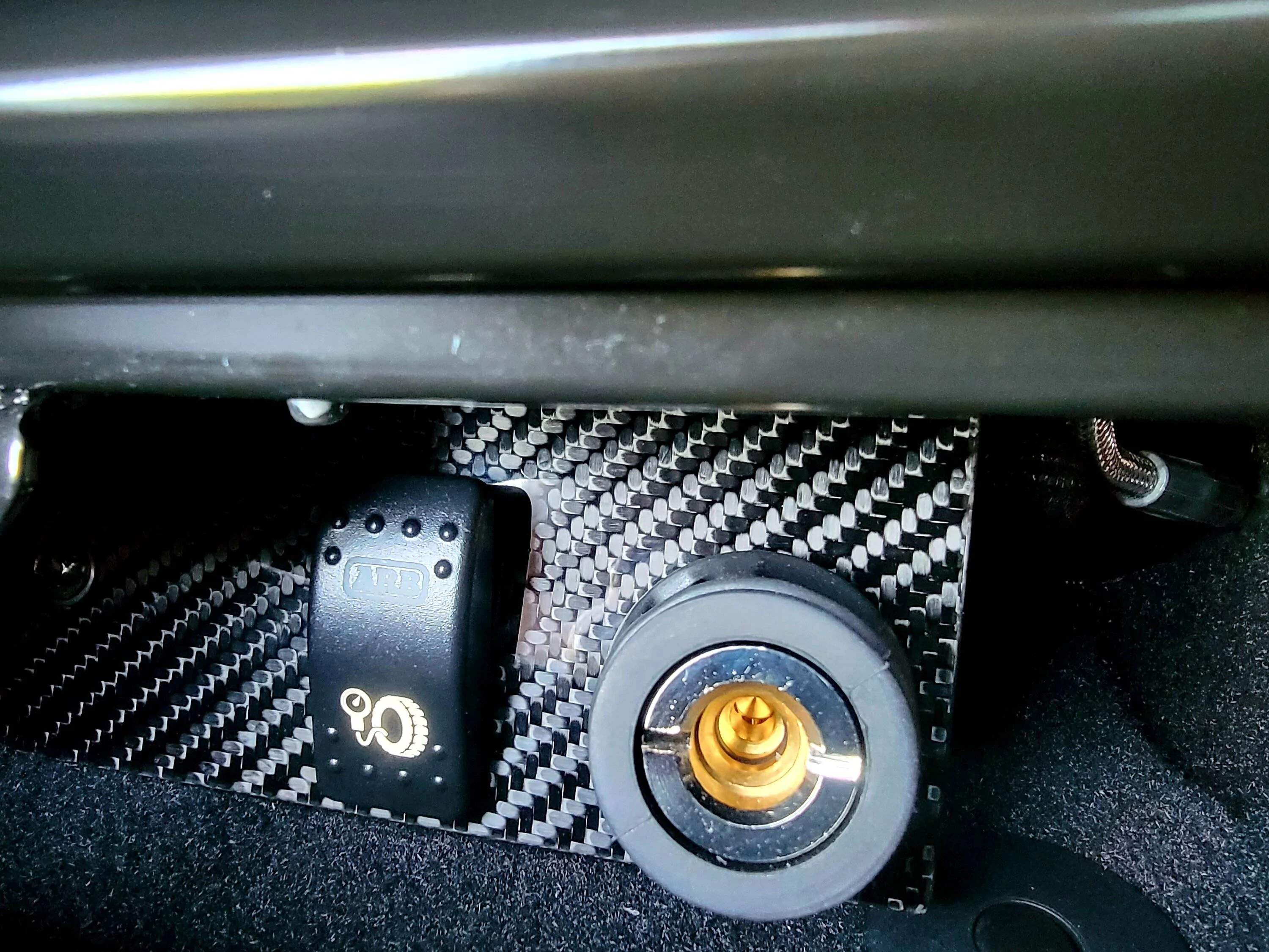

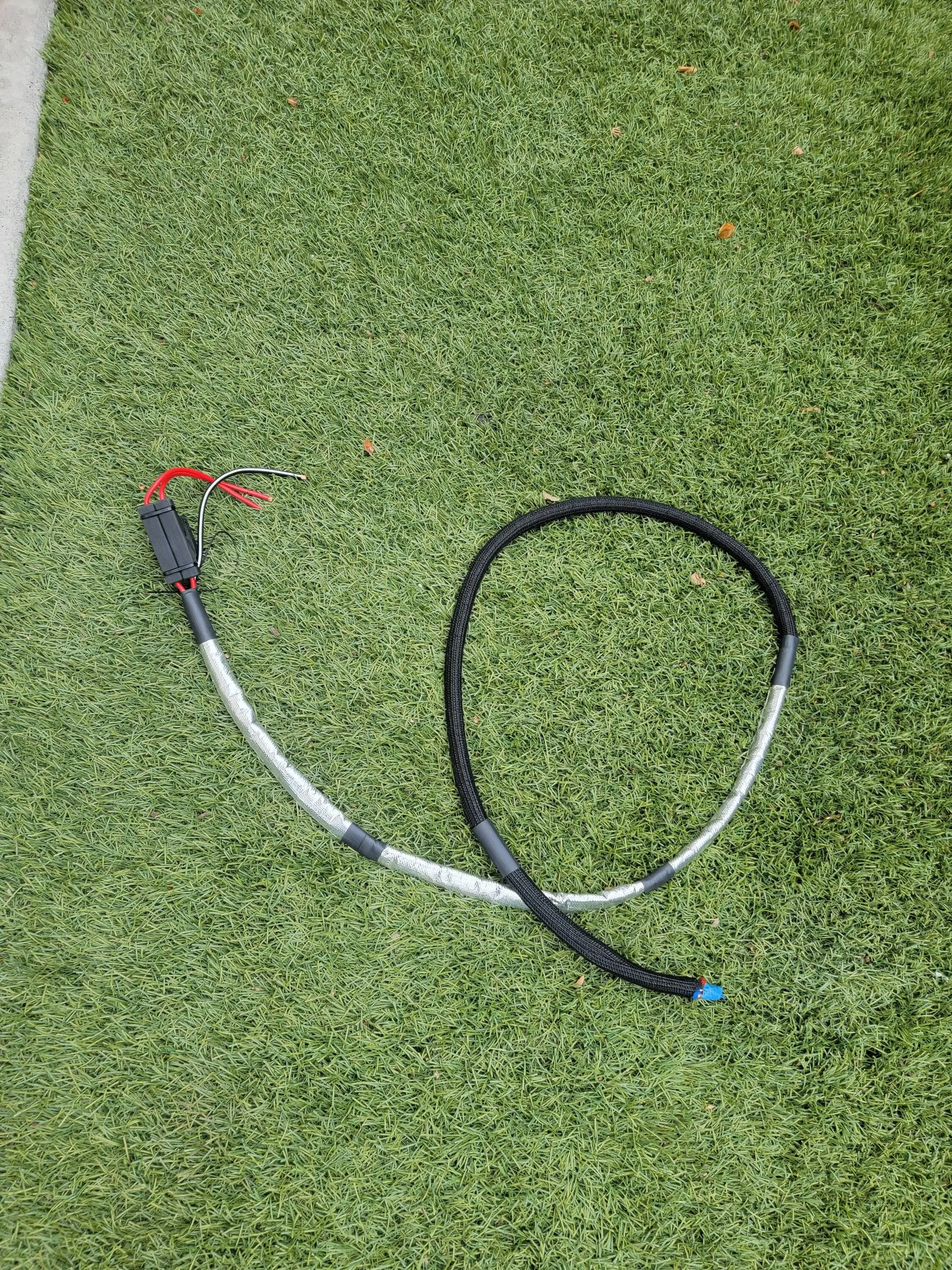

Jeep Wrangler JL Arb twin compressor underseat mount. 20220403_140322
Jeep Wrangler JL Arb twin compressor underseat mount. 20220403_152400
Jeep Wrangler JL Arb twin compressor underseat mount. 20220403_114859
Jeep Wrangler JL Arb twin compressor underseat mount. 20220407_181804
I ran the wires from the grommet along the top of the farme wire tied to an existing harness. Then up the fender well to the battery and ground. I wrapped the harness with heat protection in the engine compartment. The 392 is a little warm in that area.
