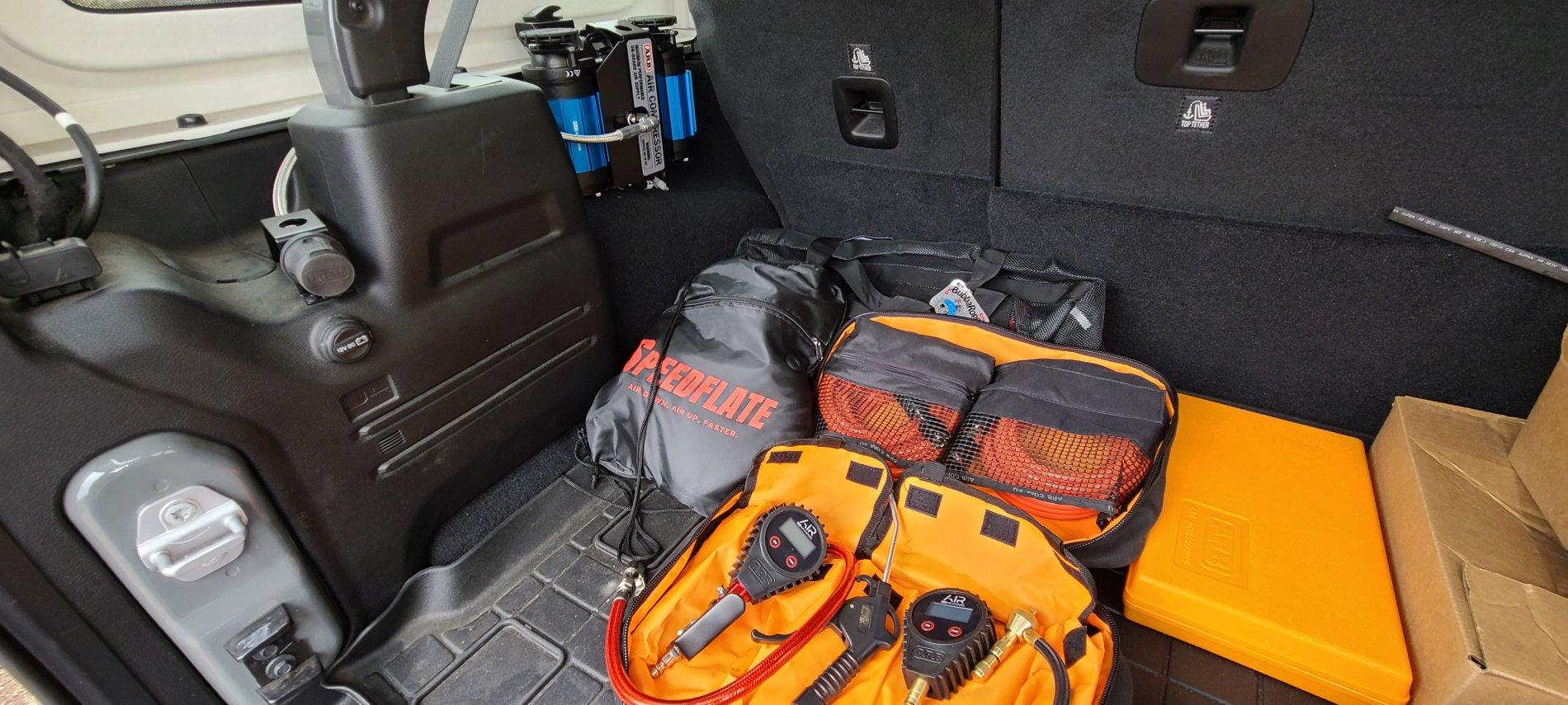

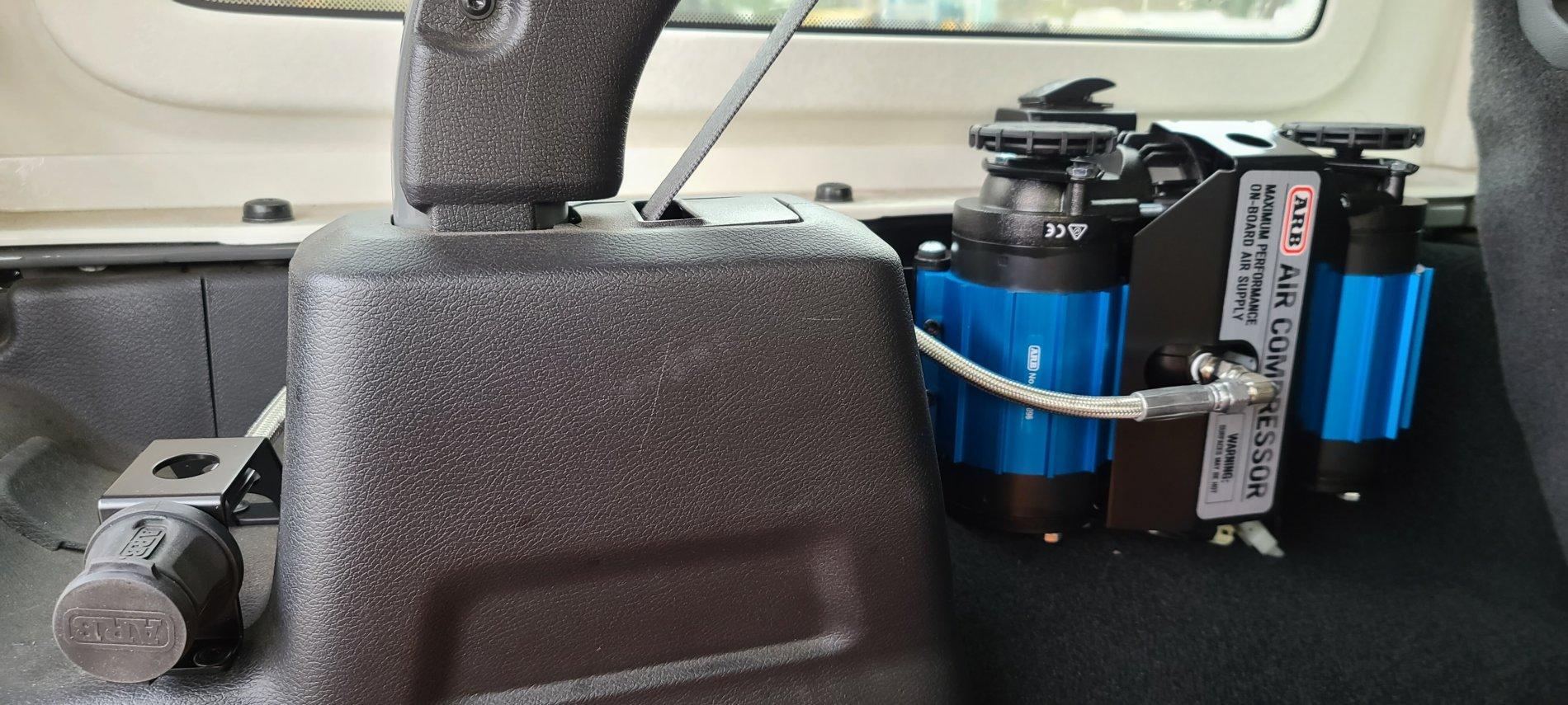

I finally wired up my ARB twin, which is on the MORE cargo mount. I didn't want it out in the weather, and I didn't want it under the front passenger seat. Most of my off roading is during the winter, so didn't like the idea of having it sitting under a heated seat next to a hot air duct. I also didn't want to waste an aux switch, so I used the ARB one mounted on the top of the compressor mount. I wired it to the pink w/ orange stripe hot with ignition wire in the aux wiring bundle under the glove box. The cargo area is a great work table for setup and breakdown. Also, I got an 18" long Teflon stainless braided line for the output and a qd mount with dust cover, to get the hookup closer to the tailgate. Very happy with the setup. Well worth the time filling the swear jar. Lol
Also, I like to depressurize the compressor before disconnecting the air line.

Could the compressor be flipped 180° on the 813 mount? I like it, and as you said, JKs have been using a similar location for years. Those intake extensions seem super long though. Those concern me more than the mount location. If the compressor was spun around, the extensions wouldn’t be necessary.
I'll look again but believe it puts the filters into the battery too much.

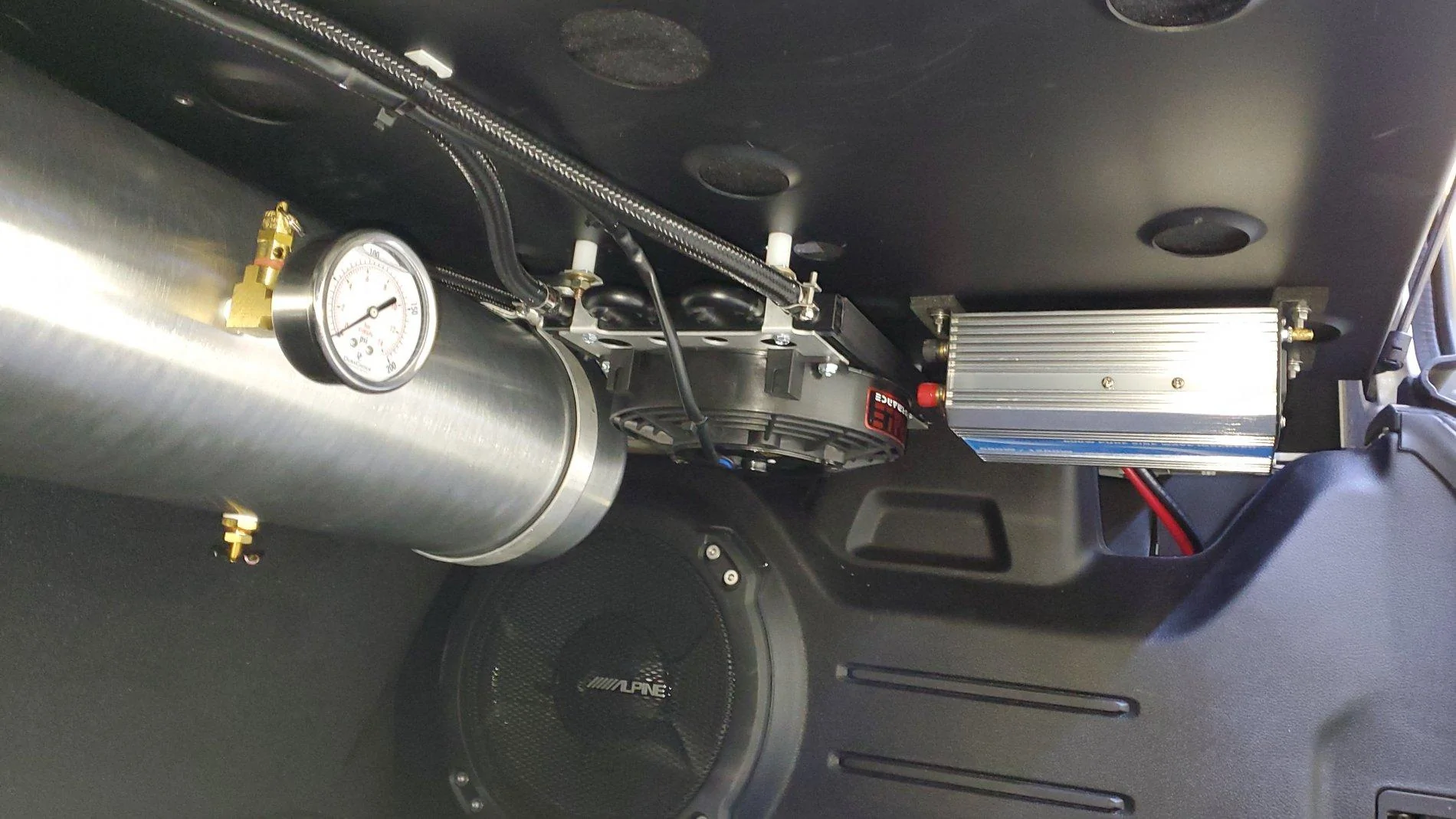

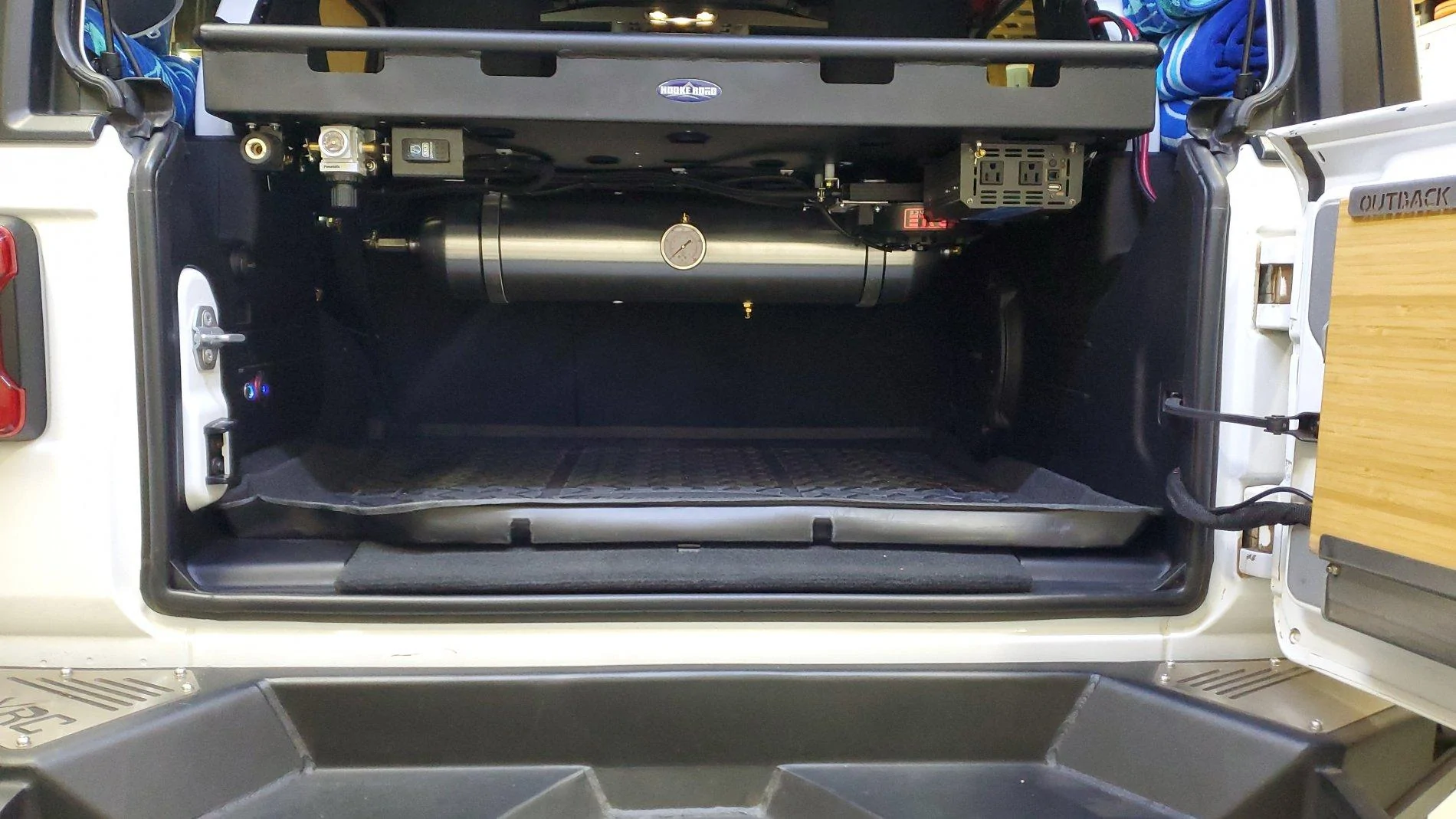

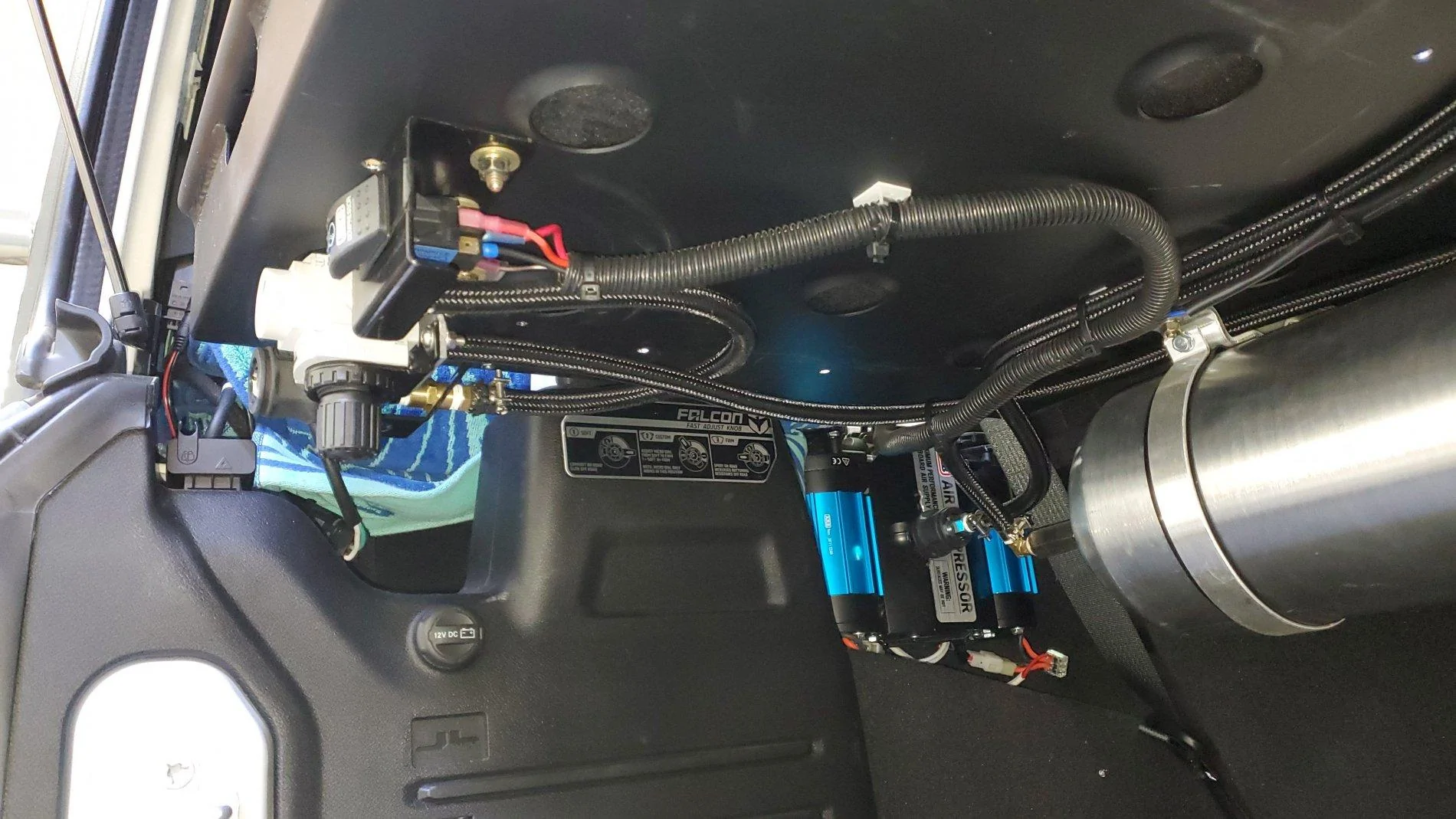

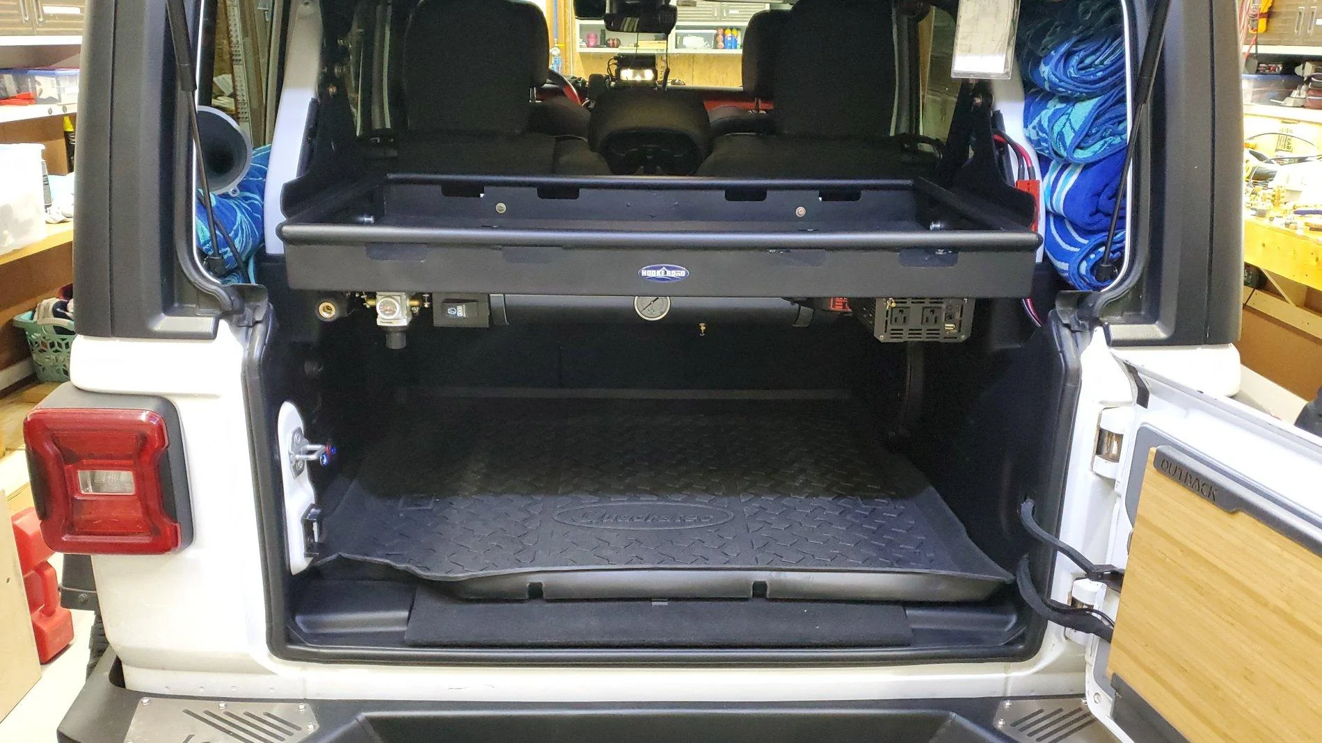

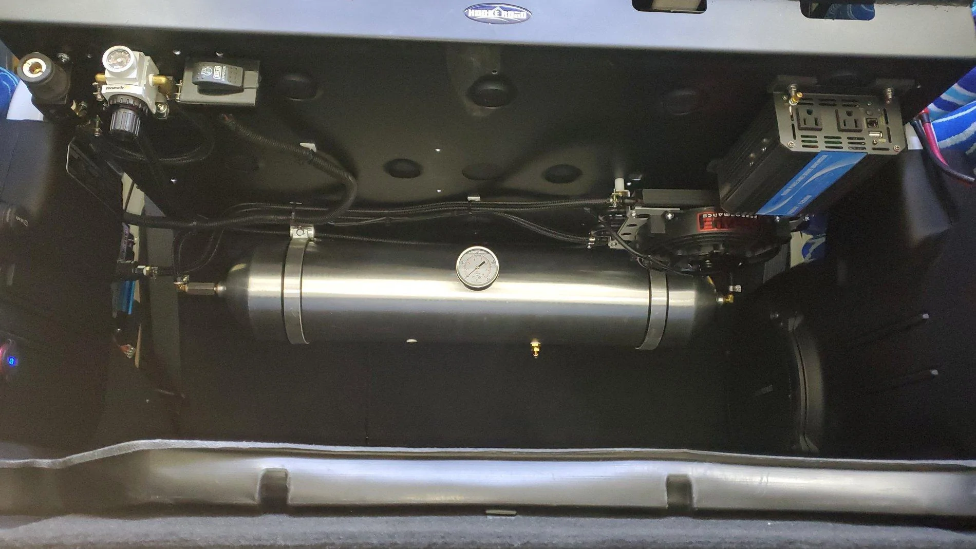

I installed my dual ARB compressor on the MORE mount. It seems solid, keeps it inside and I can't imagine using that little pocket of space for anything else. It is a little hard to reach all the way up in the cargo area and then push sideways to attach the air quick connect so I decided to mount a remote quick connect. This got me thinking about any other "upgrades" I wanted to do. I asked myself what I didn't like about the setup.
Items I didn't like:
1. Reaching all the way up inside the cargo area and then pushing sideways to attach quick connect got old.
2. Air hose got extremely hot after a few minutes.
3. Compressor cycled on and off numerous times the instance you put a load on it and removed the load.
4. Got tired of opening rear door and flipping switch to turn it on.
5. Also got tired of realizing I need ignition on.
6. Every item I used on the compressor was always exposed to max pressure.
7. I didn't like all the water going into the tires.
Solutions:
1. Add an ARB remote quick connect and mount
2. Add a cooler.
3. Add a 5 gallon air tank.
4. Move ARB switch to rear next to remote mount.
5. Move the switch power over to straight from battery. I realized with my dual battery setup I could run compressor for 2 hours.
6. Add regulator.
7. Add cooler and separator (tank) with drain valve.
The real reason this project was so easy was because I have a cargo area rack. I bought the rack obviously for more storage space but the icing on the cake is the rack gives me a platform to mount stuff to. I don't mind the least bit drilling holes in the sheet metal and mounting anything. If I change my mind latter no big deal. I cut a piece of 1/4" rubber matting to put inside the tray so items don't move around, but also so I can cut out small portions of the mat around the bolt heads. This keeps everything flat. If a year from now I have numerous holes I am not using I'll just cut another mat. I also added a check valve on the inlet to the tank so if the compress or the cooler has a small leak, the tank will stay at pressure. I also added a relief valve, drain valve and pressure gauge to tank. The air cooler is a Derale unit. I modeled the setup and 80% of the water is removed and the air temp is only a couple degrees above ambient vs 200-300F. I also did an aluminum tank so I wouldn't have to worry about rust inside. If I don't drain it but once a year I'm fine. I also did a quick test and stuck my Fluke thermocouple inside the compressor discharge air stream and it was surprisingly 35F warmer than the surface temp of say a quick connect fitting. So I was getting 220F at 70F ambient so I thing 250F maximum for 100F is conservative. Just make sure whatever hoses you use are good to 250F. Rubber hose I used was good to 300F. Tailonz Pneumatic Air Line on Amazon is 248F max. The blue cheap very common air hose that I use to air my tires up (many of us use) is only good to 140F.
I know.....a little more info than the thread called for but I am addicted to helping........

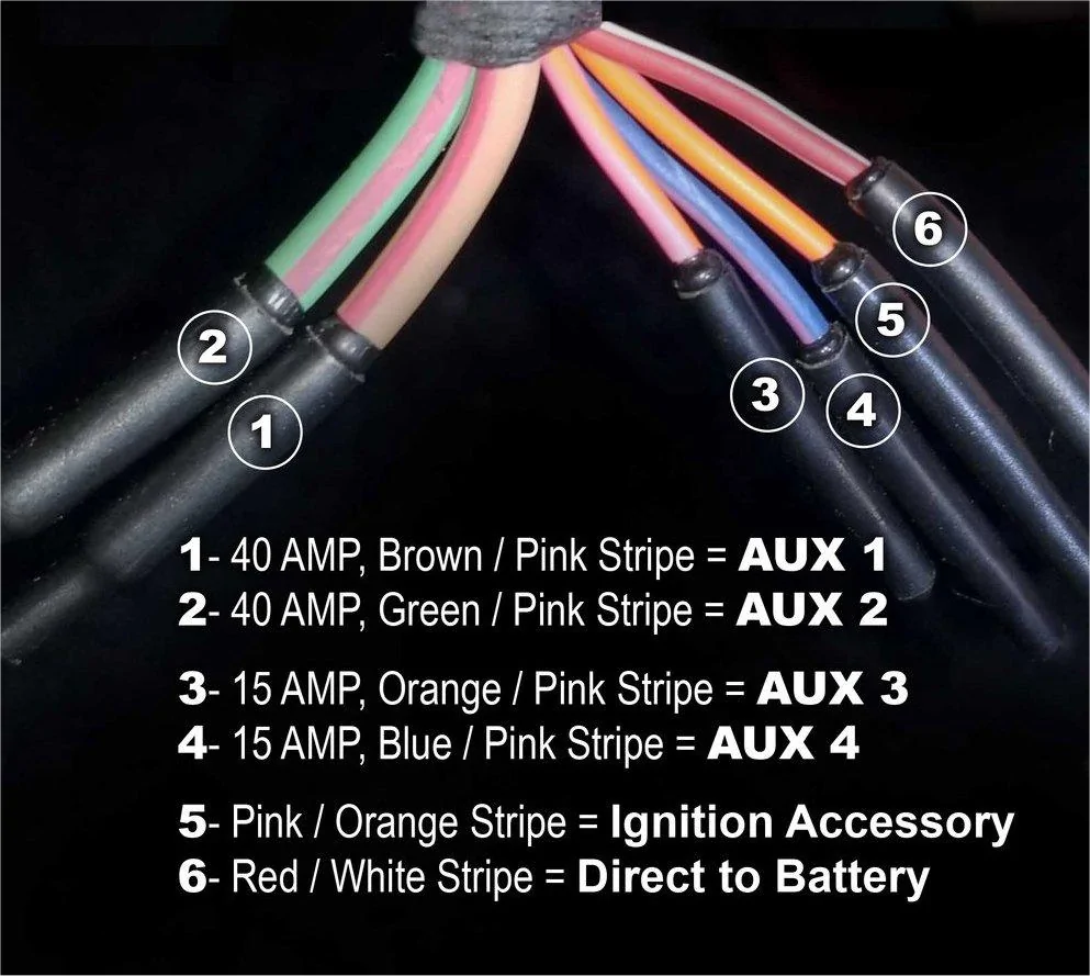

Does your Rubi have the aux switches from the tow package? If so, you can use one of the wires in the bundle under the glove box. I used the power with ignition on wire. #5 in this pic:
Jeep Wrangler JL Mounting ARB Air Compressor 12v source wires
Oh yeah, youll need a main harness extension to reach the batteries. I got a 9ft one, but should've gotten the 11ft one.
