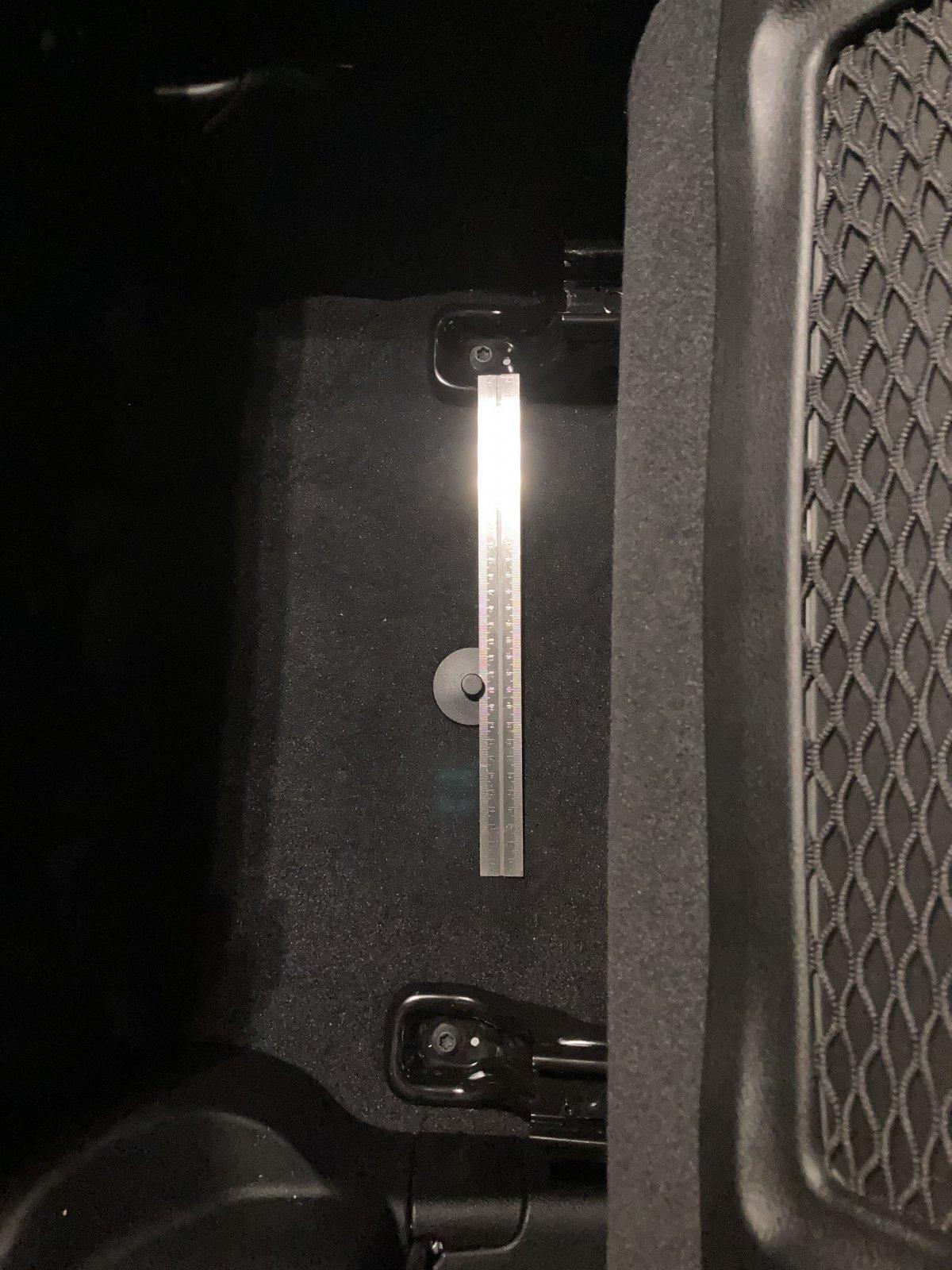

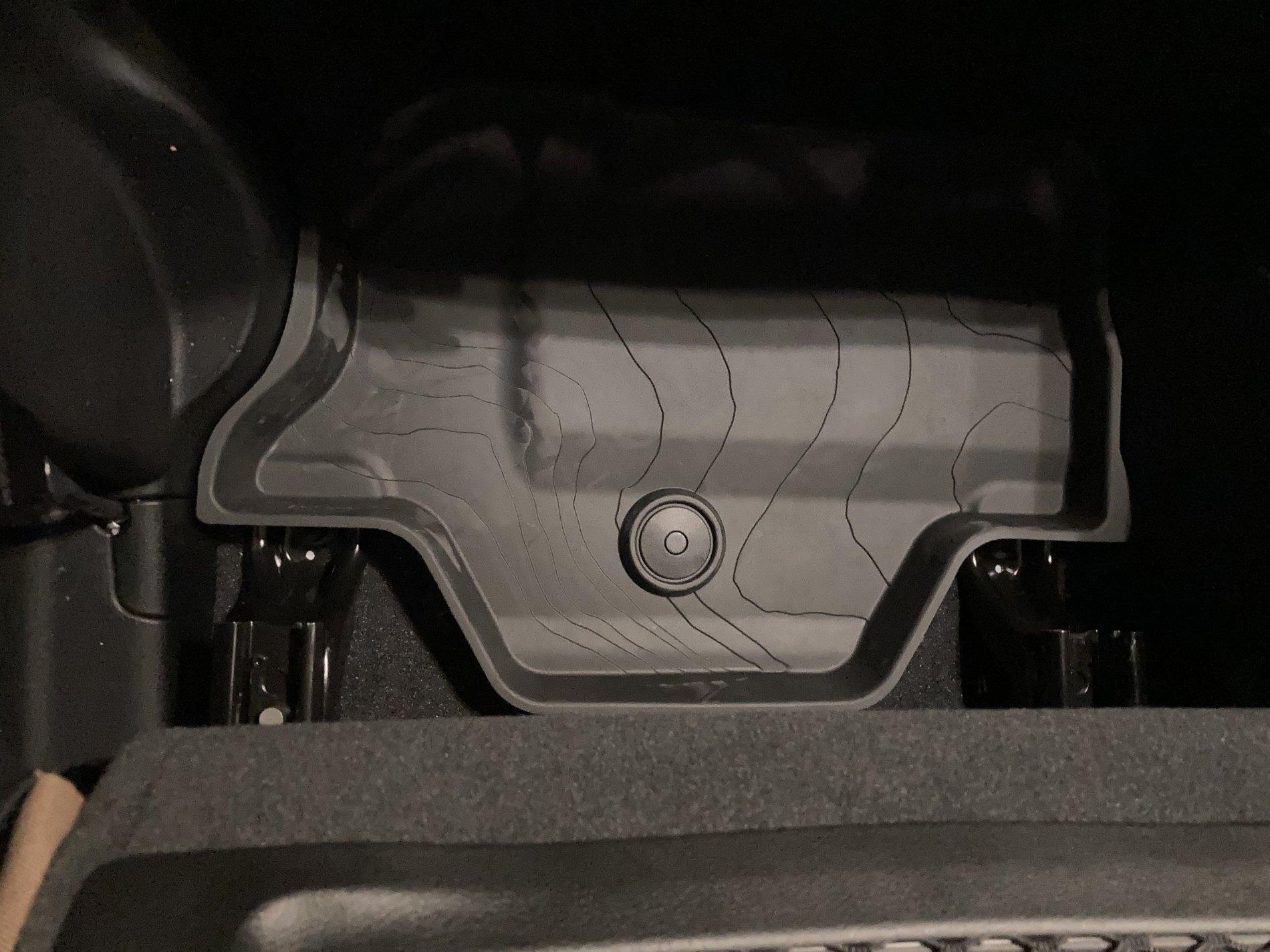

Just looking at the four door pictures and then looking at my two door, looks like will have to remove the rear seat floor mat mount to use the Innovative bracket.

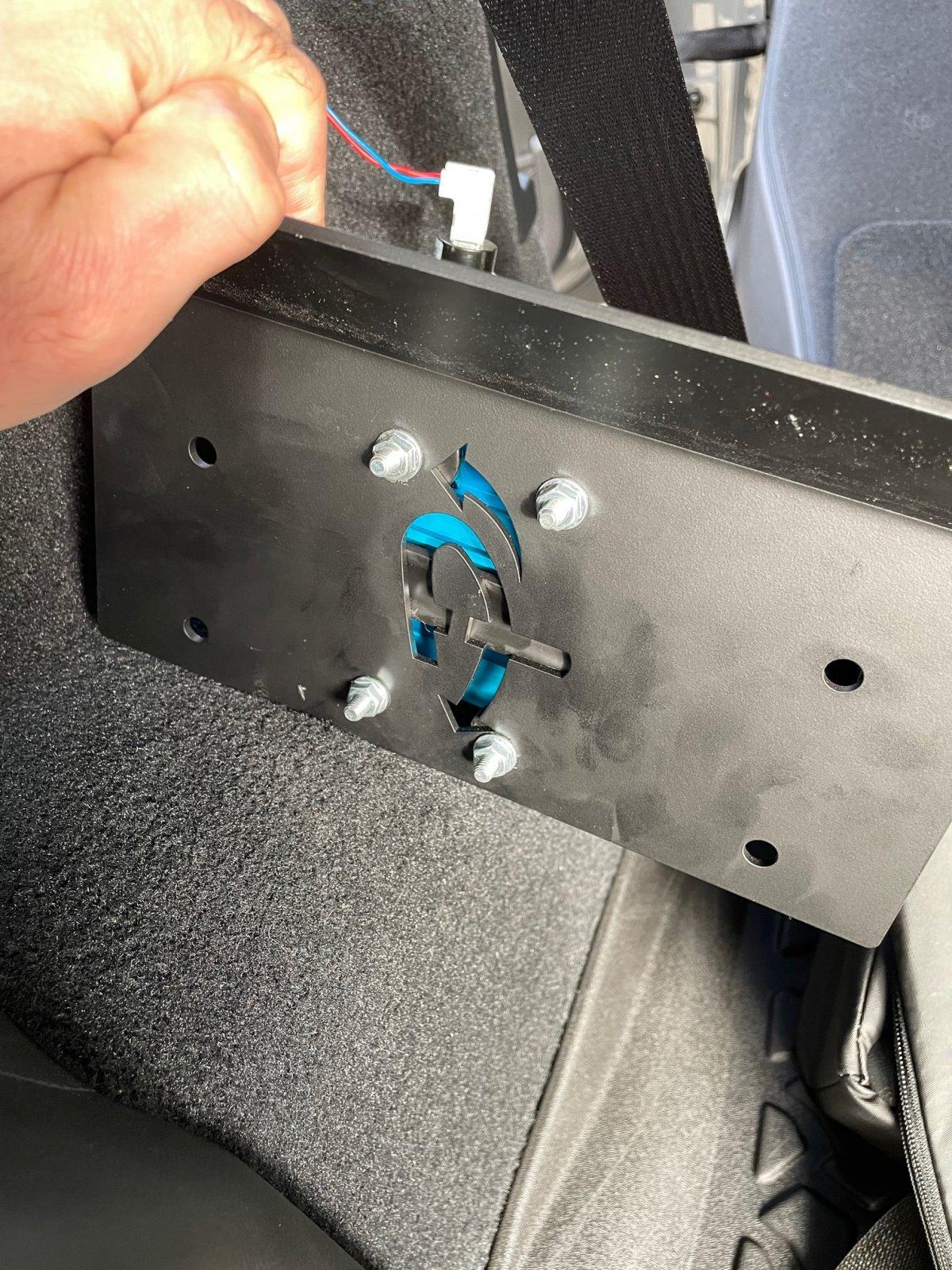

I've got this handy dandy universal mount in the back of a JL. Anyone recognize the brand on it....trying to ID it for member @RatherDashing
It simple sits on top of the hard top and uses the T50 mounts and holds compressor at 45. Driver's side.

There’s a couple cargo mounts like that for the JL. Also many local shops in AZ are fabricating their own.
Anyway it looks very similar to the MORE mount.
