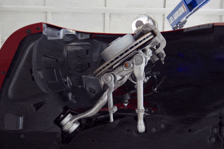

I mean if youre working on bmws that makes sense since they dont have an upper and lower control arm in the front and instead use a mcpherson strut in the front, but the rear has upper and lower control arms, and unless ya'll were just calling the upper a camber arm or something.
