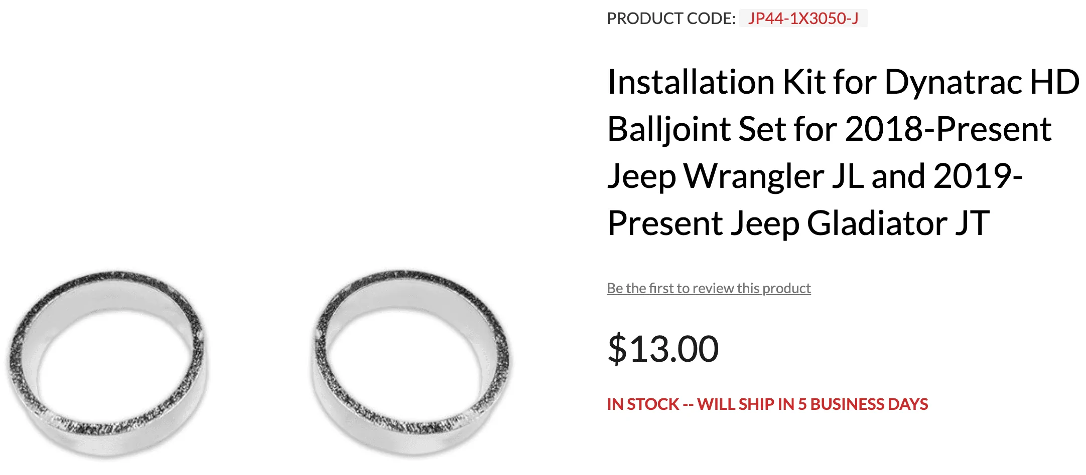

Be careful with the press when installing. The sleeve opposite the balljoint needs to have the angle of the knuckle yoke forging, so you don't force it in crooked (like someone posted).

I'll definitely be careful to do it right!
With the giant caveat that I haven't yet studied instructions or watched videos to learn how to do this (which I intend on devoting significant time to before starting), I did decide to purchase this assuming it will make the install easier:
Jeep Wrangler JL DW experts... ASSEMBLE! Screenshot 2024-02-16 at 10.35.19
Will these help with what you're talking about? They were only $22 with shipping so I figured I might as well get them.
