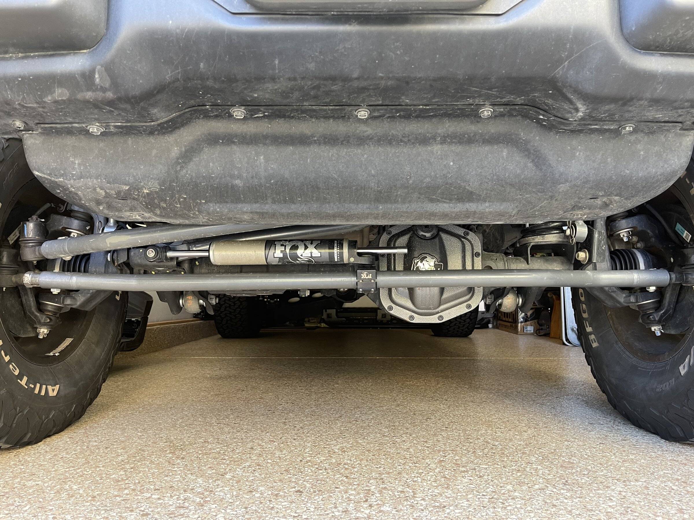

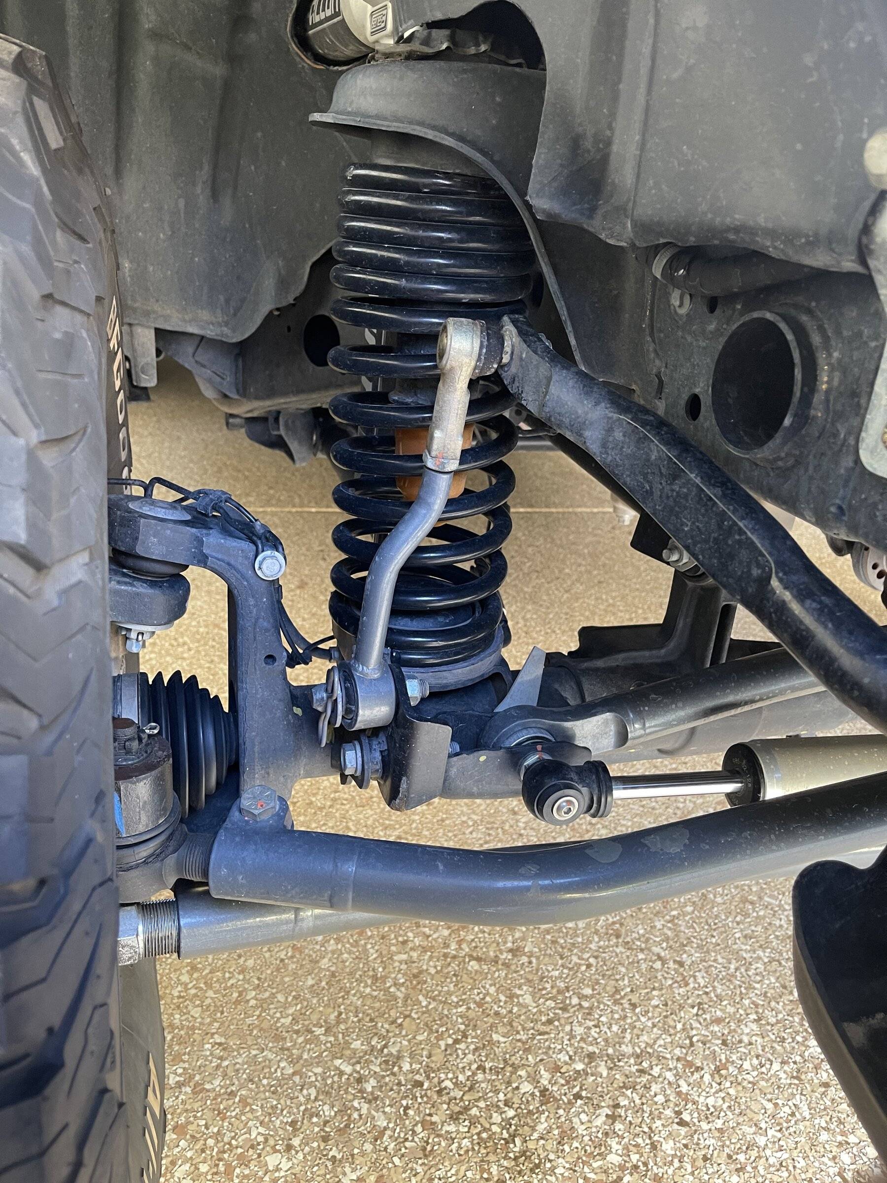

So I got this shaking, still controllable not full on 100% death wobble when doing emergency stop at highway speed. The vehicle slow down normal but when around 30-40 mph the front end starts to shake..
any ideas? Vehicle only got 15000 miles, alignment is good, tire just road force rebalanced and no shimmy. All new synergy track bar, tie rod,drag link, all torque to spec..
im running out of ideas, help me. I will buy you steak dinner if you can help me find the culprit..

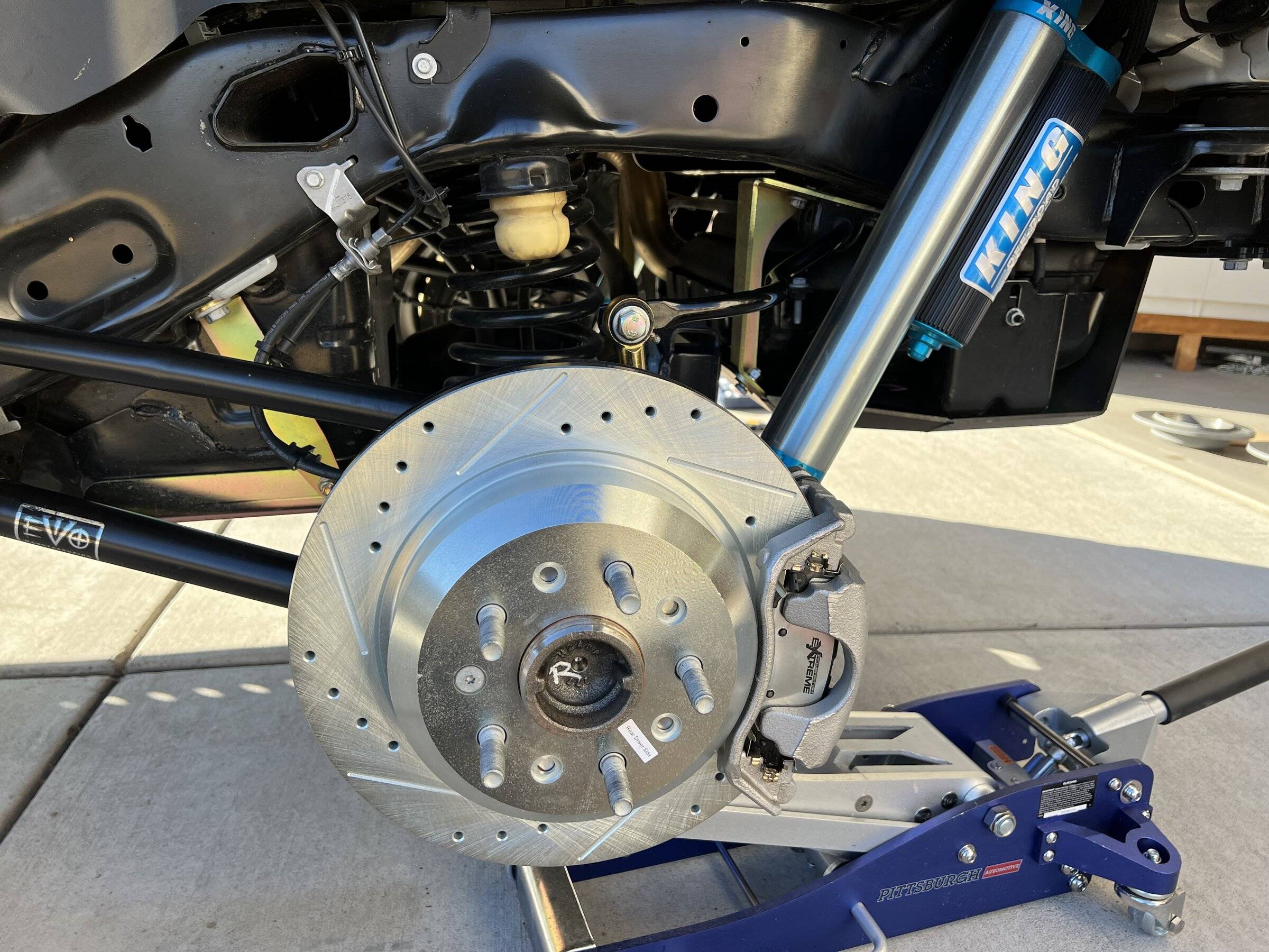

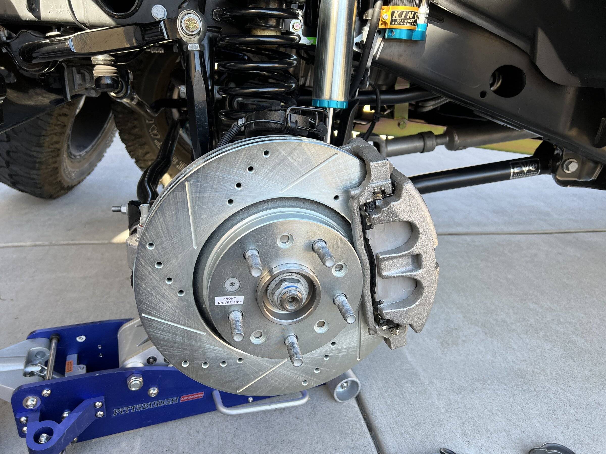

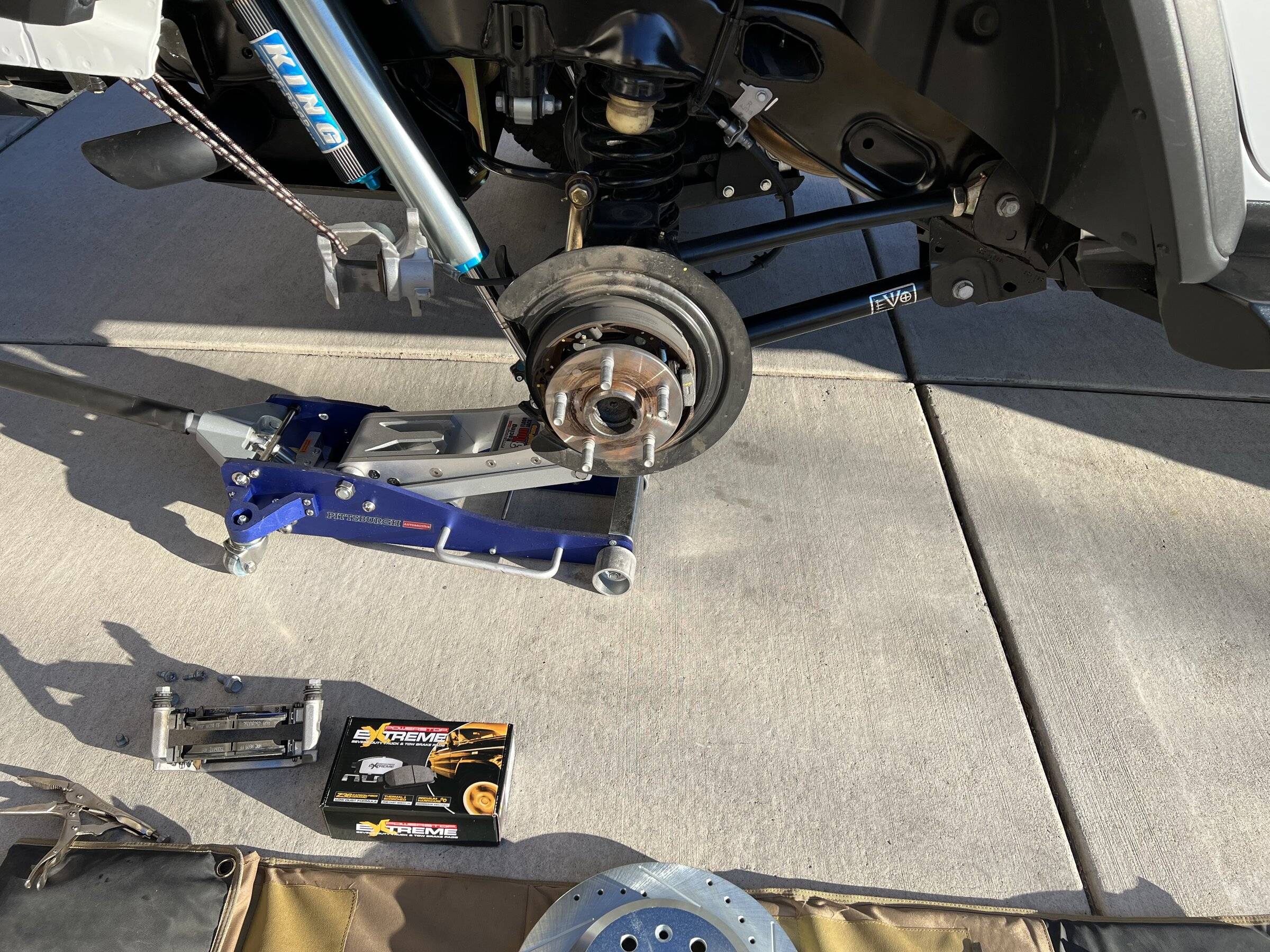

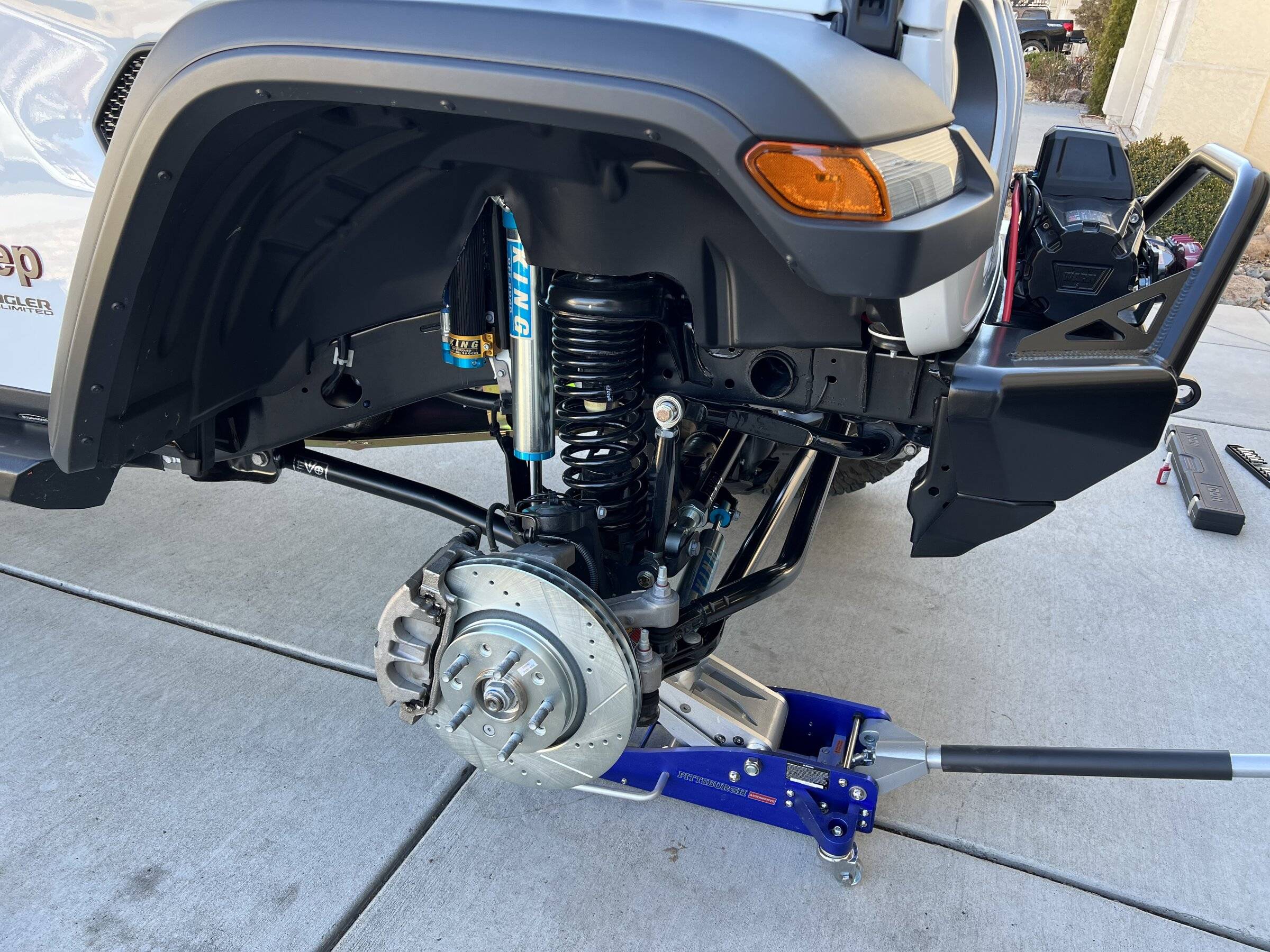

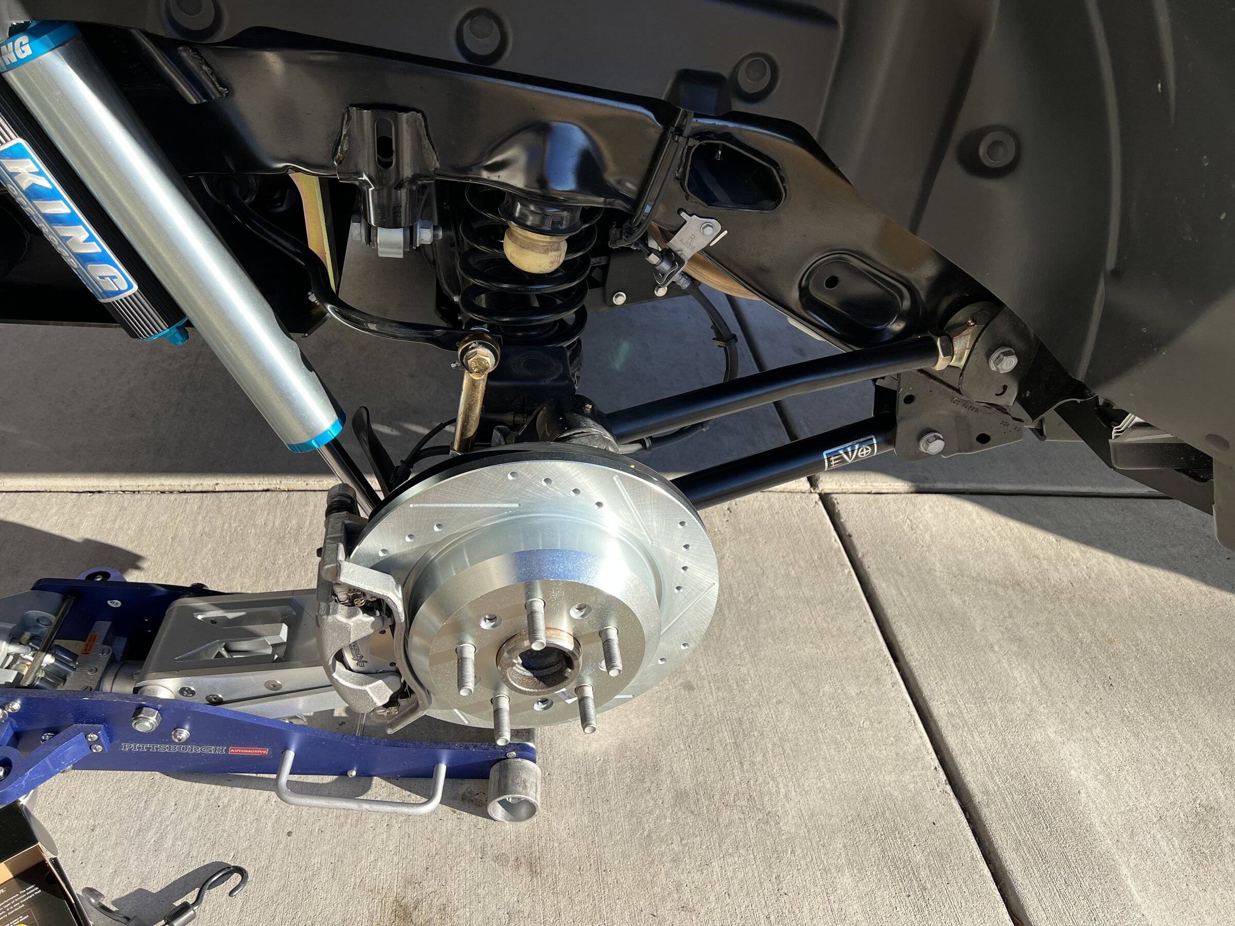

DW only while braking? Try upgrading to the power stop break kit. Here is pics of mine I did a month ago. Braking is so much better now, the rotor is drilled and slotted for better cooling during braking.

Did it happen when you brake hard on an uneven surface? Was the steering wheel pulling hard left-to-right? Could it be bump steer?
My Sahara developed bump steer after it got a Mopar lift and 35s.
I eliminated most of it by swapping the OE steering stabilizer with a much beefier Fox 2.0 strut.
