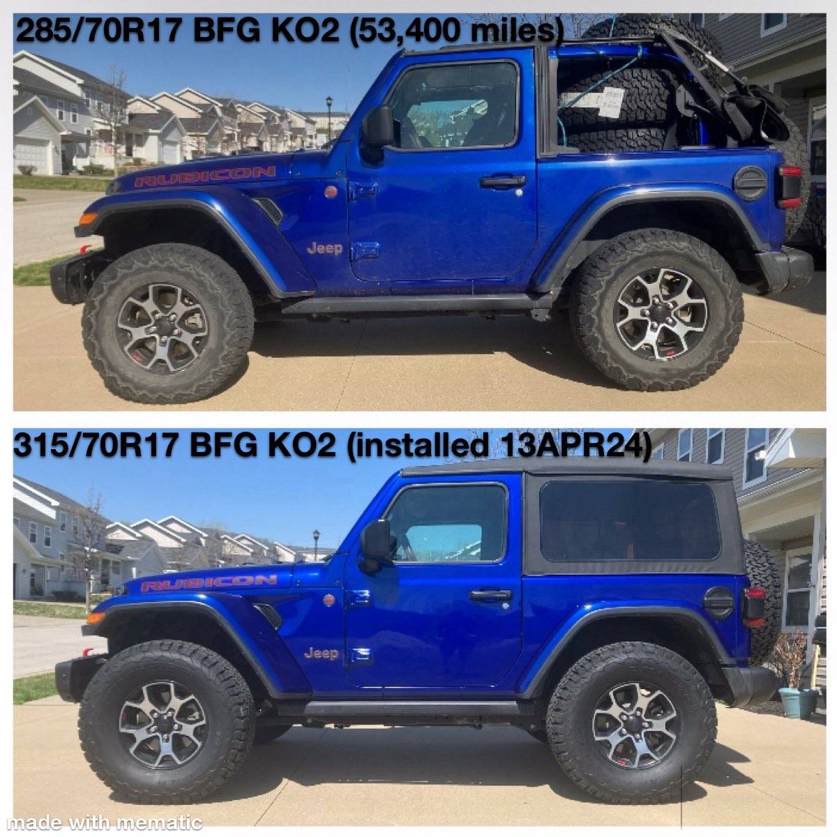

Okay, final update until the next time DW rears its ugly head :CWL:
The ball joints did solve the DW. Once they were installed I never experienced it again, even after a 2600 mile road trip to Florida. But I could tell the tires were shot, overused (53,400 miles), out of balance, or a combination of all this. The jeep had a weird shake to it. I could just tell something was off.
It was time for new tires anyway so I had these KOs installed. Talk about a night and day difference! It now drives SO much better. It's firm, confident, tracks perfectly straight. LOVE IT!!!
All the mods:
-Mopar LCAs
-Dynatrac Ball Joints
-Yeti track bar
-BFG KO2 315/70R17s
That's pretty much it.
