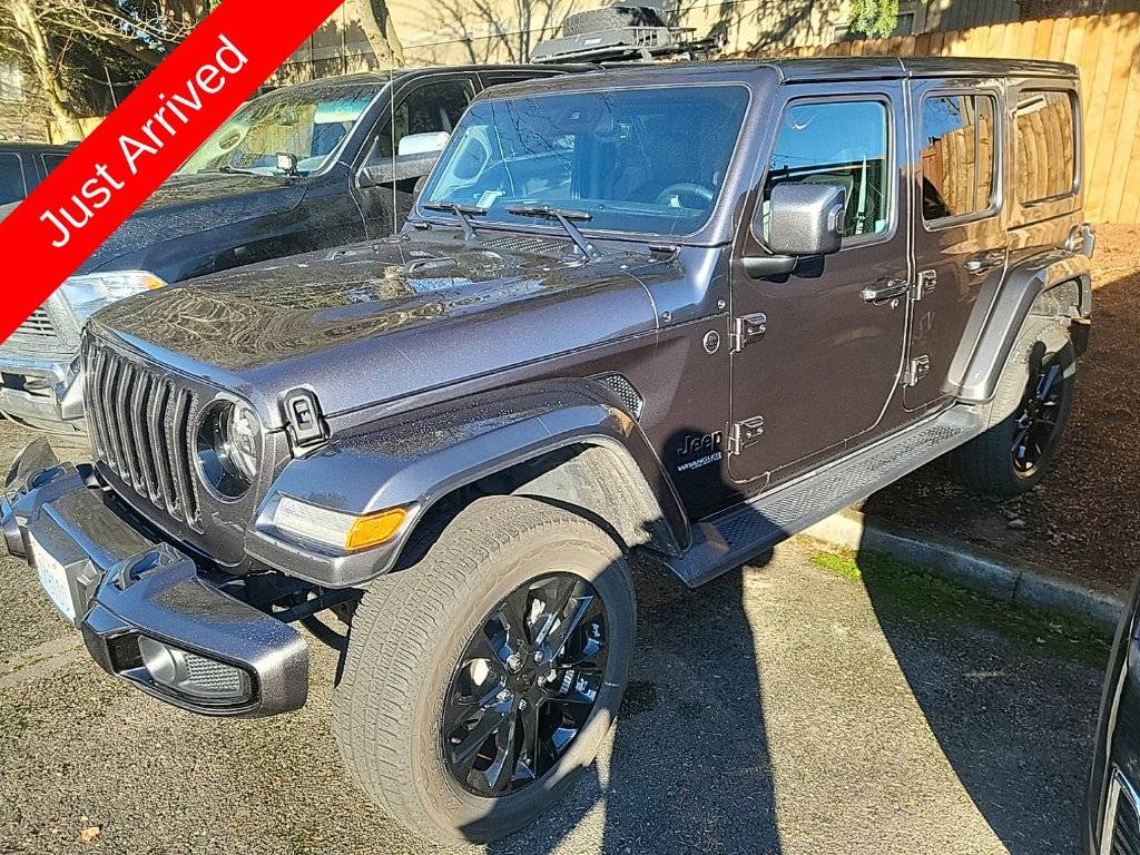

A couple weeks ago I test drove a 2024 Sahara 4Xe and really liked it.
I started a thread on the 4Xe section of the forum and got lots of responses, but was surprised that while one half loved their 4Xe, the other half HATED it. Common problems were never-ending electrical issues, sometimes catastrophic; incompetent dealers, etc. So I decided to move on.
But I just can't help myself. I found a 2021 High Altitude EcoDiesel with low miles priced well.
The CarFax shows a clean record other than an open Fuel Pump Recall.
Questions for those who own an EcoDiesel:
  1. What has been your ownership experience like? Have you had issues? Would you do it all over again?
  2. How difficult/critical is the Fuel Pump recall? https://www.chrysler.com/universal/webselfservice/pdf/Z96.pdf
  3. The CarFax shows a number of unspecified dealer visits after 3,000 miles (oil change): at 3,500 miles and 4,728 miles. The vehicle now has 13,600 miles. Are these red flags that something is amiss the vehicle...?
  4. Anything else you guys think I should know about?
Thanks in advance!

Yes, I have checked: it has NOT been done.
The Jeep is sitting at a Cadillac-GMC dealership as we speak.

As usual, excellent write up, @Tredsdert! Your post tells me EVERYTHING I needed to know.
EcoDiesel is evidently NOT the engine for me.
Let’s be real, I wouldn’t drive the thing enough. And the amount of care the engine needs would be overkill for my use.
You are right, the CarFax has too many unanswered questions for a vehicle with such a finicky engine: too many dealer visits in too few miles, for too low a price. Things just don’t add up....
If the Jeep was closer I’d take a look, but it is 250 miles away.
I’ll move on.
THANKS ALL...!
