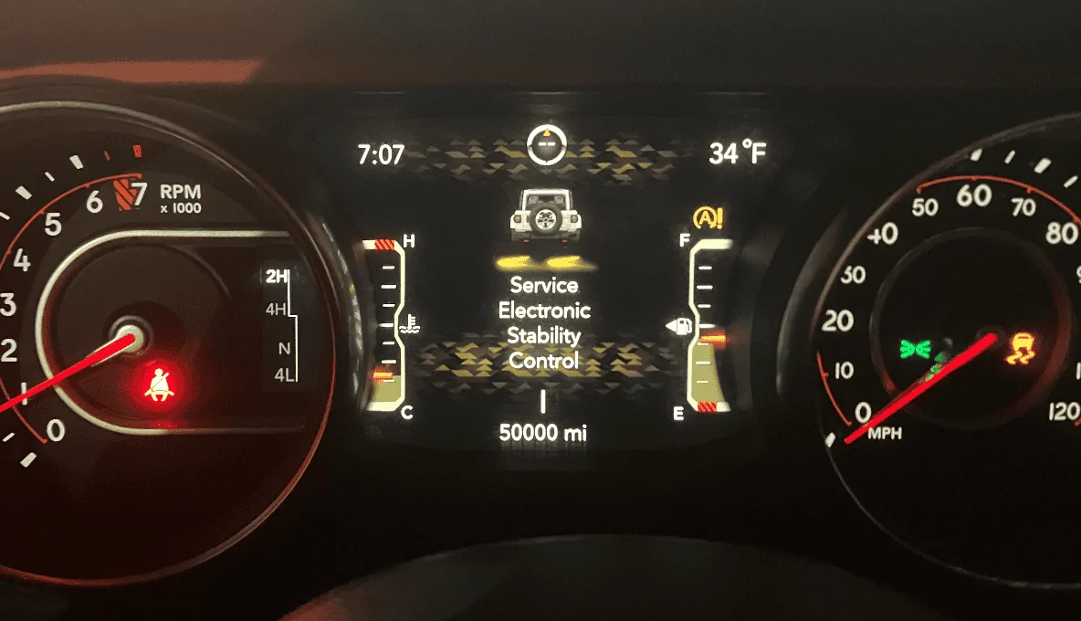

Jeep Wrangler JL DW experts... ASSEMBLE! Screenshot 2024-02-15 at 08.05.36
Today I plan to rotate the tires, triple check that they're inflated at 32 PSI, and adjust the Track Bar to hopefully correct the steering.
Can anyone break it down for me Barney style - if I have to hold the steering wheel at 11 o'clock, in other words, at normal 12 o'clock it drifts to the right, should I shorten or lengthen the track bar?
I decided to buy and install the track bar somewhat on a whim. I intend to keep this jeep for a LONG time and want it to be overbuilt for the 35's I plan to throw on it. I don't plan on lifting it in the future at all. Just keeping it a basic Rubicon with slightly larger tires than normal.
Does anyone recommend any additional components to beef it up? Maybe a new tie rod and drag link? If so, what brand?

Jeep Wrangler JL DW experts... ASSEMBLE! Screenshot 2024-02-15 at 08.12.46

You need to adjust your steering wheel with the drag link. The light is on cause you have the wheel turned to the left and you're driving straight. So the Jeep thinks you are having a serious case of understeer. Definitely get the Dynatrac HD Ball joints. I just installed them, and they are awesome.
Thanks for the reply! I did exactly that, it took maybe 20 minutes total including two test drives and sure enough, the steering is perfect again! (well, perfect for a jeep. tracking straight and with a minimal dead spot).
