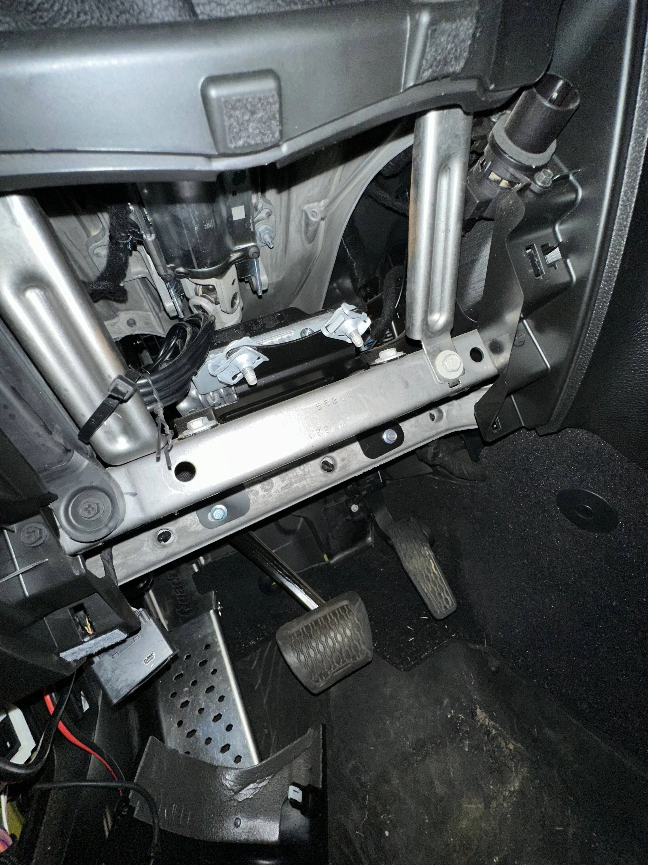

I went to install my ham radio last night (Icom ID5100A) and wanted to follow @Captain Skip 's approach putting it behind the knee panel under the steering wheel. See photos from his install:
https://www.jlwranglerforums.com/fo...in-jl-this-weekend-warning-photo-heavy.94341/

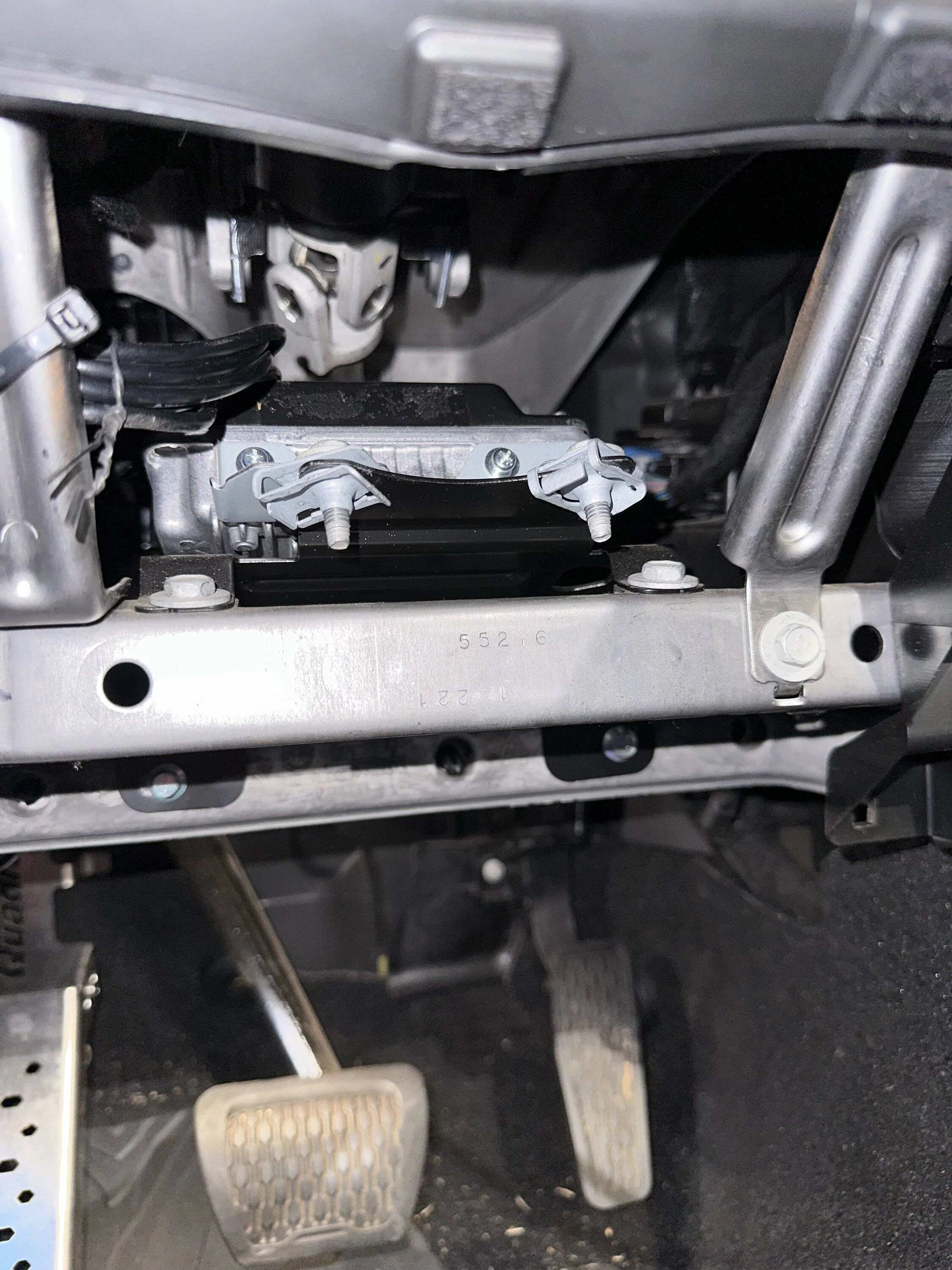

When I pulled the knee panel off, I was met with something already in that spot; no idea what it is. Anyone else encountered this device/piece of equipment before or have any idea what it is? (See photos below)
Any guidance would be helpful and appreciated.
My Jeep is a 2021 JLUR
Purchased late June 2021 from CDJR Fort Walton Beach
Base, no options Rubicon.
Photos (black coiled wire to the left is leftover from the VoSwitch):

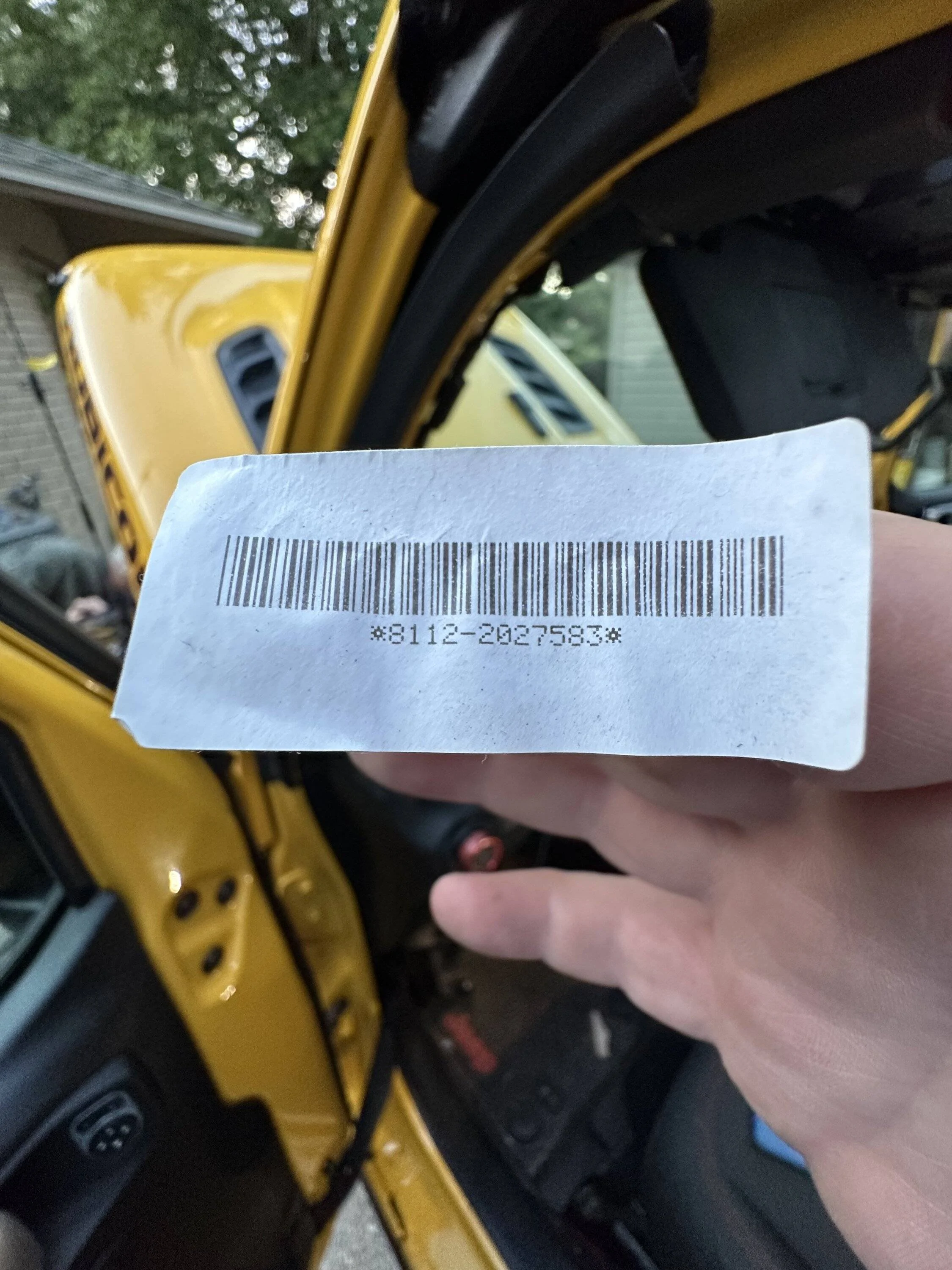

Sticker on top. I Googled the number; no hits.

I believe that is the power inverter for the 110 volt outlet. I see you don’t have heated seats as the heated seat module attaches to the underside of that bracket.

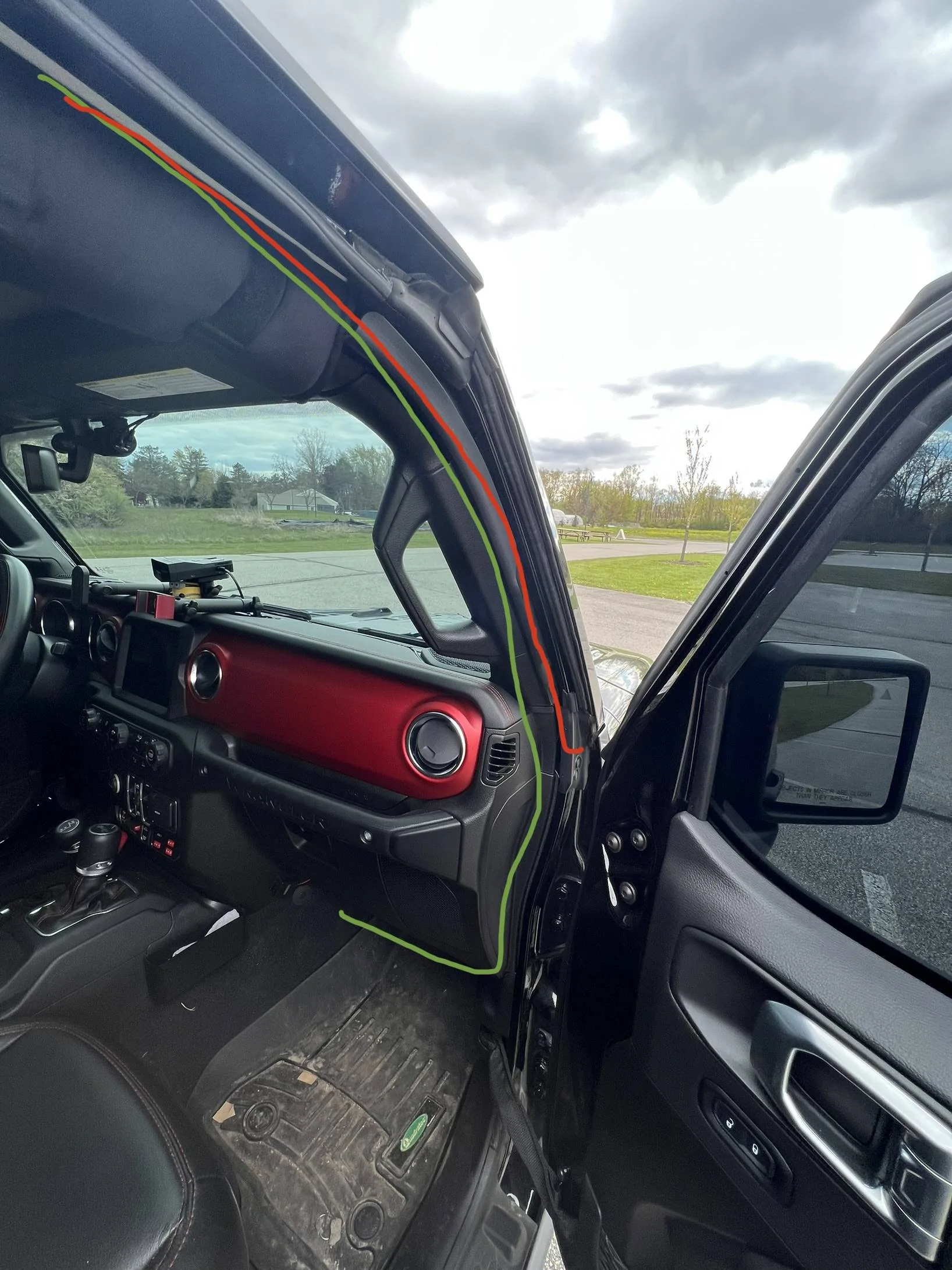

Where did you run your power and coax to get it overhead?

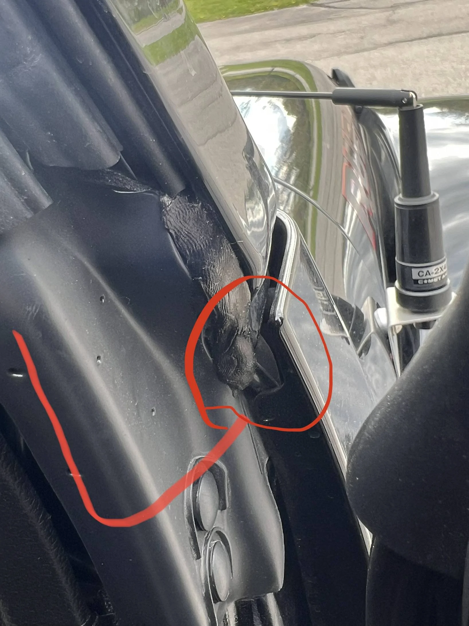

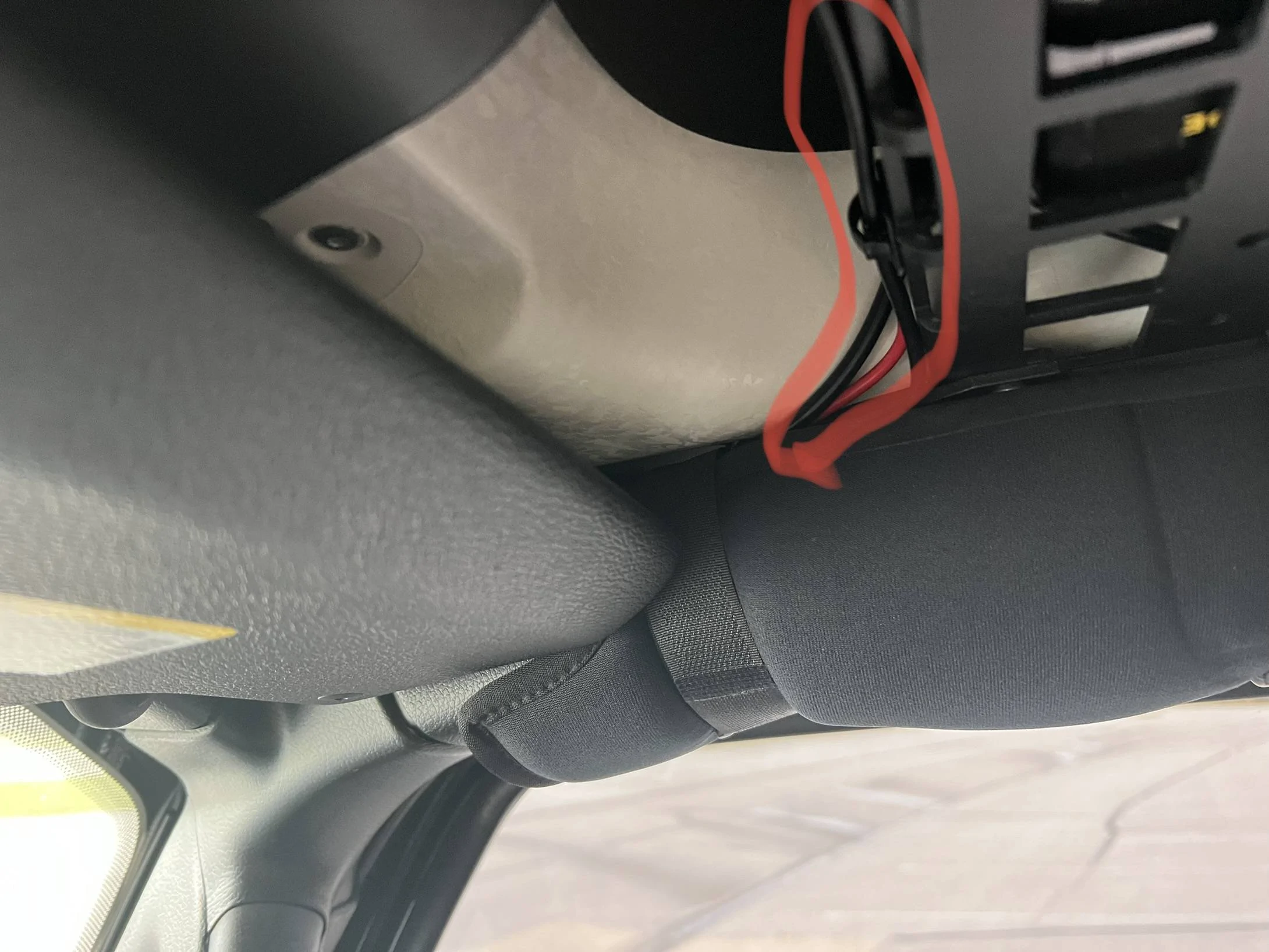

Power and coax both run along the edge of overhead MOLLE shelf, then down the A-pillar behind the plastic trim for a clean install.
Jeep Wrangler JL What is this?  Under steering wheel. A9AD0C92-C284-4ACD-941A-2E97B62F3FD0
Jeep Wrangler JL What is this?  Under steering wheel. 73CA4F8D-26D8-4376-914E-F5B8135BD618

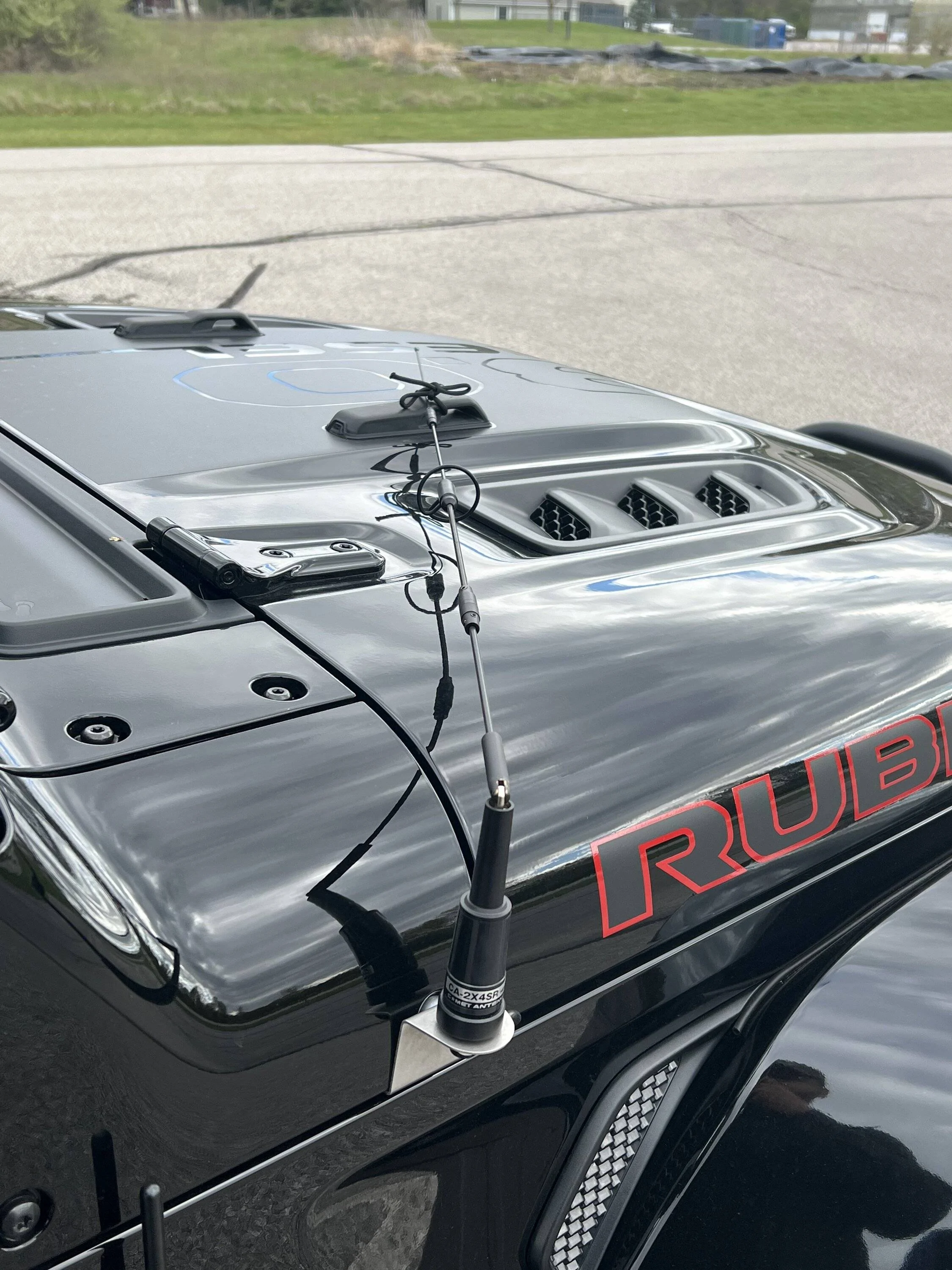

Power shown via green line, and coax red. Coax goes underneath rubber cowl/door seal, then leads to passenger-side cowl mount & antenna. In the next photo you’ll see the butyl tape I used to ensure the seal isn’t compromised
Jeep Wrangler JL What is this?  Under steering wheel. D44F0642-42A9-4061-936A-80680011AD0D
Jeep Wrangler JL What is this?  Under steering wheel. 77824435-D61B-4B1C-980C-1D65312FCDF0

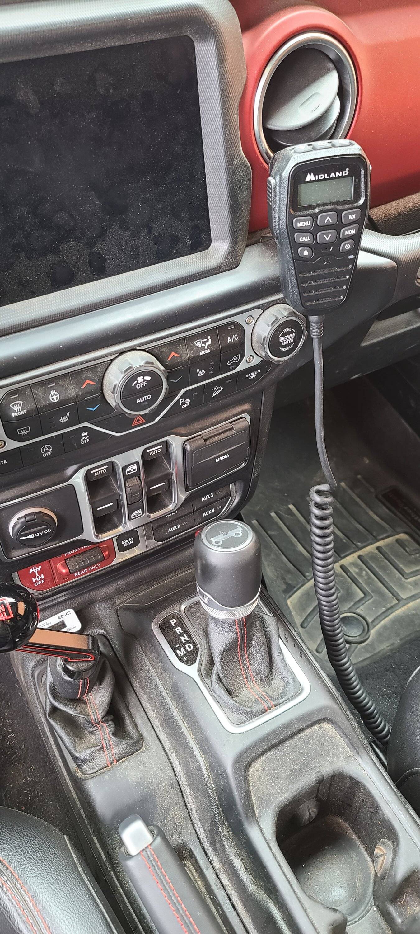

I put my mxt575 unit under the passenger seat. It allows the cord for the handheld to comfortably reach the left side of the passenger grab rail, without having to pull it tight to use. It also keeps the cord from having to cross over the center console or middle of the dash, so it doesn't interfere with the shift levers or locker buttons.
