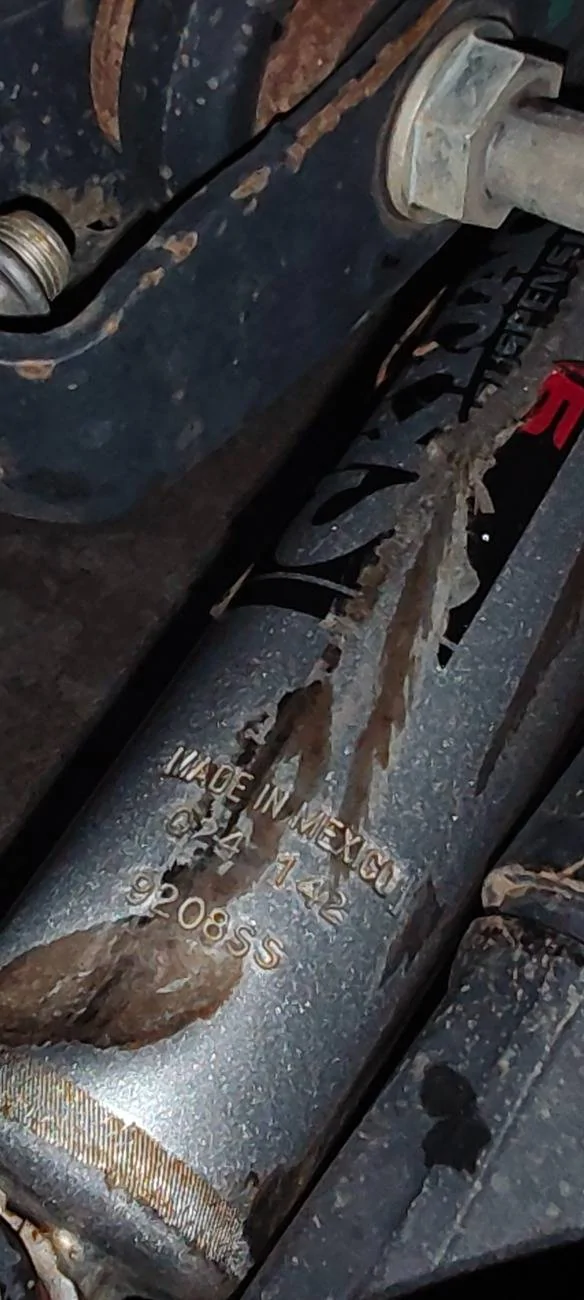

But after a few years I have a theory... which I'm sure many will disagree with: Larger profile tires act like a spring more than lower profiles. This springy-ness happens up/down in the direction of the suspension, and also side-to-side. Some of this motion is absorbed by the bushings and/or tires, but some is transferred to the steering linkage. This is what the steering stabilizer is trying to dampen... the tire oscillation, not the suspension/steering.
Edit: this kind of tire movement, but imagen a larger profile tire.

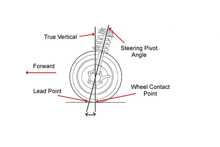

Another random thought I had was that higher caster could actually make the tire's oscillating mass have a greater effect on the steering. This is easiest to visualize if you consider that zero degrees of caster would result in no steering change when loaded side-to-side. Increase the caster and it increases the lever arm effect between the lead point & wheel contact point in the diagram below.
