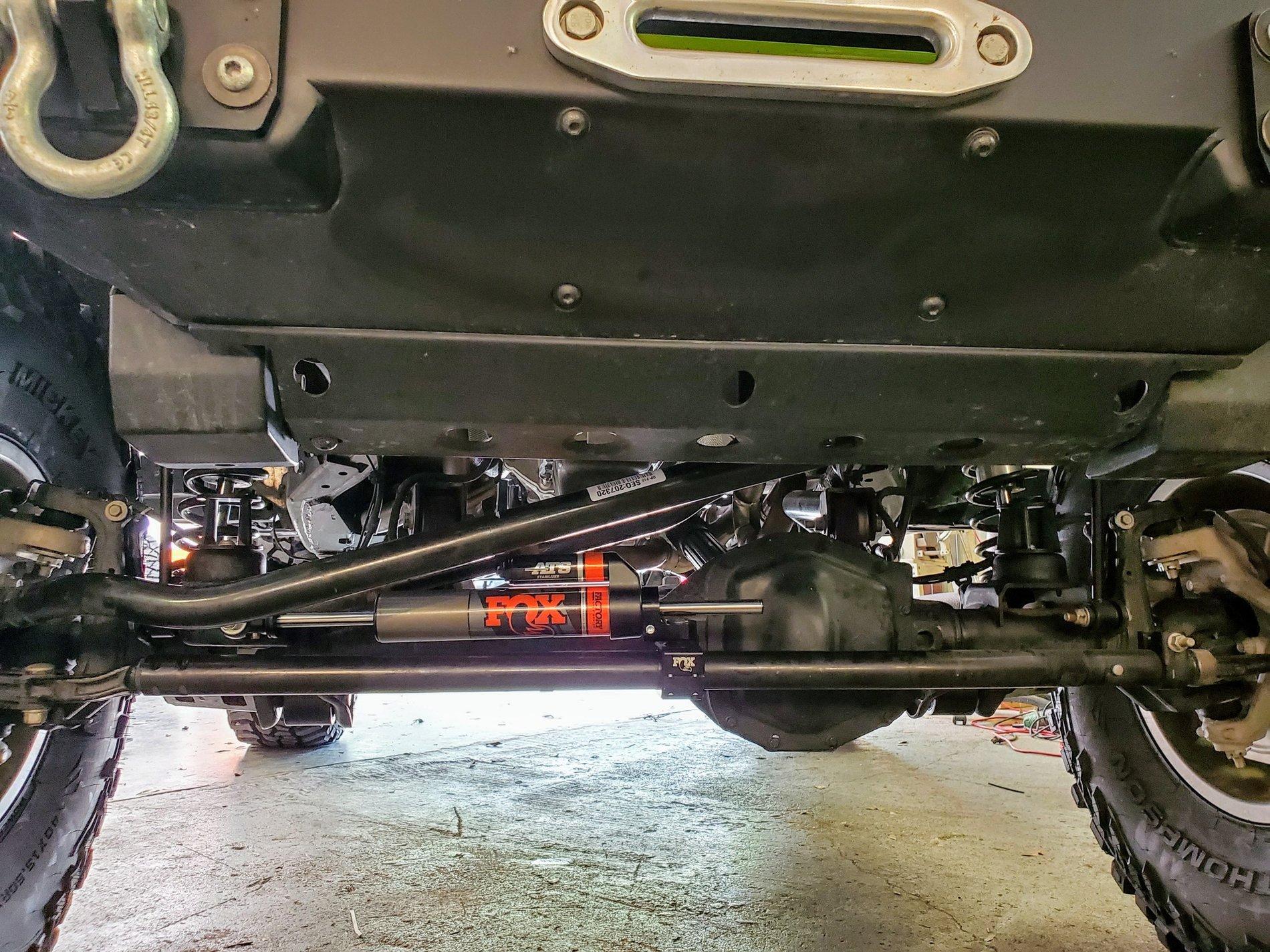

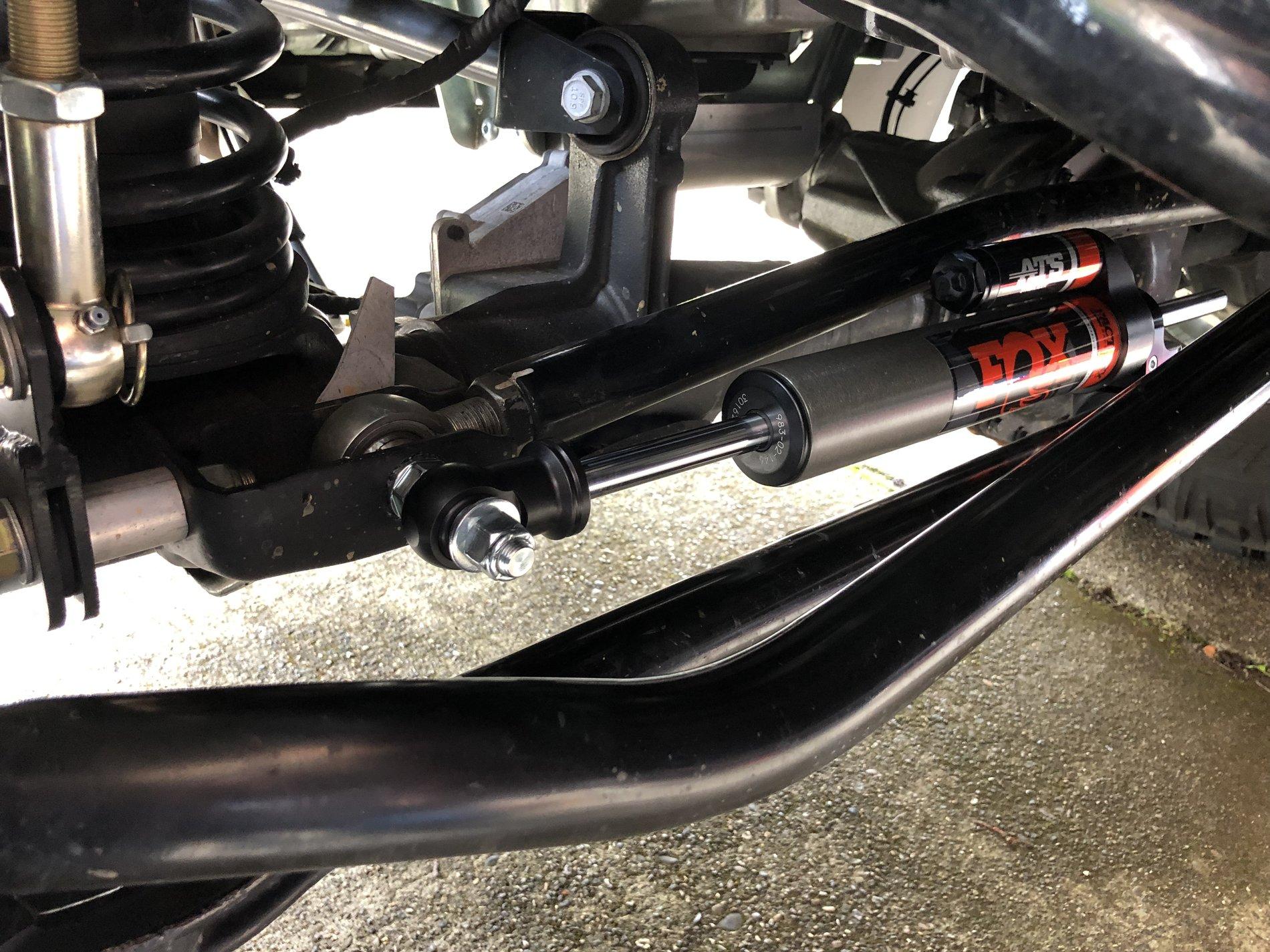

You can purchase the JK version with the 1-5/8 clamp. We didn't have issues on our 2dr JL with stock draglink/tie rod, but we run fairly tall bumpstops with the coilovers.

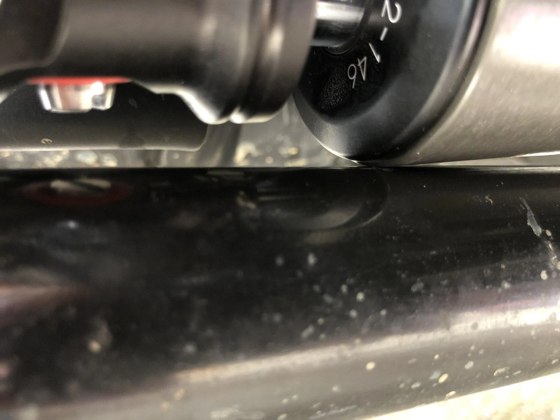

Stud mount didn't work for me. Hit's the tie rod at full-stop right turns. I'm modifying the Metalcloak bracket to raise it up.
That's strange, I wonder what's the difference between ours. We have it on both our 4dr and 2dr with no contact on the tie rod. I was a little concerned on the 2dr because we are running the draglink in the factory position, but no issues at rest or flexing.

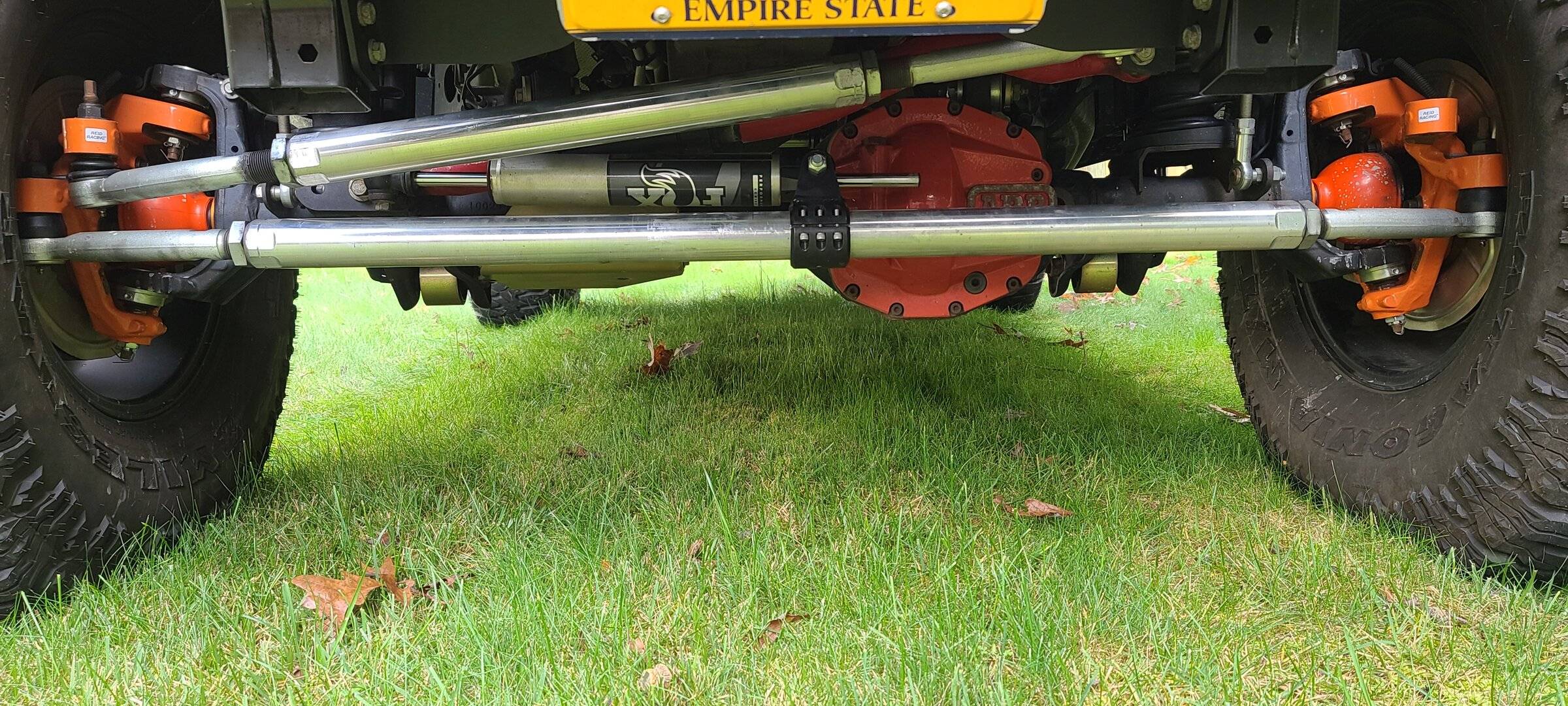

I also had no interest in adjustability, so I chose the Fox TS. I'm still waiting for it to show up along with the full Yeti steering kit, so I don't yet have any hands on experience.
Yeah I've talked to several people that have no issues. Guess I'm just lucky.
What did you do to correct the SS from making contact on the tie rod bar? I am having the same issue and don’t know what relocation bracket to use!
I've had zero issues using the SteerSmarts axle side mount with both the SteerSmarts steering linkages and my current RPM setup. My Fox TS stabilizer clears the tie rod lock to lock.
It’s been a while, but I used the Metalcloak axle bracket and had to modify it slightly. I think I had to enlarge one of the holes and add another. Works great, no rubbing.
