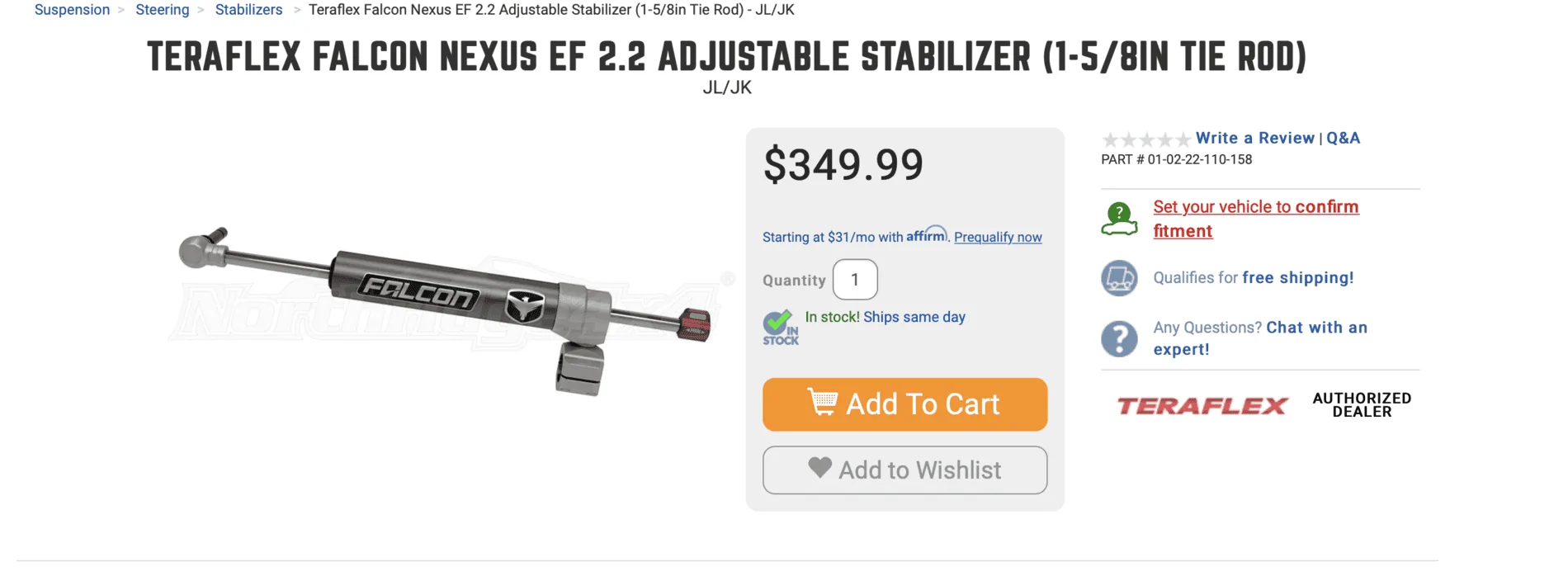

Wondering if all I need is this. And I'm assuming the bolt goes through track bar mount not he axle side? In other words I'd hate to have to buy a 70$ bracket + new Stabilizer when I could just get a stabilizer that works with what I'll already have going with steersmarts.

I don’t think that TB side bolt works. I can’t remember though. I want to say that someone used the one you referenced, even though it’s a JK damper....I think they needed a TB relocate bracket for it. If you want the Nexus, you can either use the JL one or get the JL and mount it to your new tie rod. Difference is if you want I lower or higher.

Based on this post, http://www.northridgenation.com/falcon-stabilizer-steer-smarts-tie-rod-jeep-jl/ , that stabilizer should work. Northridge sells it as a package with the steer smart tie rod.
