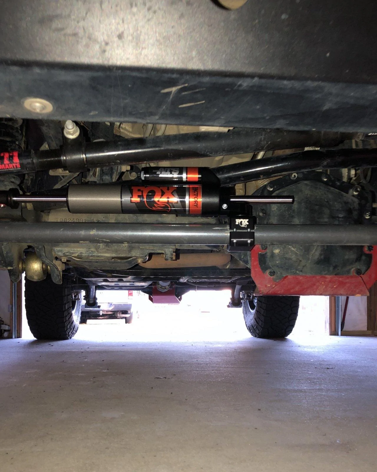

Fox thru shaft for me, there’s more settings on it than needed for most rigs, but it’s been rock solid , zero issues.
Rocky what adjustable front track bar are you running? I have a Teraflex HD adjustable front track bar and it is hitting the Fox steering stabilizer at full passenger turn. Drag link & tie rod are Synergy.
Roky
Roky
Oct 4, 2018
10,724
29,514
I am running RK track bar.
