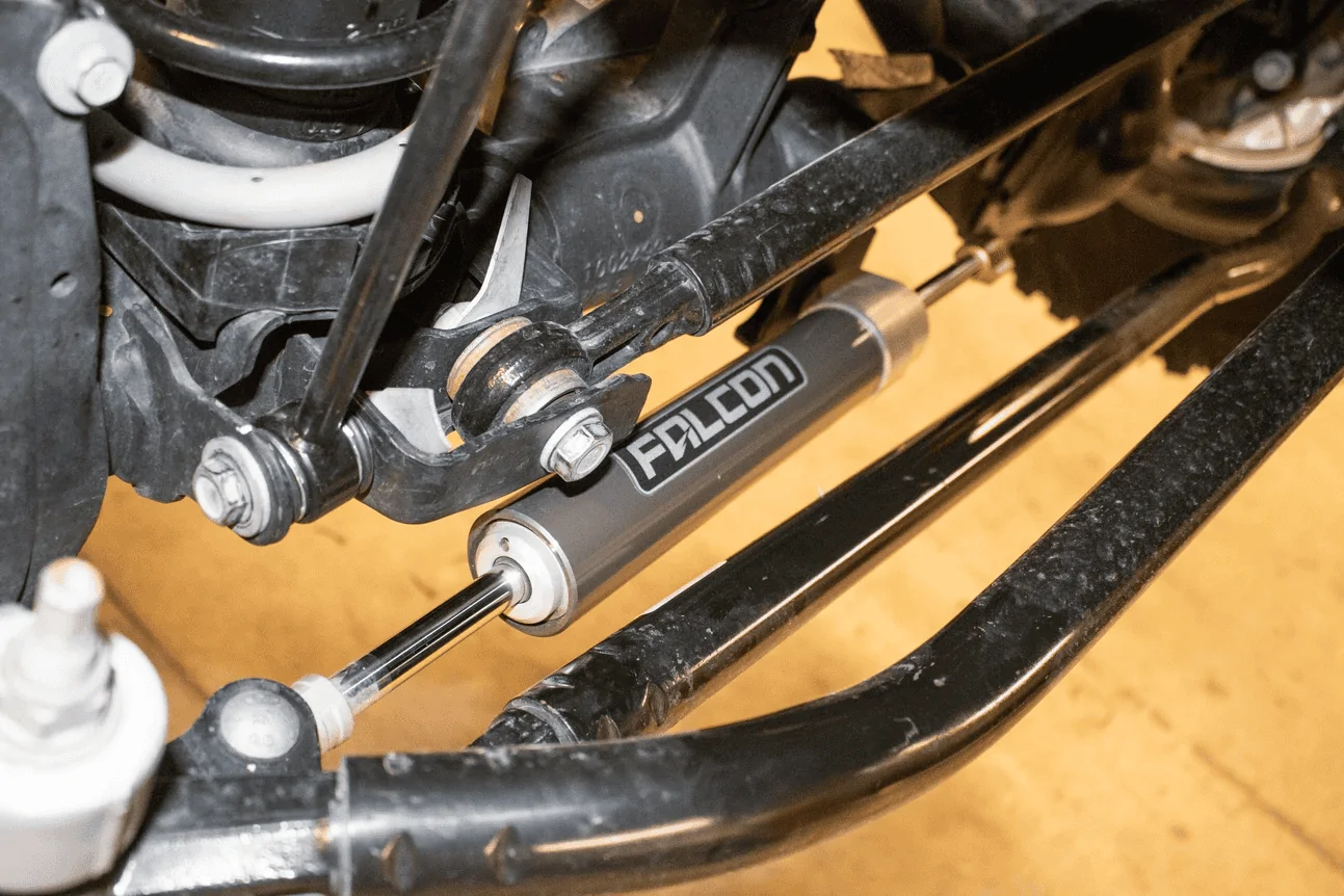

I have the Teraflex 2.5 inch lift on my JL, and have been fortunate ebough to never have death wobble. My caster is at 6°, and I ran for eight months with the stock SS without issue. When the Falcon Nexus 2.2 was finally delivered and subsequently installed, I noticed an immediate decrease in bump steer. Much more pleasurable on trails and potholes. The upgraded SS in my opinion is a "want" and not a "need." Happy I have it.
