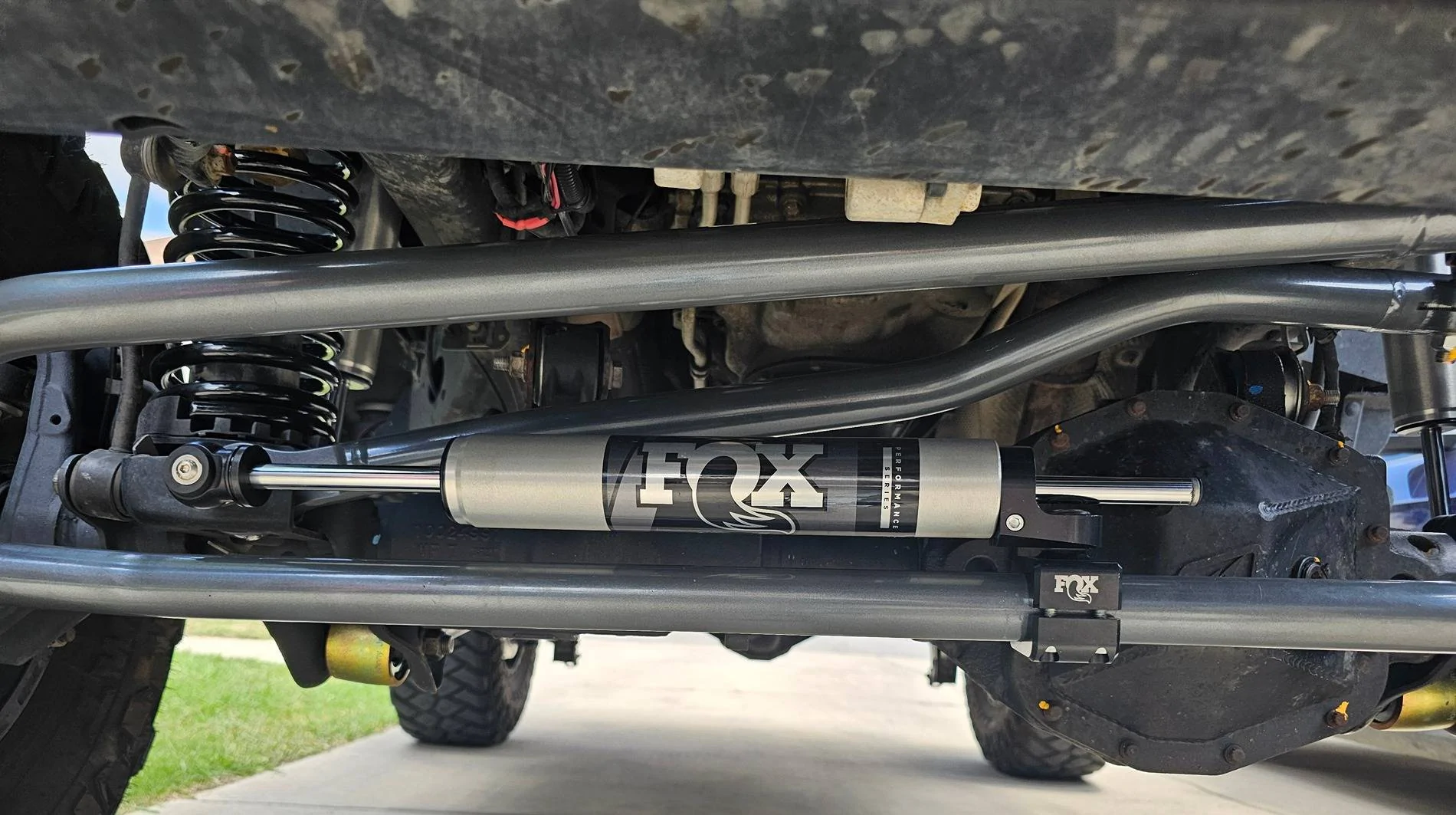

Jeep Wrangler JL I think i need a new steering stabilizer... 1000009465
Maybe a bit more than you planned to spend, buy I've had no issues. This one is new & shiny only because it was replaced after an accident.

Soooo I actually just made the purchase, and that's exactly what I went with =)
It didn't come with the relocation bracket, so I got the synergy one.
