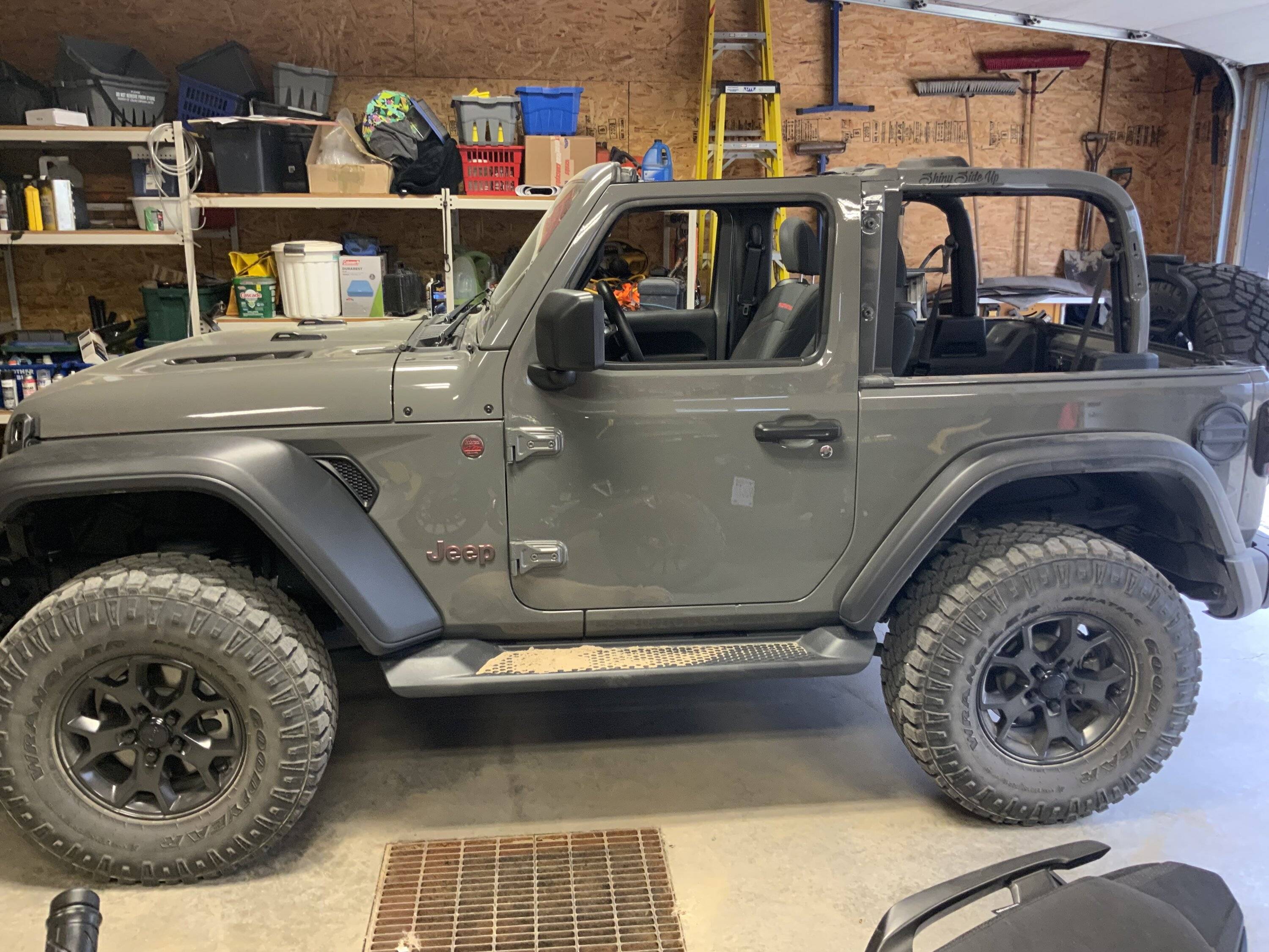

I have a 2020 2 door Rubicon with dealer installed BDS 3.5” lift. I went up to 35” tires on stock Rubicon rims. All in all the steering is pretty good. Not as good as my stock TJ on stock sized tires but pretty good.. No death wobble ever so let’s clear that up right away!
I have read articles supporting nitrogen shocks saying they are better at radial steer correction and I have read articles that say hydraulic are better as they are not always pushing out the piston. Also, what are the pros and cons of a dual setup vs only 1 shock.
I will NOT be going to bigger tires ever. No radical rock crawling. Not going anywhere that needs a winch. Alot of winding mountain trails mostly. It’s also my mostly daily driver.
Looks to see what you guys recommend
