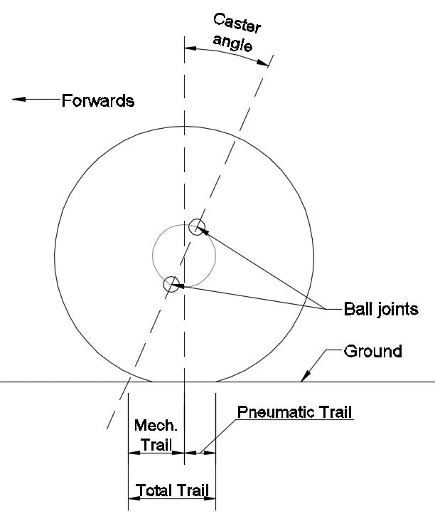

But yeah... the axle is the handle, and the tires are the weights. Steering only gets involved because the caster is not zero*, and the weights/tires force the linkage back & forth. This is where the stabilizer comes in. Any worn/loose parts just allow a greater difference between the tie-rod & axle, eventually overwhelming the stabilizer.
*Actually even if the caster was zero, there's still the pneumatic trail.

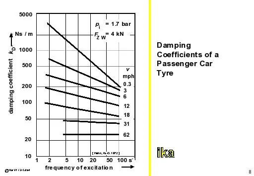

Tire sidewall is a damper; the lower the sidewall profile, the less damping done by the tires.
I guess so... I found this which shows the tire dampening changes with speed. I assume this is only studied in vertical directions and not horizontal.
Jeep Wrangler JL DO I NEED A STEERING STABILIZER? img7
Tyre damping tests at different rolling speeds have shown that damping decreases at an increasing speed. At increasing speeds, the effect that lowers the flexing resistance is superimposed by an opposite effect: the deflection of the tyre rolling under load in the contact patch causes the tyre circumference to vibrate beyond the contact patch as a result of forces of inertia that increase with speed. The damping of this vibration produces heat which results in an increased flexing resistance.
