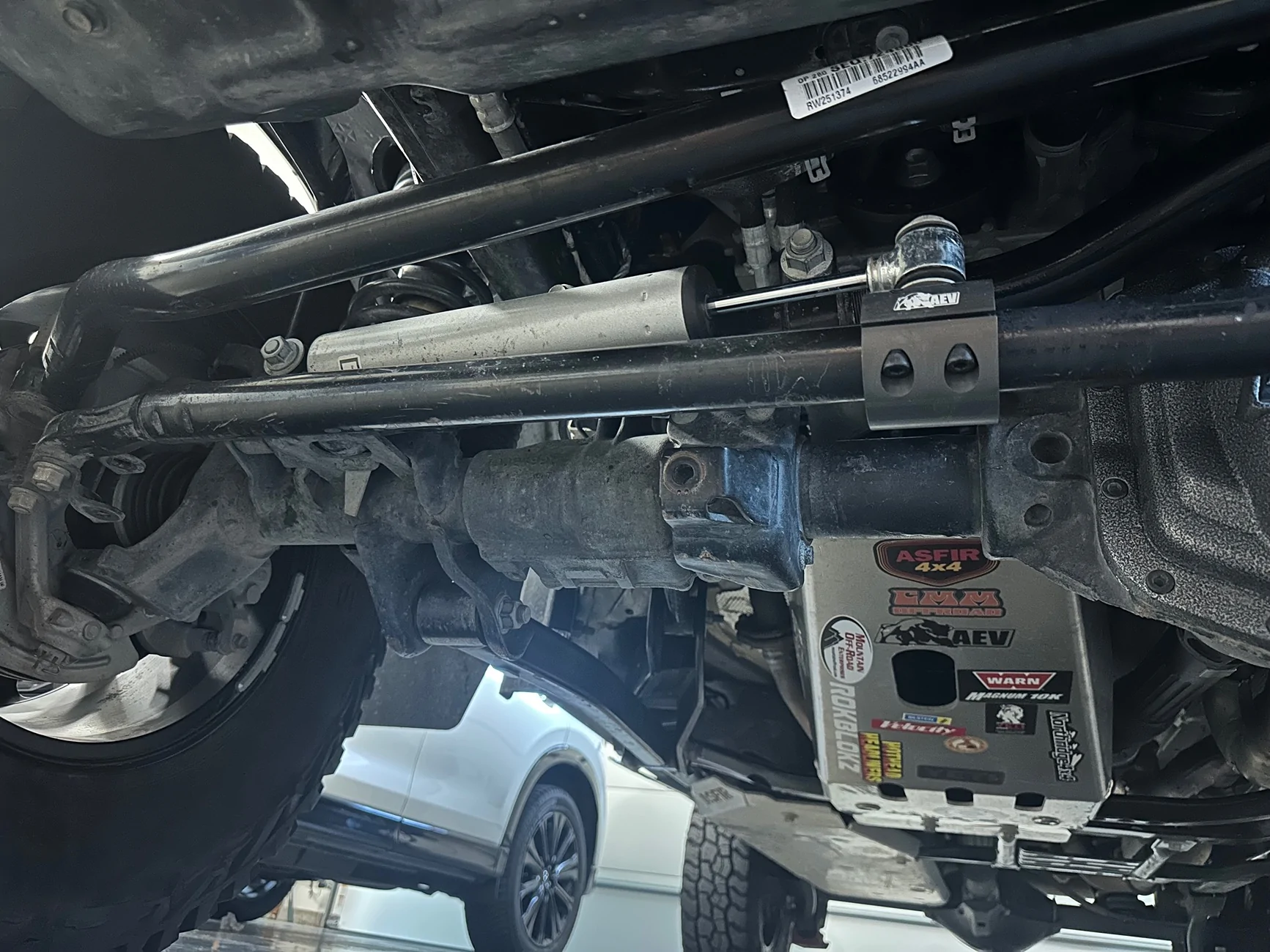

I would say likely not, I just installed the AEV Bilstein with a relocation bracket, I do notice less play, however, there is more variety of straight depending on the crowning and slope of the road. A non-through shaft SS will likely push the center of the wheel off because it it artificially pushing the wheel to one direction and getting it perfectly center is near impossible. Likely if you are experiencing a lot of play in the wheel, something else is the issue, a 3" lift with stock control arms is causing a low caster angle, which will give some play and issues with tracking straight. Alternatively its possible a ball joint is warn and needs to be replaced in which case death wobble will probably start. In my experience a new steering stabilizer may prevent excessive steering wheel movement going over minor bumps however nothing will prevent the wheel from moving over major bumps.

I recently installed a Clayton 3.5 with 37's and noticed a big difference in the steering wobble on bumps and curved on-ramps. I upgraded the to Fox 2.0 and it definitely feels more stable and planted. Its only about $230 and should be a direct replacement for you.
I'd say give it a shot - it likely won't be the worst $200 mistake you can make on a Jeep.

I have an AEV (bilstein) and while I had no issues prior to installing it I feel no difference between oem and the AEV. AEV looks sweet tho :) and I have wasted money on less....
