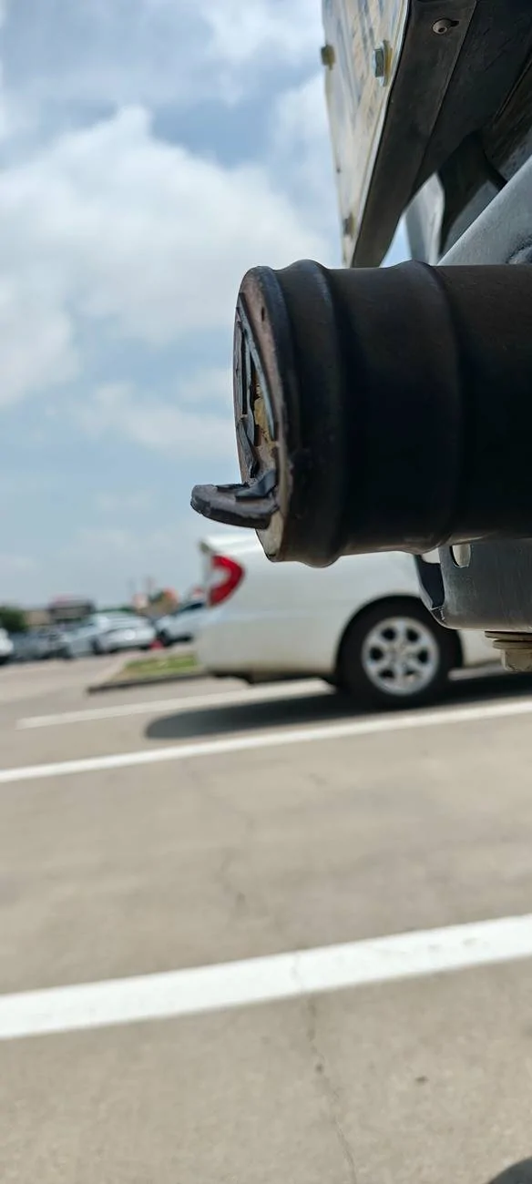

I actually don't know how I damaged my steering stabilizer. Well I kind of do. It was a crappy aluminum bracket from synergy. Basically I had a grade 8 steel bolt in the bracket on the tie rod and it literally yanked itself out. So the bolt is still usable, but the tie rod mounting bracket isn't. That thing is shredded.
Any damage to the steering stabilizer itself was due to being dragged on rocks after it worked itself loose from the coupling.

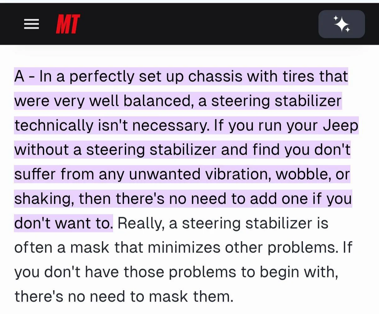

I guess this is one of those things where you don't really get it until you try it.
There's nothing in this world as valuable as first-hand experience!
Realistically speaking if more people on here try running without their steering stabilizer and then posted their experience, we might get a better picture of whether what I'm saying is across the board or just my scenario.
Not to shame y'all too much, but having an opinion is great and all, but it don't really help nobody! :LOL: ;)
Deleted User 38384
Aug 4, 2020
140
6,081
10,672
Like I posted before from my experience driving without one and then putting it back in when i got the mounting bracket finally in, my ride was much better, but as you said, you don't necessarily have to have it. I think it honestly would come down to what type of roads you drive on daily, especially if there are a lot of uneven surfaces or small to large potholes/railroad track crossings, etc. then you DEFINETLY would want the Stabilizer in.
As far as limiting full turn, I would think getting the type that has a longer stroke or that center shaft type would allow the full turn.
So if I want to get real here, I think part of the issue with my steering stabilizer relocation bracket is that my lift isn't really big enough to make it function the way it should. I think if I were to do it again I will use the Rough Country dual steering stabilizer. Not because it's any bit better, but because the way it mounts up it'll clear of all of the components that my synergy relocation bracket was super duper close to.
Plus because of the synergy steering stabilizer relocation bracket coupled with a skyjacker steering stabilizer, no matter where I moved the bracket on my tie rod it was limiting movement to the driver side which was the side that was pulling the Piston out, versus to the right which was pushing the Piston in. I'm terrible at describing things like this, but basically with a dual steering stabilizer I wouldn't have one side in this case the Piston moving out putting strain on the Piston itself, which is what I'm guessing the issue was getting my Jeep into full lock while turning left. With a dual piston setup I would imagine it would be less limiting, because both sides can pull in on the piston, and push out.. if that makes any sense to anyone beyond me.
Regardless for now I'm definitely going to run with no steering stabilizer for the next few months. And depending how I feel about it it might be a few years. If my opinion on this changes I'll definitely let you guys know.
But if you do want to get technical, the only reason the steering stabilizer is there is to prevent feedback into the steering wheel. Which if you want to get even more technical, your wheels are still going to do what they're going to do if they get away from you, the only difference is a steering stabilizer won't let you feel it at the steering wheel. So in reality a steering stabilizer is actually a luxury/comfort item. It has nothing to do with being a safe driver.
I mean your wheels are going to do what they're going to do when you hit a bump or pothole in the road, how your steering wheel reacts to it doesn't change your ability to keep driving forward. If you hit a bump in the road and your wheels hop up and turn left and your steering wheel is straight, what about that is safer? Your wheels still turned left whether you realize it or not. Probably not the greatest way to phrase this, but the steering stabilizer is basically bitch mode, it allows you to not feel the road so that you can live blissfully inept from what's actually happening to your suspension.. like I said not the greatest way to phrase it, but I would say 100% accurate as to what's actually happening.
