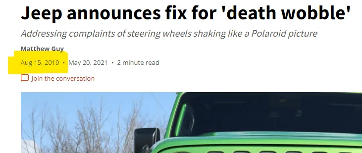

Yes, 2019.
but my death wobble only happened when it got cold outside.
when it warmed up to 50f it went away.
must stil be putting defective units in Hoping they live in Florida.

Yes, 2019.
Ok I thought I was insane.... I noted dw was only an issue when it was cool out. I might just have to swap dampers and see where I'm at.
