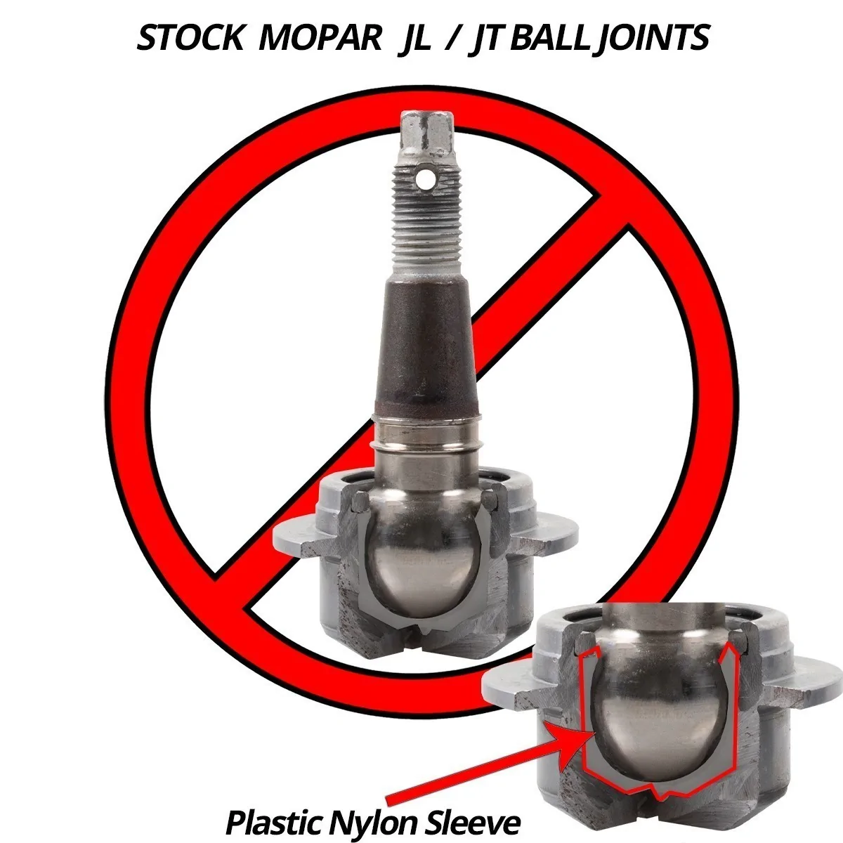

We’re not saying don’t replace the stabilizer. We’re saying don’t stop there.
Even at only 10k it very likely is a worn out part. In fact, i would bet a not insignificant amount of money that some of your ball joints are bad. The factory ball joint design is extremely poor for consistency and durability in a part with a huge amount of load on it, that is also constantly moving. The ball has a plastic cap over it that then goes into the cup. There’s no way to grease them and the plastic caps are really thin, so they wear out and break. Often times extremely early. I’ve seen 3 different jeeps that i can think of off the top of my head with ball joints that went bad under 12k in stock form, no off-roading. You’re an engineer, (not sure what kind, I’m an ME) so look at this design with your engineering hat on.
Jeep Wrangler JL Death Wobble 1770688046680-rf
Jeep Wrangler JL Death Wobble {filename}
Mine got changed at 15k and they were bad, not totally worn out yet, but it would not have been long.
