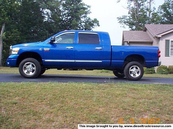

Same here, in a 2007.5 RAM 3500 MegaCab SRW though.
It was an earlier build with the “Y” style steering linkage. Running some 20x9 Ultra Grinders with LT305/60R20 Wrangler SR/A’s apparently was a bit too much for the steering linkage pieces, especially with the proverbial slight left hand turn whilst approaching a bridge.
I later replaced the steering linkage with the newer MoPar “T” style linkage, and never had any more issues with it.
