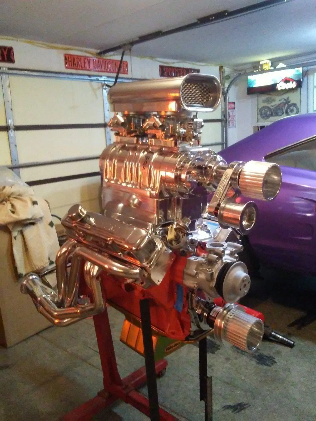

I'd love to see a dyno run for any of the usual mods such as cold air intake, cat back exhaust, etc. With the computer controlling everything I doubt there would be any increases in HP or torque that mattered much. To make any real change would require $$$$. Supercharger anyone?
Here's a few:
