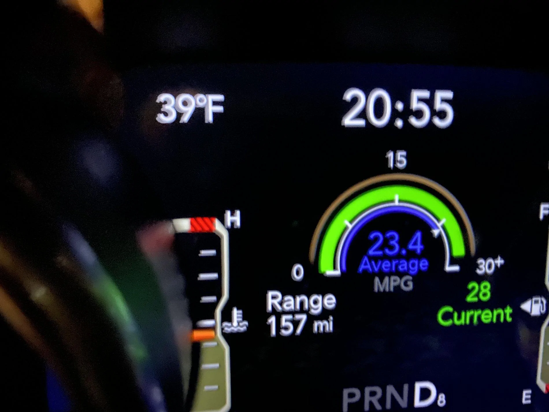

Intake, exhaust, tuning, and pedal input correction all make power and efficiency. Especially the tuning and pedal input correction. The intake and exhaust then allow you to manipulate short term fuel trims within the ecu’s closed loop operation and boost your efficiency considerably.
this is Mopar intake, AFE proguard 7 cone filter insert, AWE exhaust, Pulsar running 91oct tune, on 37 AT’s, stock 4.10 gears, 8spd from central VA to northern MD. Stock on stock 33” MT’s was average18.5-19 for this route on multiple attempts, with an all time high of 20.0. Tire size was calculated using the circumference method; speed was checked to be accurate to the mph up to interstate speeds by police radar and gps; and hand calc was within 5% of displayed.
