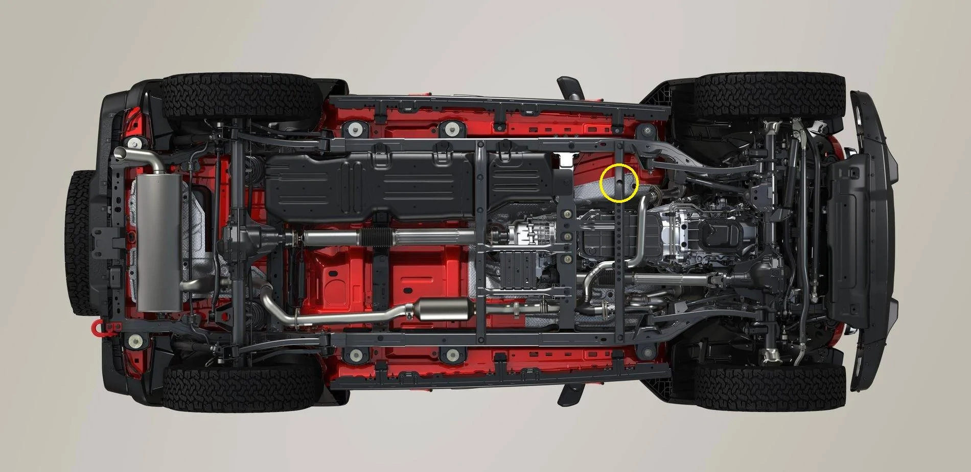

FYI: M.O.R.E.'s 2.0 engine skid plate is not compatible with the 2-door.
Rusty's doesn't claim 2-door compatibility either, probably has the same issues as the M.O.R.E.. I'd like to go with something that's steel, but this really just leaves Metalcloak's $1,539 skid (which is way too much IMO), Rockhard's $1,890 belly pan (LOL), or DV8's $400 belly pan... Did I miss any?
I also learned that the 2-door's gas tank skid mounts to the crossmember that gets usually gets removed on 2-door skid systems. Below is a 4-door, but the 2-door's gas tank skid bolts to the hole circled below:
