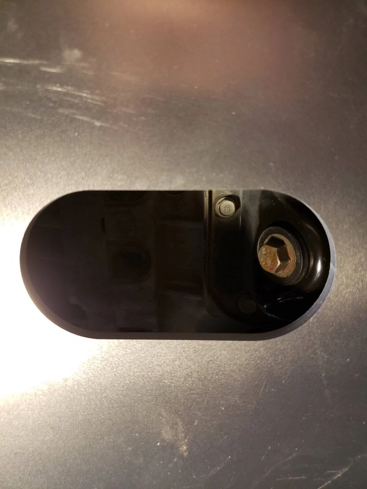

Someone mentioned wishing the hole to access the drain plug was larger on the Asfir because the stream of oil coming out initially wants to go above the skid making a mess. How much larger should the hole be you think? I can break out my carbide burrs and do just that.

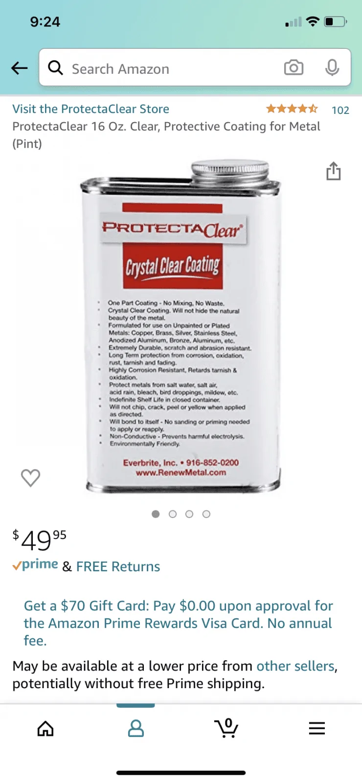

Don’t spray paint - I used this stuff on my Artec aluminum skids last summer before installing them. I painted on two very thin coats an hour apart. They still look brand new after winter of salty roads. I also used on the faded aluminum cladding on the windows of my 15 year old home. Made them look almost new. Everbrite is expensive but worth it....

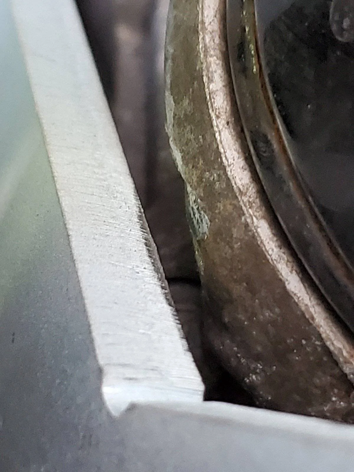

Anyone else noticing the brace hitting just above their oil filter? Getting ready for trails in a couple weeks and have not been able to locate a tapping when hitting pot holes. I think this is it.

Can you zoom out on it? That does not look good. Looks like it Hit/s rubs a lot and is chipping away the metal. What brand skid?
It's Asfir.
Sorry for late update. My RC diff skid bracket was kicking up the Asfir bracket tapping behind oil filter. Why RC made the bracket vertical instead of flat who knows. Tried grinding down bracket taking out about half inch and finally just removed that skid. Going different route with a diff cover.

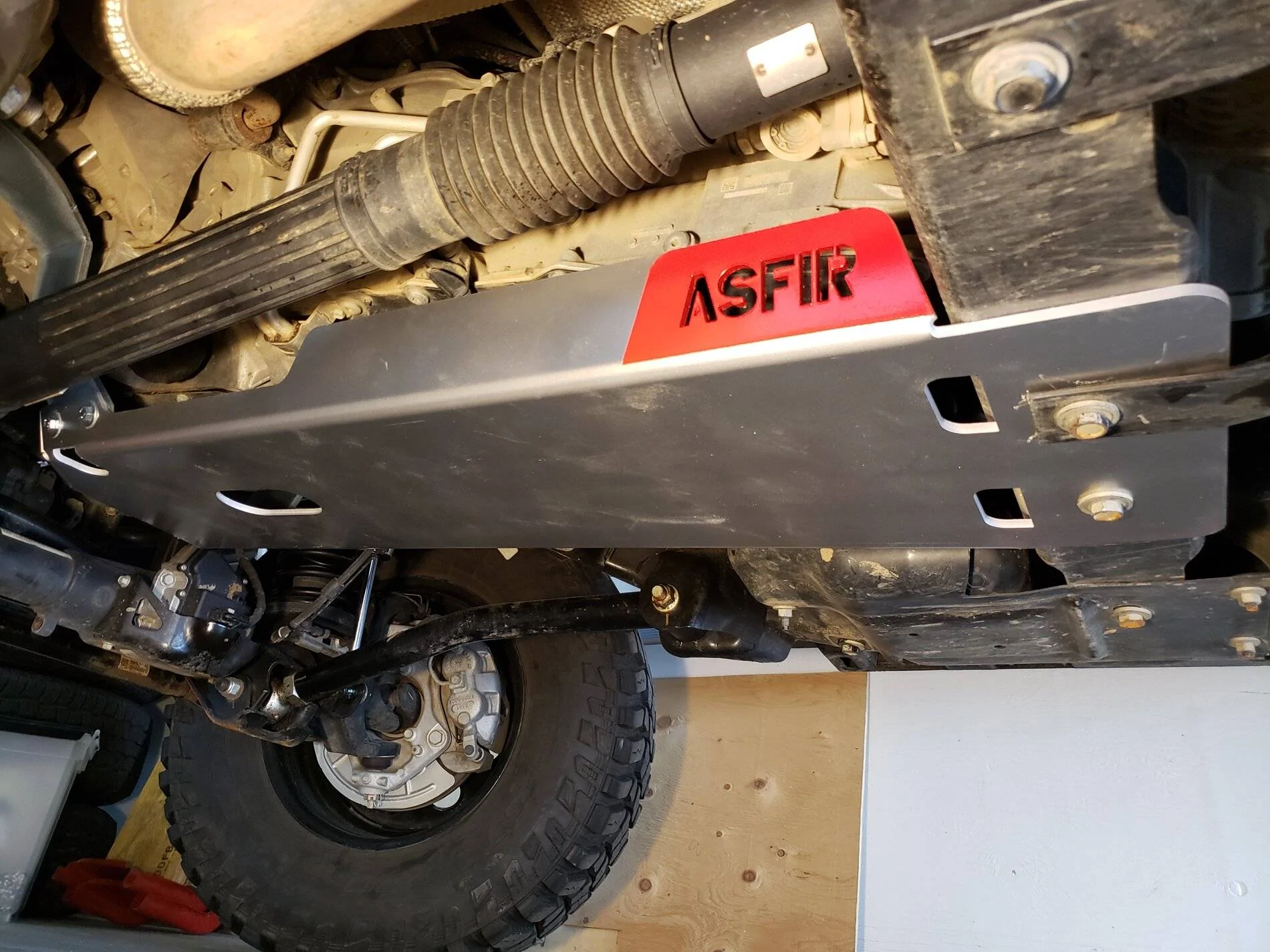

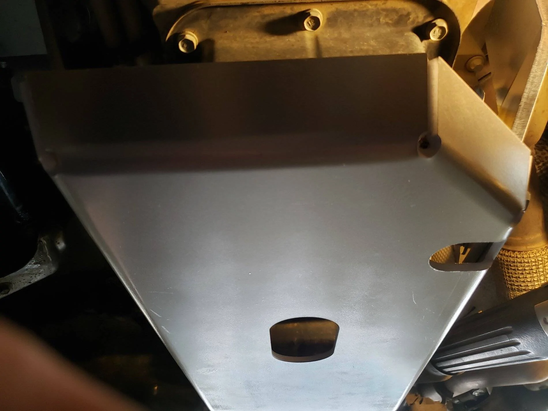

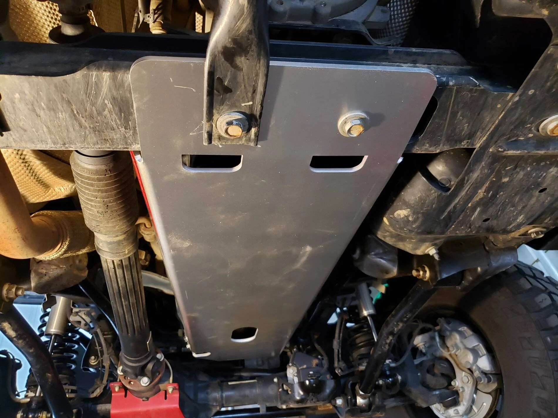

My @ASFIR4X4 shipped out 5 weeks after ordering and being told it was sold out. 5 days to Ottawa, Canada and that includes a one day hold in Cincinnati. Remarkable. Courier was DHL.
Fits my 2 door 2.0L turbo with eTorque like a glove. I added a red accent.
I'm running a bigger oil filter, about 1" longer than the OEM. There's plenty of room for drain plug access.
