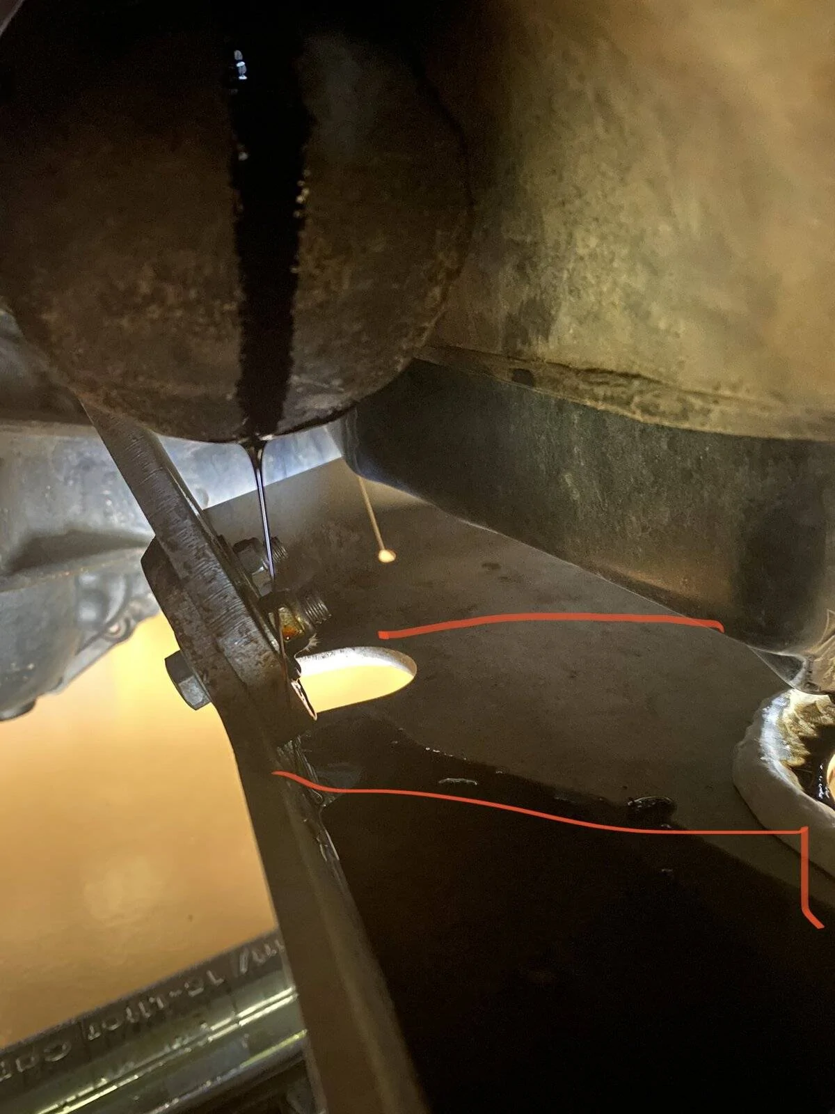

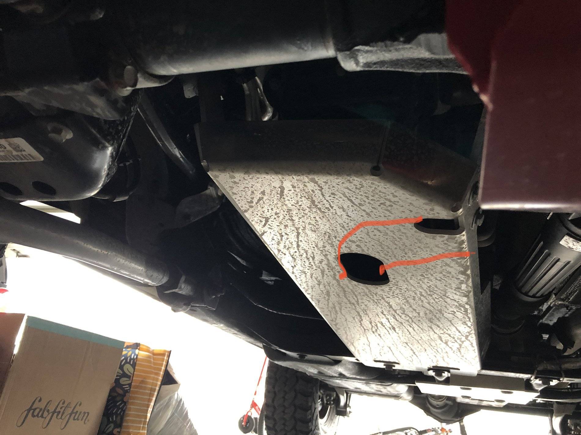

The oil change is a pain with the Asfir and I’m working on a solution that would be best implemented BEFORE you install. I picked up some JB Weld Water Weld (for use with aluminum). It’s basically a dam.
I kneaded it and made it into a rope (it’s a touch more gooey than the regular JB from my memory. Just wait for it to start to get warm from the chemical hardening process and that should make it easier to work with. Get the section of rope into position and press down/contour as you see fit. I put a curve in one side to cup the area.
I did the drain plug area and forgot about the mess the oil filter adapter drains down until the oil change so now I need to go back in and add more. SMH
Again, get some Water Weld and do it before you install. It’s more difficult to do a nice job because it’s tight above the skid.
Borowing a pic looking from the front of the skid from MILT earlier in the thread to illustrate (Thanks)….
To get the drips to break off and fall on both sides of the cutout rather than running down toward the back of the Jeep I’d run the rope of weld over the edge of the cutout and actually come to a small piece pointing down past the bottom of the skid.

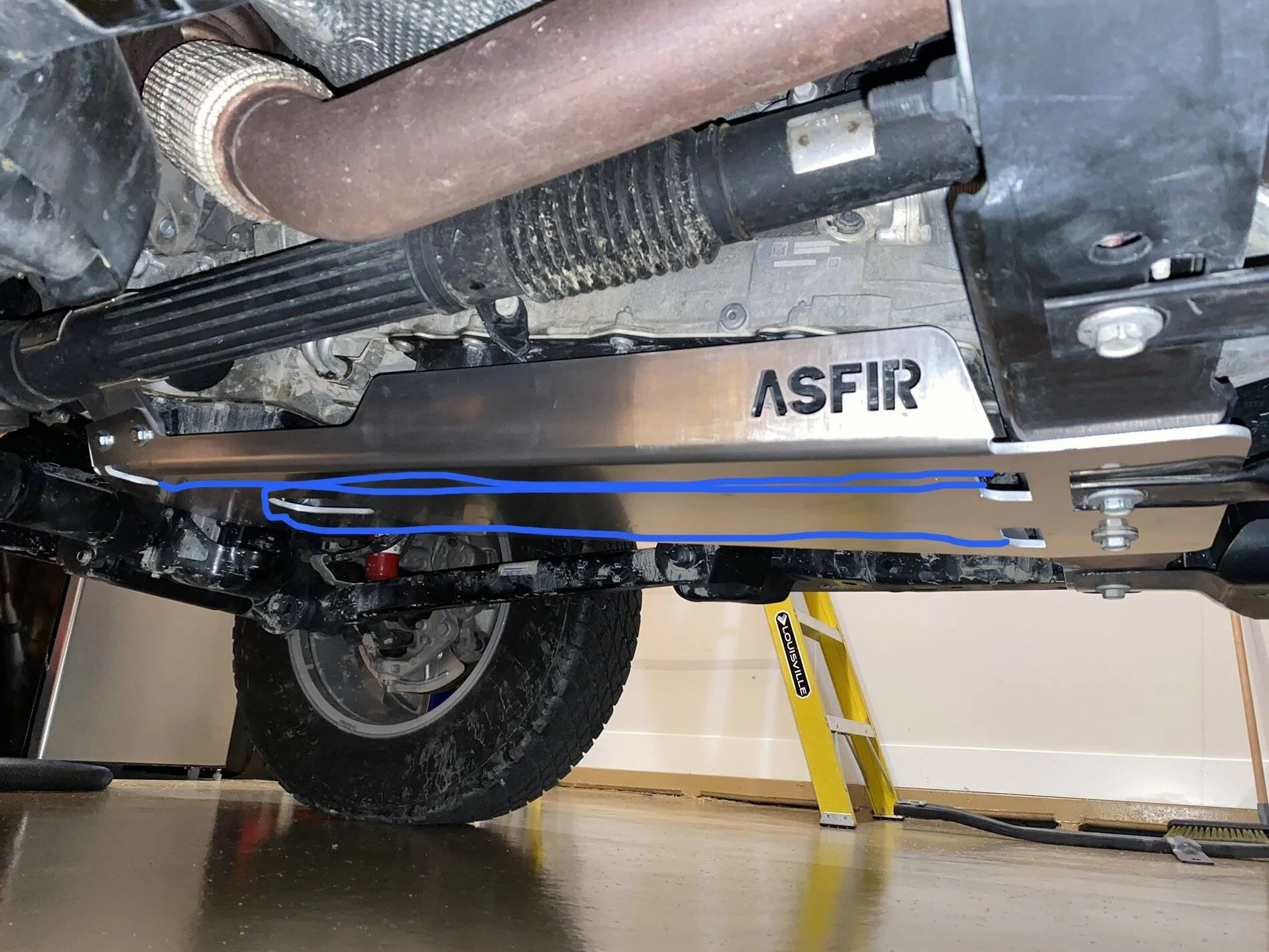

Hi do you have the 2.0?
I have the Artec aluminum skid, and I had the dealer do the "free" oil change an my transmission/tcase skid was dripping oil for 2 weeks since it was pooled there. I'm trying to find out if the oil just sprayed past the hole for the drain of from the filter or what.
Do you have any more pictures of the bath the oil was taking? and the dam?
Thanks.
Yes, a 2.0 and it runs from the filter and when the drain plug is just barely making a stream or dripping…it runs the general downhill path of these blue lines pictured and comes out of both rectangular holes at the back.
I have part of it Pictured in my last post on the edge of the picture. Problem is I need to modify the dam (grinder) and make a couplemore coming from the oil filter area funneling it all to the drain plug cutout area.

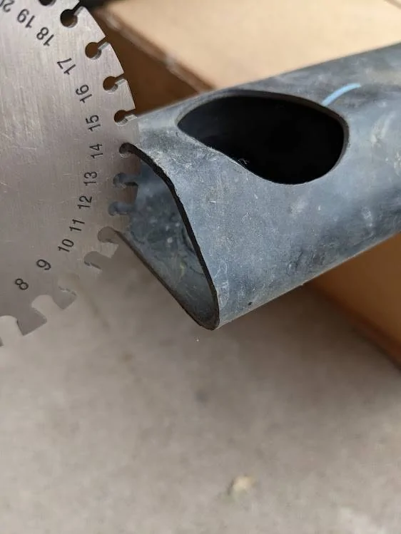

Asfir vs. M.O.R.E.
The M.O.R.E. is wider, but unfortunately doesn't fit 2018 2-doors due to the gas tank (2019+ is OK). Even thought the M.O.R.E. skid was way heavier, the Asfir brackets were actually heavier.
Asfir skid ā‰ˆ 4 gauge aluminum
M.O.R.E. skid ā‰ˆ 8 gauge Steel
Asfir brackets ā‰ˆ 0 gauge steel
M.O.R.E. brackets ā‰ˆ 3 gauge steel
M.O.R.E. skid ā‰ˆ 8 gauge steel
Forgot to add the stock crossmember for comparison: 14 gauge steel "tube"
