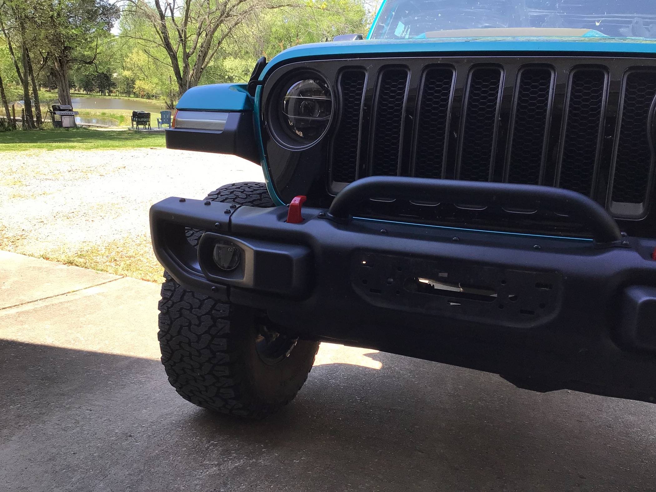

Special thanks to all who contributed to this thread. I have spent an enjoyable couple hours reading and sitting in front of my Jeep and under my Jeep pondering my skid plate path forward. Beautiful day today.
Jeep Wrangler JL 2.0 Engine Skid Plates IMG_0033
