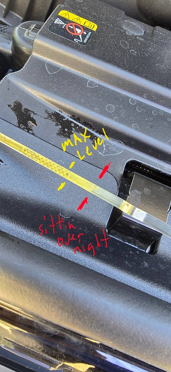

Hellow everyone, i purchased 2024 willys 2.0 three weeks ago and now have 1,300 miles. This morning i checked my engine oil level and i see its about half an inch above the max level. Is that normal? im a bit concern

This is going to sound crazy, but the 2.0 requires a specific procedure for checking the oil. It's outlined in the owner's manual.
The oil needs to be checked 5 minutes after a warm engine shutdown. Before then, and the reading may be artificially low. After then, and the reading may be artificially high.
When I do a cold engine oil check (sat overnight) on my 2.0, the level will read far above "full" on the dipstick. That's with an exact fill of 5.0 quarts. When I check my oil using the procedure outlined in the owner's manual, the level is properly at the "full" line.
Do the warm check 5mins post shutdown and report back.

The owners manual describes the procedure to check the oil level. I believe its to wait 5 minutes after the engine is shut off the check it. If you wait longer than the prescribed time the level will show high.
I don't like that process as it seems to leave room for doubt. I did an oil and filter change and put in 5 qts of oil. I warmed the engine up and waited 5 minutes after shutting it off then checked the oil. It was at the top of the hash marks. I let the Jeep sit overnight. The next morning the level was high, about where yours is. I used a staking tool and put 2 dimples on the dipstick where the oil level was. Now I can check my oil without having to warm the engine up and making sure I wait the required time to check it.
