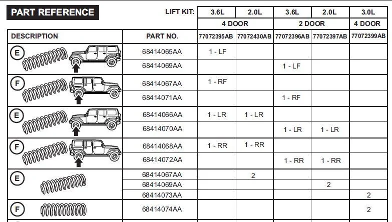

I don't have the exact info you are looking for, but I can offer an alternative. The 3.0 Mopar lift springs should be stiffer than the 3.6 & 2.0
Jeep Wrangler JL Spring Rates Mopar Lift Springs

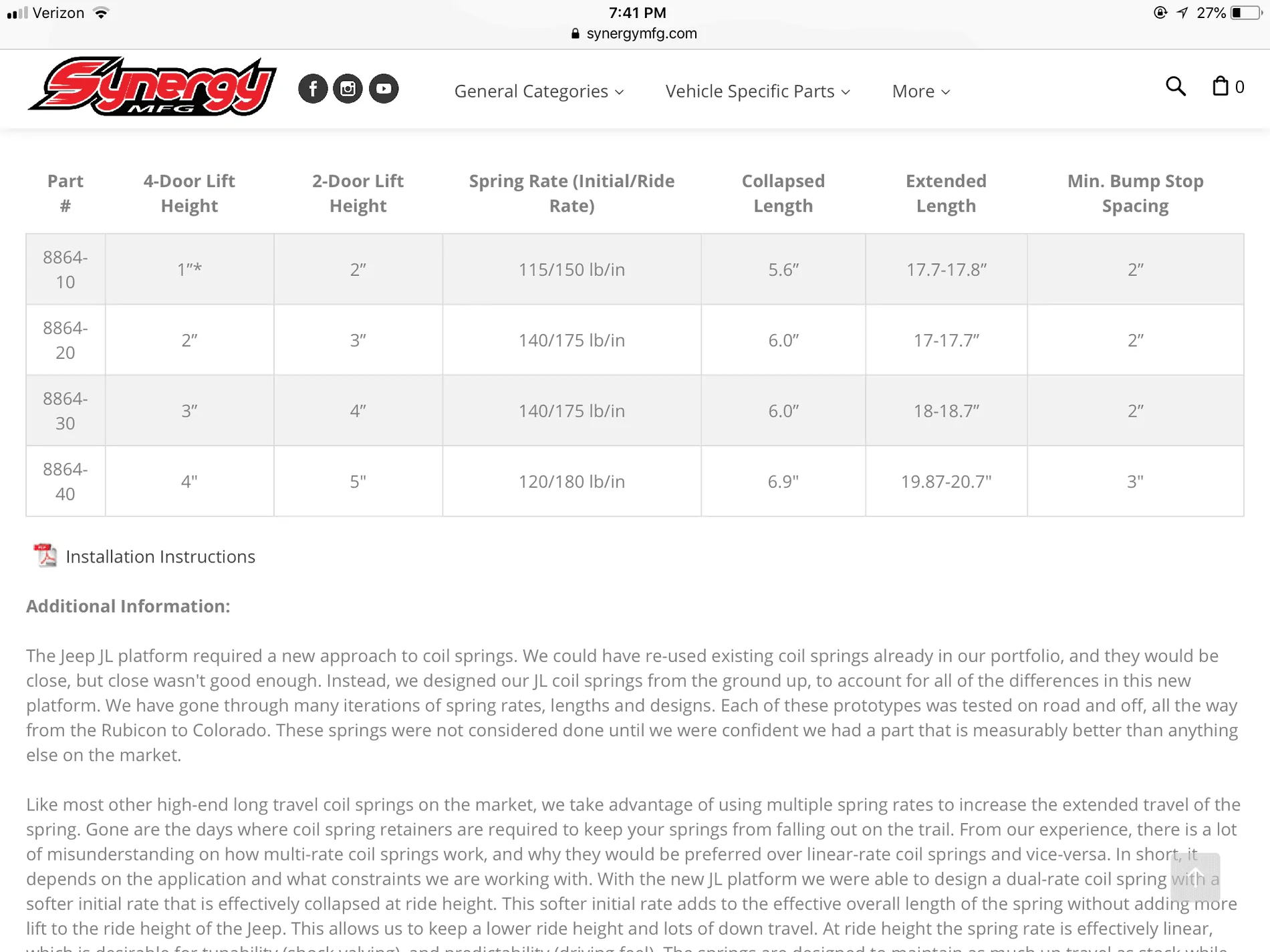

GavinH
Gavin
Mar 30, 2023
41
276
139
JLUR
Edit: added Teraflex rear rate based on the 3.5" springs
Front / Rear
JLU Sport : 117 / 172
JLU Rubi : 125 / 174
Mopar lift : 132 / 181
Synergy : 120 / 175
Teraflex : 140 / 170
RK 2.5 : 137 / 175
RK 3.5 : 140 / 185
EVO Soft : they wouldn't tell me
Metalcloak: they wouldn’t tell me
Just received my JKS 1.5 springs.
130 front 136 rear
Anyone know roughly the free length of jlur rear springs trying to see what these JKS are actually going to net me?

GrayWolf.Overland
Subash
Sep 9, 2021
33
1,530
3,150
Maple Ridge, BC, Canada
www.instagram.com
2025 JLU Rubicon (Anvil Gray)
Spring rates gathered over time. Not a complete list, and some of this may or may not have changed as years progressed. Data on Clayton and Synergy are listed on their pages so they are accurate. JKS data is from a recent enquiry I made with them as I was shopping for a 2.5" coil spring (fall-2023)
ManufacturerOption/VariantFront lb/inRear lb/in
JeepJLU Sport117172
JeepJLU Rubicon125174
JeepMopar 2" Lift132181
Teraflex2.5"/3.5"140170
Teraflex2.5"/3.5" HD170300
Clayton1.5"160137 / 200 (dual rate)
Clayton2.5"/3.5"188165 / 230 (dual rate)
Clayton2.5" HDN/A165 / 285 (dual rate)
Clayton3.5" HDN/A170 / 285 (dual rate)
Synergy1"95 / 120 (dual rate)115 / 150 (dual rate)
Synergy2"/3"110 / 120 (dual rate)140 / 175 (dual rate)
Synergy4"115 / 120 (dual rate)120 / 180 (dual rate)
Rock Krawler2.5"137175
Rock Krawler3.5"140185
JKS2.5"/3.5"110 / 175 (progressive)144 / 210 (progressive)
JKS2.5"/3.5" HD144 / 210 (progressive)152 / 210 (progressive)
OME2-2.5" Standard135160
OME2-2.5" Medium150 (bumper + Winch)175
OME2-2.5" Heavy---200
