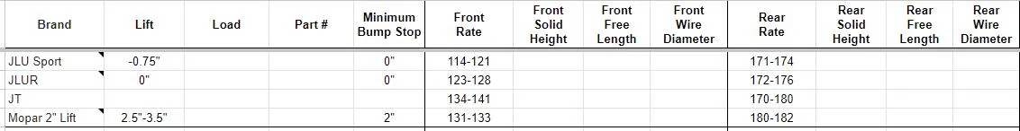

Does anyone know what the spring rates are for the springs that are included in the Mopar 2 1/2" Lift Kit for the 23 Wrangler Rubi 2 Dr 3.6L eTorque Auto Tranny? The best guess I am able to get from a Dealer is they are the same rate as the factory springs that came off the line so the cushy street ride is not compromised and they can't even tell me what that rate is.
I need to find out what springs to upgrade to for a laden weight of 6,000 pounds.

I'm going to replace the factory trackbars with adjustable trackbars. I just measured the track and I am a tad shy of a 1/2" more in the front and over a 1/2" more in the rear. Also, I'm going with adjustable upper control arms in the front. I barely get 5 degrees of caster and I should have at least 6 1/2 degrees for stability while in motion. A static 5 degrees is not enough to compensate an articulating lifted vehicle on the highway in order to keep it from being a handful.

Unfortunately, the Fox 2.5 non-reservoir shocks are not valved for my laden weight. I'm going to go with the Fox Elites 2.5 Double Adjustable Reserviors with custom valving for the weight and the dual-rate springs that will accommodate my weight.
The right spring and shock package should never be underrated for a vehicle with the kind of weight I am carrying.

Well, I decided to go with the Accutune Elite Series 2.5 Double Adjustable with coilovers. I called Accutune this morning to place my order and I learned that Fox discontinued the 2.5 Elites with Double Adjustable Coilovers. However, I can get the 2.5 Elites without the adjusters in Coilovers.
We did discuss the possibility of using the King shocks but they are only a single adjuster coilovers.
For my application, I want the double adjusters so my only option with the Fox 2.5 Elite Double adjusters was go with the non-coilover shocks. However, I was still concerned of having the right springs for my weight.
Acctune said they can valve the shocks to take care of the weight I am carrying contingent upon my selection of the springs. I ended up with Clayton Springs because they provided the spring data I needed in order to select the correct springs that will work with the Accutune shocks. The other spring providers were reluctant to provide their spring rate data. Clayton also provide the critical data that Accutune needed in order to not only tune the shocks but for the correct fit for my ride height.
The shocks and springs are on order and should be here in about a week or so.
