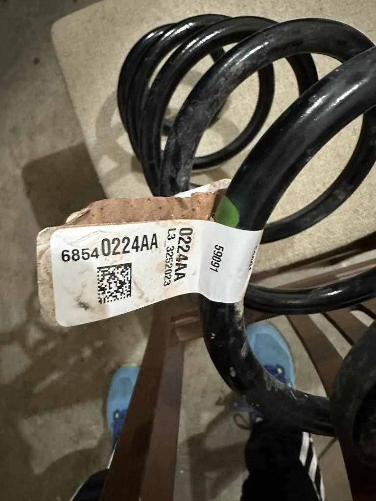

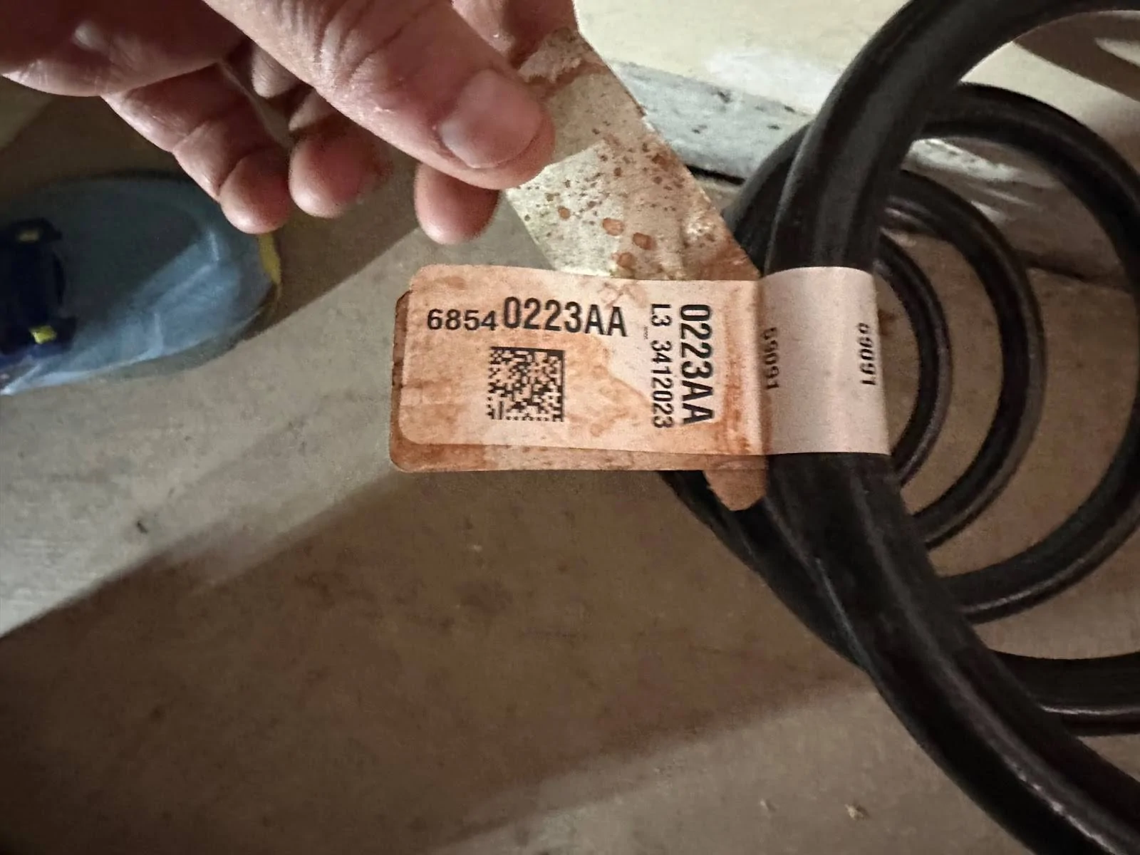

Here is the info from my OEM springs:
15 3/4 inches for passenger side rear OEM Springs (Rubicon X, 25 inch tires), OEM part # 6854 0224AA
15 1/2 inches for driver side rear OEM Springs (Rubicon X, 25 inch tires), OEM part # 6854 0223AA
Jeep Wrangler JL JL Extreme recon spring rates sY8ruZaIfv7nbxvjFSrzSrL?key=59T0r1wC9lIJzqe7m2I2bA
Jeep Wrangler JL JL Extreme recon spring rates jXL8QiwwwbISGYnQ5g-ozfw?key=59T0r1wC9lIJzqe7m2I2bA
