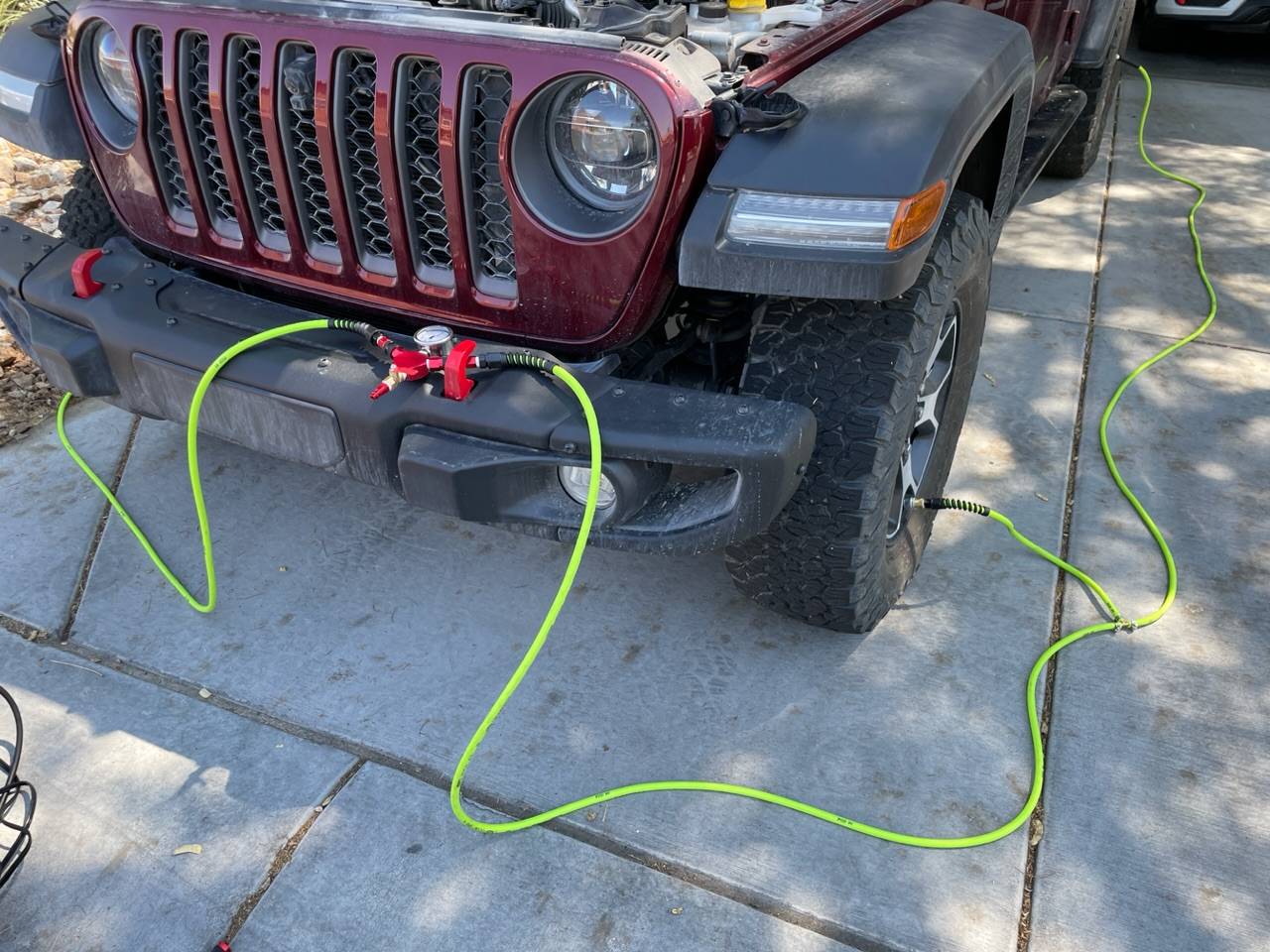

Any tutorial on this?
I built my own system after watching YouTube videos. I do not have a list of all the parts I purchased from Amazon.

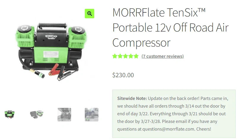

I've got two of those (had them installed in tandem in my WK2 Grand Cherokee for onboard air), and while they are quite good I have found a better solution for my new Wrangler - the Morrflate 10.6cfm dual compressor. It's not that much more money than a 2781, only slightly bigger, but puts out WAY more air, and most importantly, it has a built-in pressure switch and standard air fittings, neither of which the 2781 have unless you add them yourself for another ~$50 of parts from amazon, at which point you've paid as much as a Morrflate costs anyways.

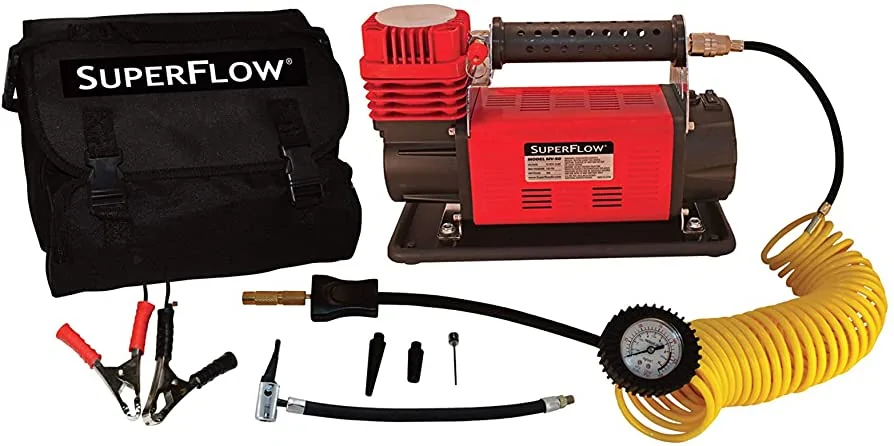

My rule of thumb is to get a compressor that connects directly to the battery. Anything that plugs into the lighter is too small and likely to burn out.
I have this one. So far it has worked well. What I don't like about it is:
The size. It is quite large. (Insert "that's what she said" joke here), and
The proprietary fitting on the air hose. If one of the hoses got damaged, then you would have to take it to a hose shop to get a standard fitting.
IMO, this ^^^ compressor offers the best ratio between portable size, air power and value for money.
However, there are several very similar compressors sold under different names, each with its own set of tweaks and price point.
After burning through several smaller compressors, I got the Smittybilt version shown above. Unfortunately, the air hose comes permanently attached to the compressor and once it breaks, you are SOL. The hose broke right after the 12-month warranty ended, and Smittybilt told me take a hike.
So I replaced it with a nearly identical compressor by Superflow —see below. Unlike the Smittybilt unit, this one has a quick-release detachable fitting right where the Smittybilt hose broke, and a higher quality air hose. I have owned this compressor now for 7+ years without issue.
Jeep Wrangler JL Portable Air Compressor ? 1680111544818
There are nearly identical compressors sold under other brand names, like Rough Country, Viair, Thor, each with its own tweaks and price points.
My advise would be to focus on this size of compressor and check out which brand fits your choice of tweaks and budget.
