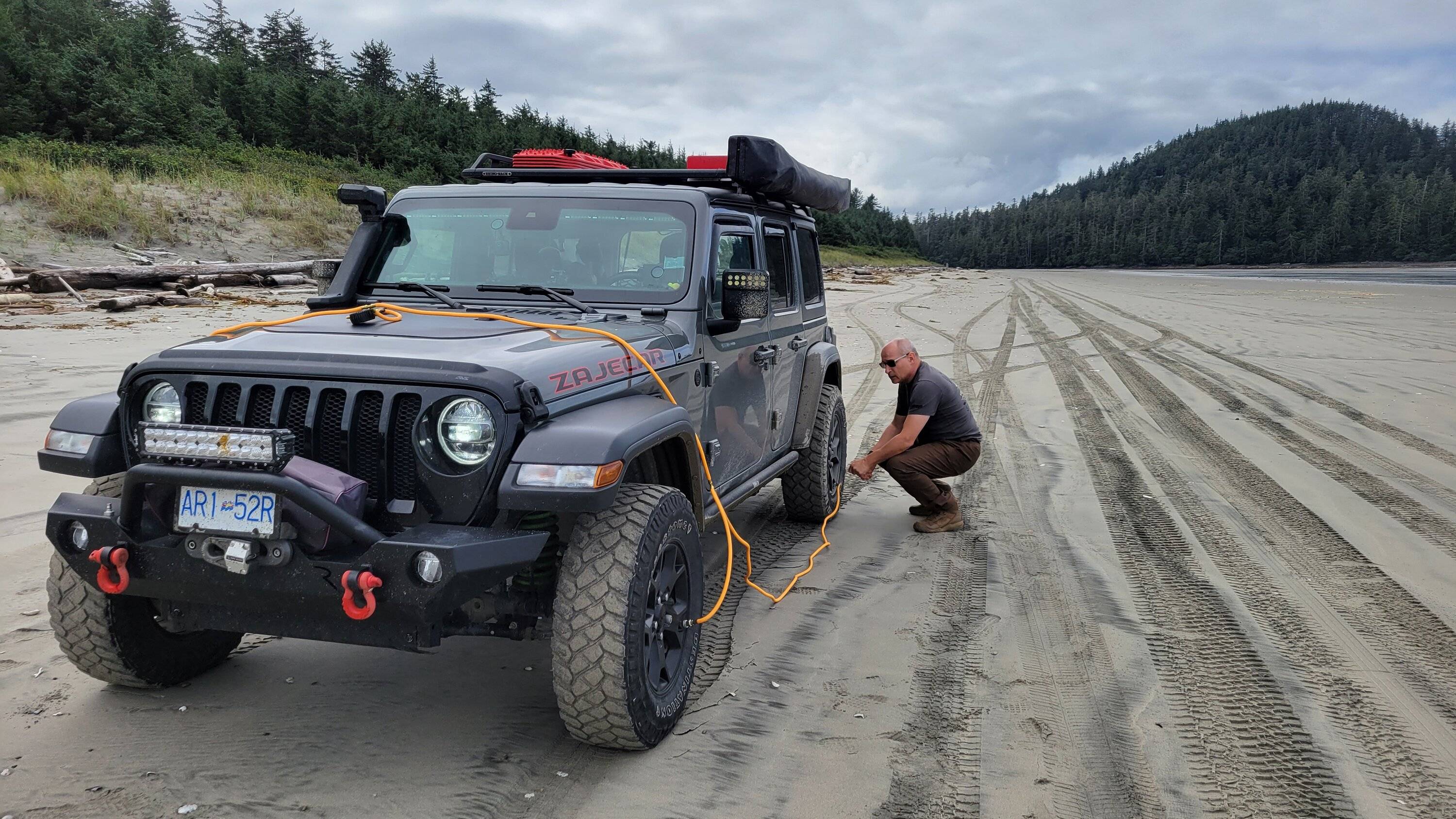

If you are out on trails at least once a month, hardwired air compressor is a great investment.
Think about it, if you are using a portable one
  • You have to get out and connect it to the battery terminals
  • Irrespective of whether its raining, snowing or dust storm - you have to keep the hood open till you are aired up
  • The compressor itself has to sit outside in the elements - not sure if that might cause any long term damage when soaked in rain.
Kraken gives you both a 4 tire inflation kit and also gets the compressor mounted and wired internally. If that is steep investment, you can always do the under passenger seat mount kit from ARB and use a 4-tire inflation hose system with the connector hose a bit longer to cover for the single air up slot being offset at the passenger seat.

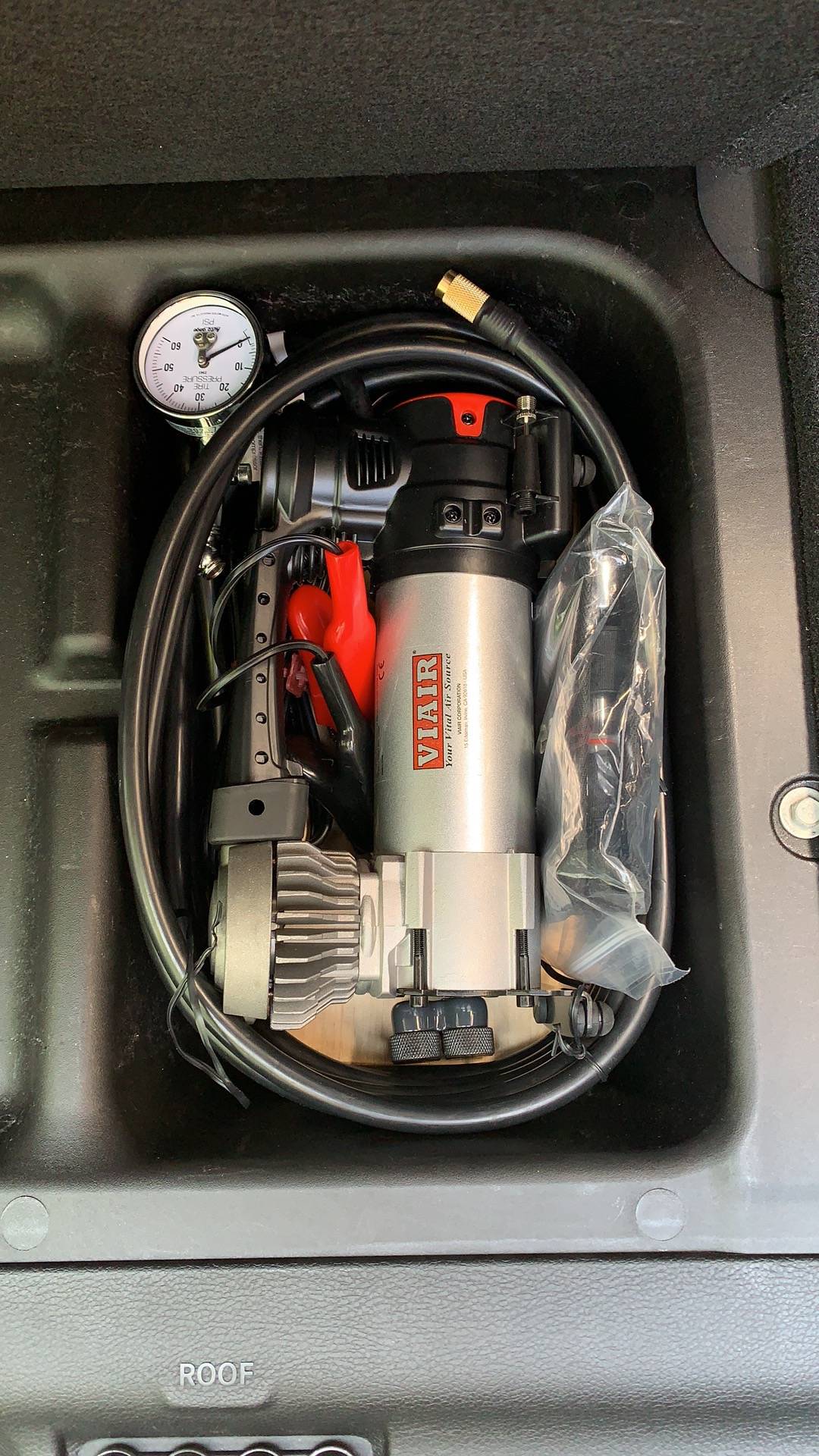

I've had a Viair 440P for years. It was a backup for my truck and never saw use until I started wheeling last year with the JL. I pieced together a dual tire hose system from Harbor Fright parts. Works pretty well. The compressor fits in an ammo can, the hoses fit in a soft bag.

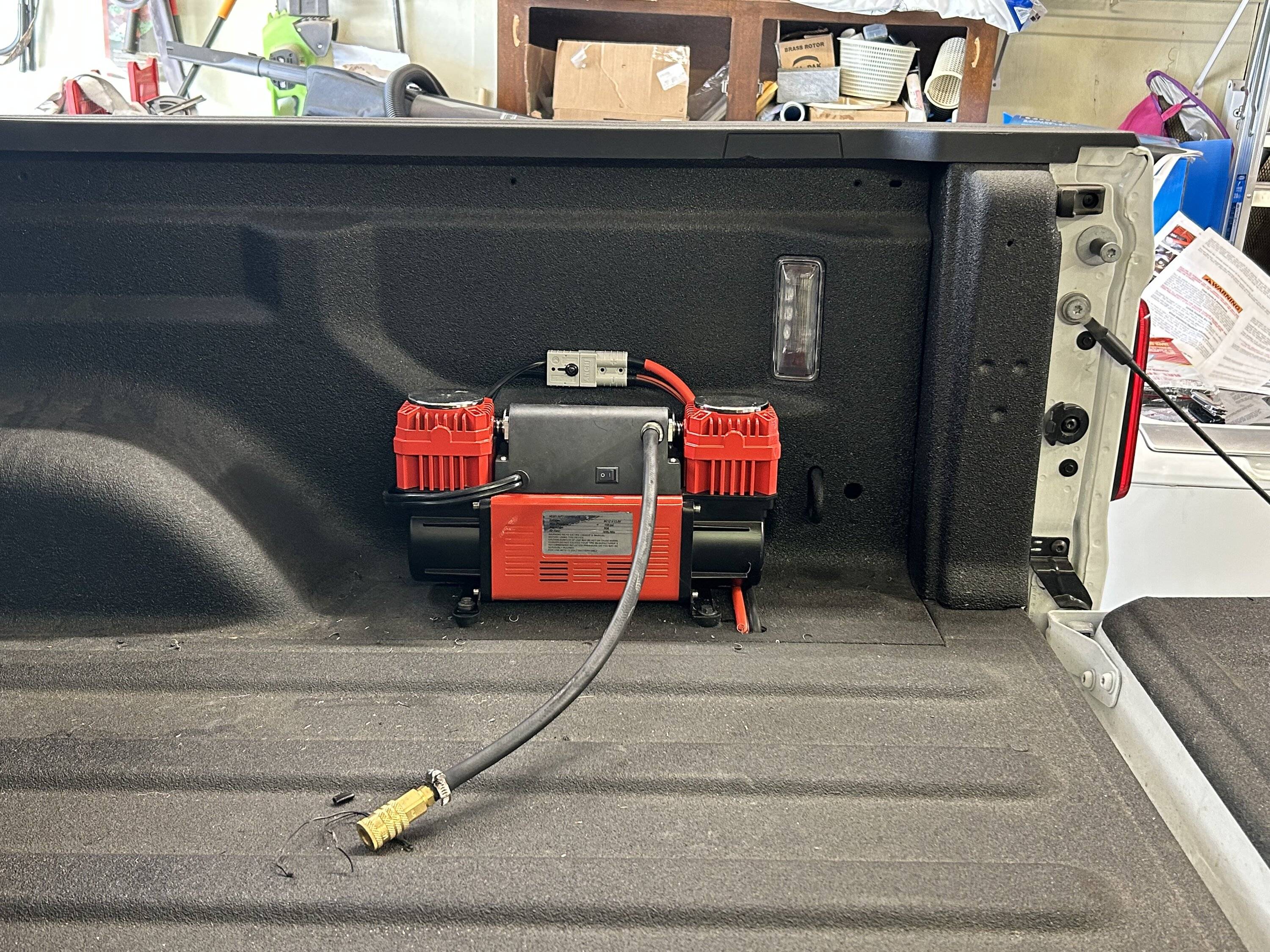

everything in that video is accurate. I go from 32 to 15 back to 32 on all four tires in just over 7 minutes. The compressor originated at Napa Auto Parts but has been discontinued for 3 years. There are several variations out there. Mine was 129 from a guy on Facebook who also has a page all about the modifications. Worth every penny. I hardwired mine in the bed of my JT. Bought a cheap set of 25 foot jumper cables on Amazon, cut the ends off and added Anderson connectors to it so I can remove it. Also DIYed my own up/down hoses and connectors.

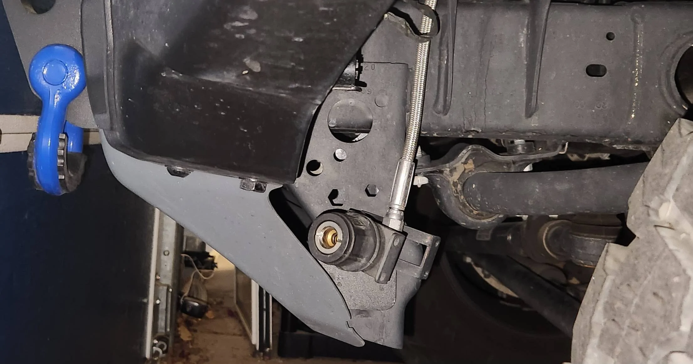

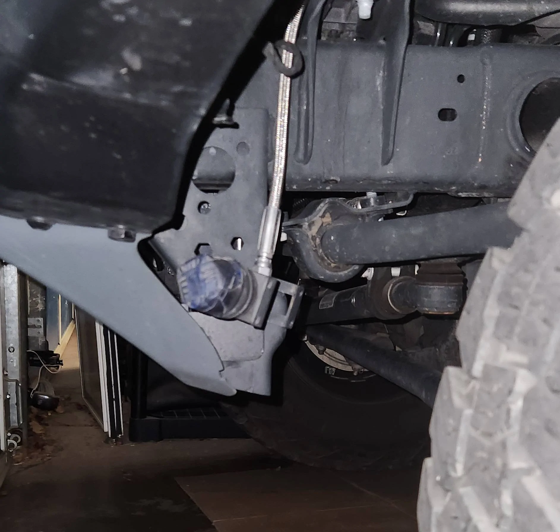

I've had the ARB single mounted to the driver's side firewall for three years now without any issues. Wired to run off one of the auxillary switches, it has been used endlessly.
Not only for wheeling, but my drivers at work often travel through construction sites and are constantly picking nails and screws -We usually discover this the next morning when the tires are flat. Poping in a plug and airing them up in a tight parking lot is much easier with an external connection rather then running hoses or power lines through an open door.
I even have a little rubber cover to protect the fitting from dirt and debris - highly reccomended if you have an exterior set up as the fitting can get seriously gunked up otherwise.

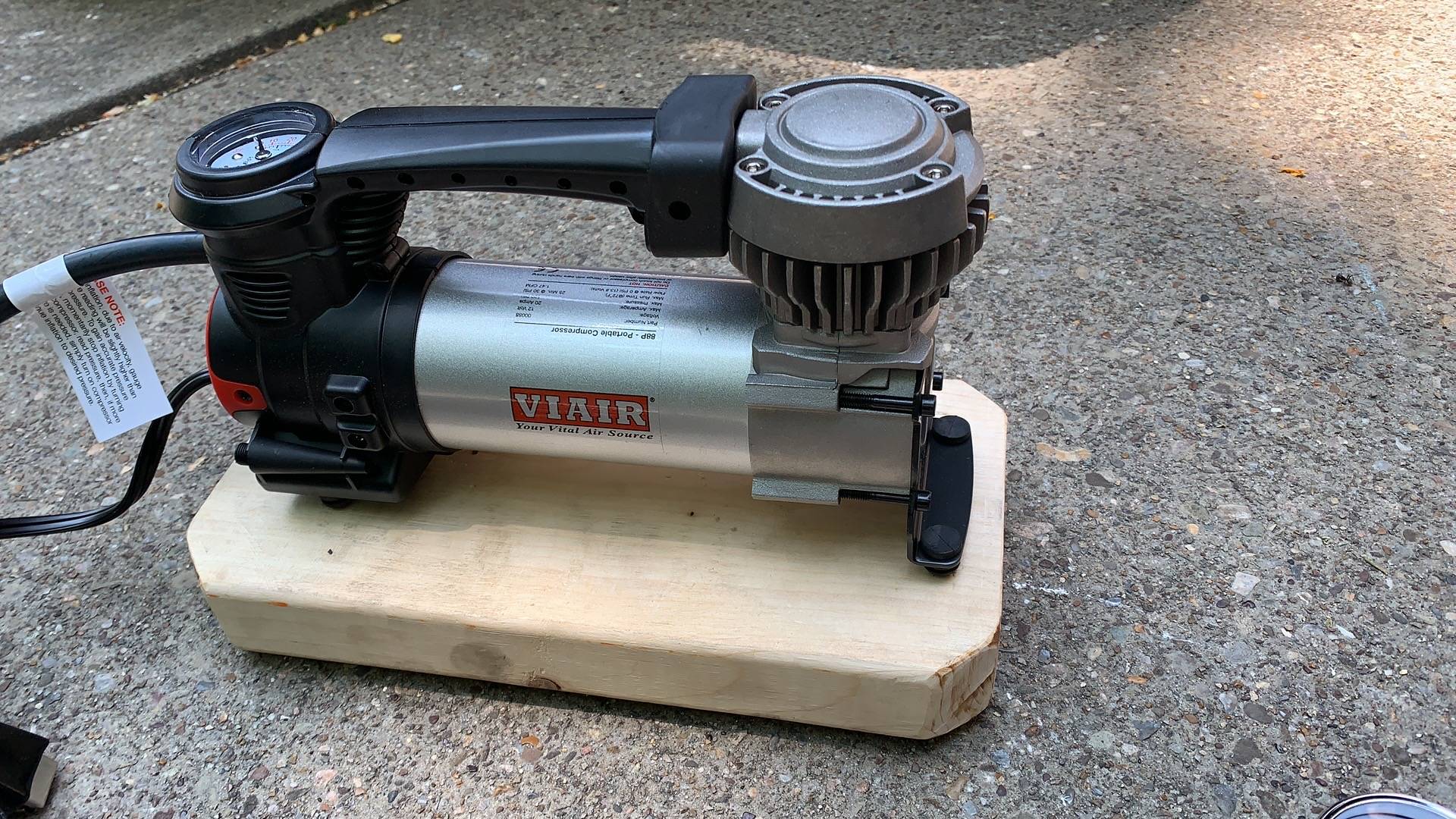

Viair 88P, serves my needs well. Aired up from 15psi to 30 in a bit over 2 minutes each tire.
May start with a portable one and see if it satisfies your needs before jumping into onboard air (lots $$$).
