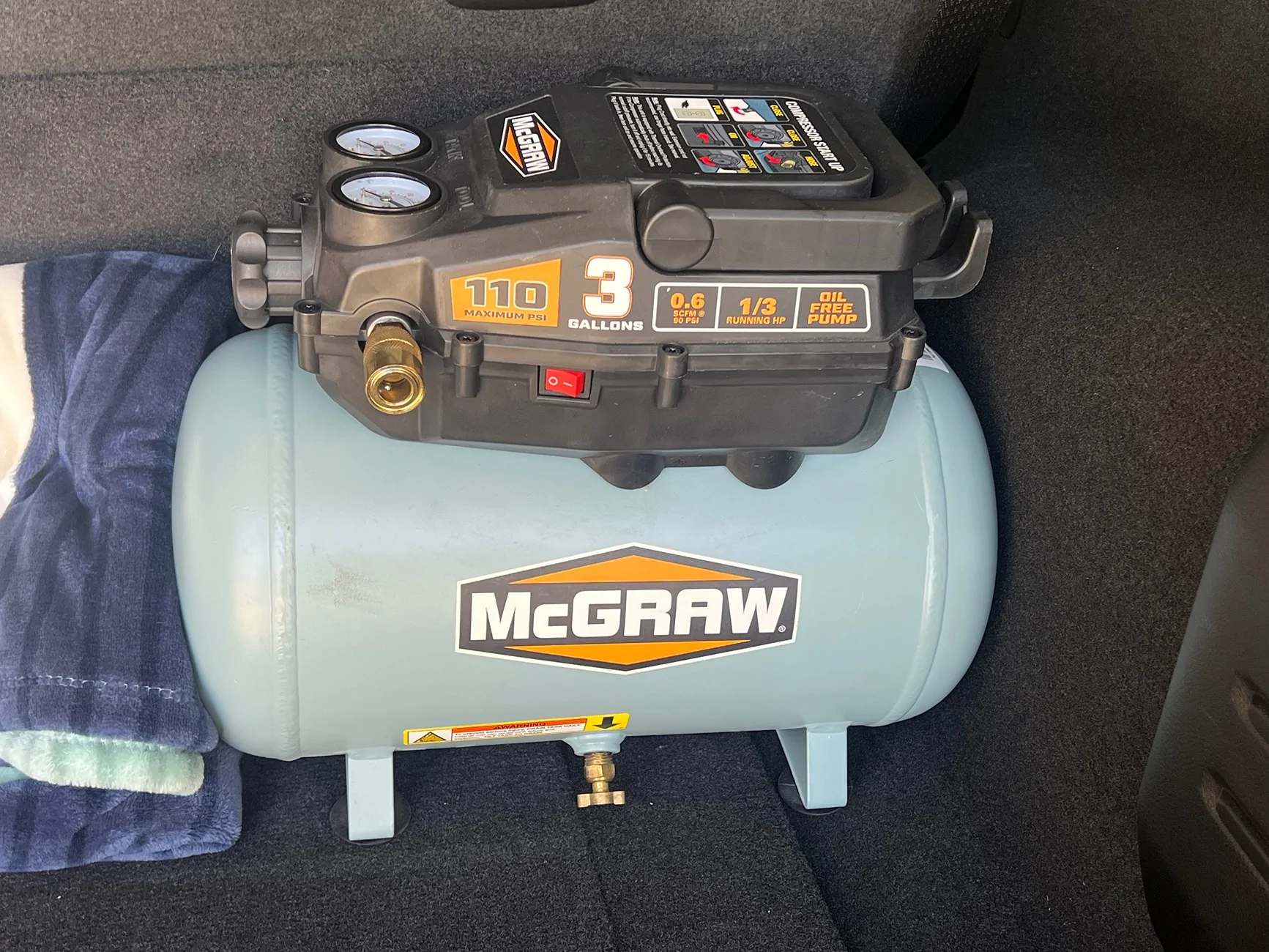

The best $50 I’ve spent and works with any 120v outlet.
Jeep Wrangler JL Portable air compressor recommendations. IMG_0022
