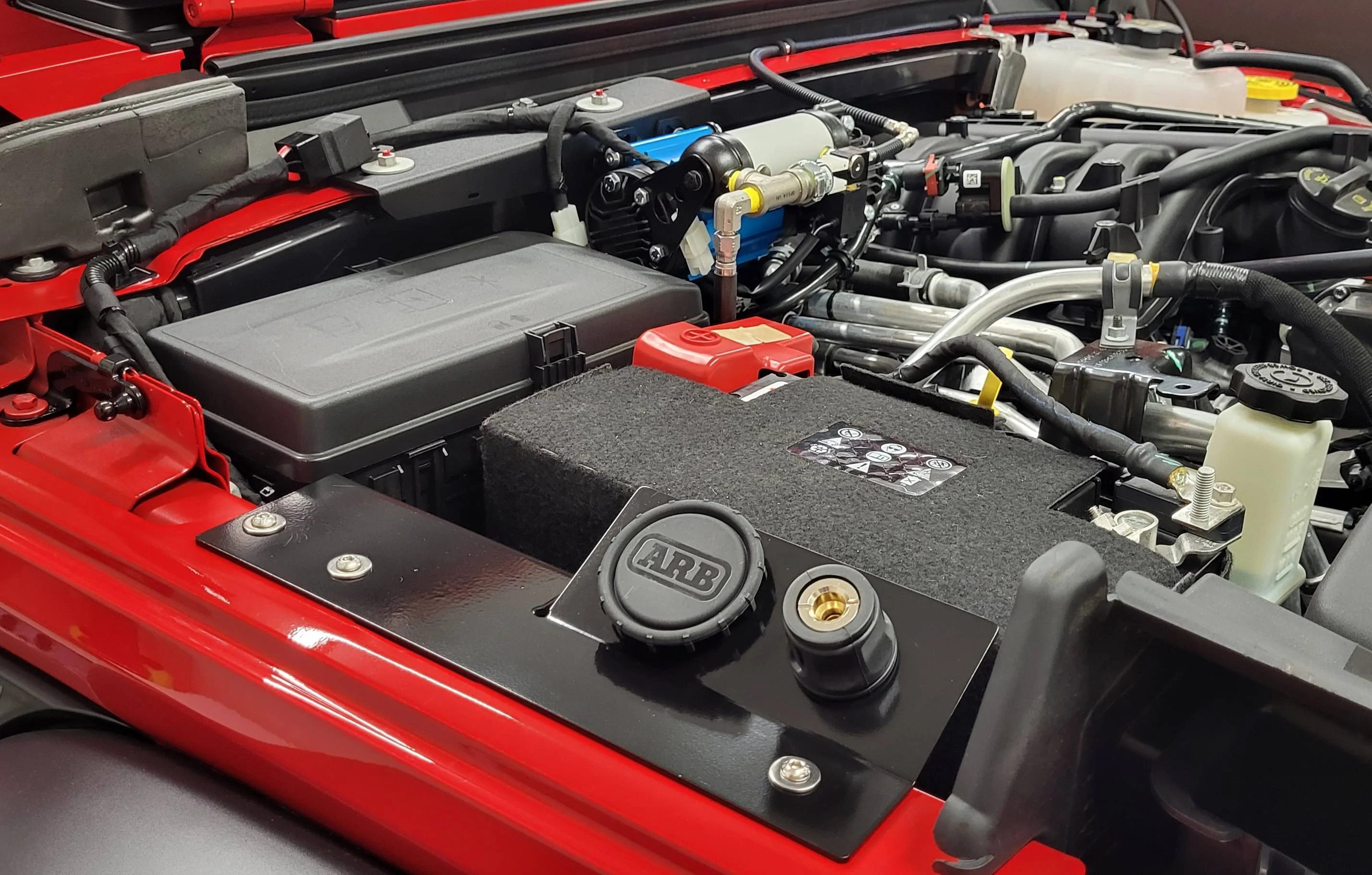

Some will say anything less than 100% duty cycle should be avoided. I respectfully disagree (based on your intended use). I use an ARB high output single primarily to support one air locker. Of course I also use it to re-inflate my tires. I recently aired up all four (34") tires from 15 to 35psi in about 9 minutes (and that was at 6500' elevation). Even if you double that time for larger tires, you're still under the 30 minute published (50%) duty cycle of the ARB single.
I've got a 2dr, so space is a concern, but yes, a twin will be faster. ?

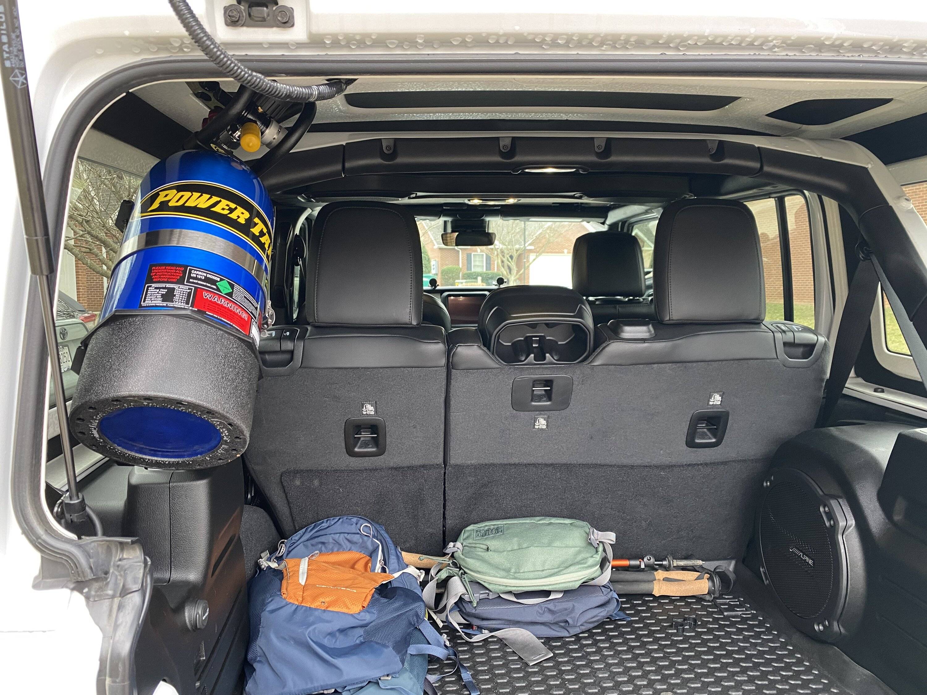

I prefer the PowerTank. I had an ARB Twin in my 4Runner but they can be prone to an early death not to mention the challenge of install locations.
PowerTank is by far the fastest, ultra portable, and mounts nicely in the back:
No doubt PowerTank is the fastest and most reliable.

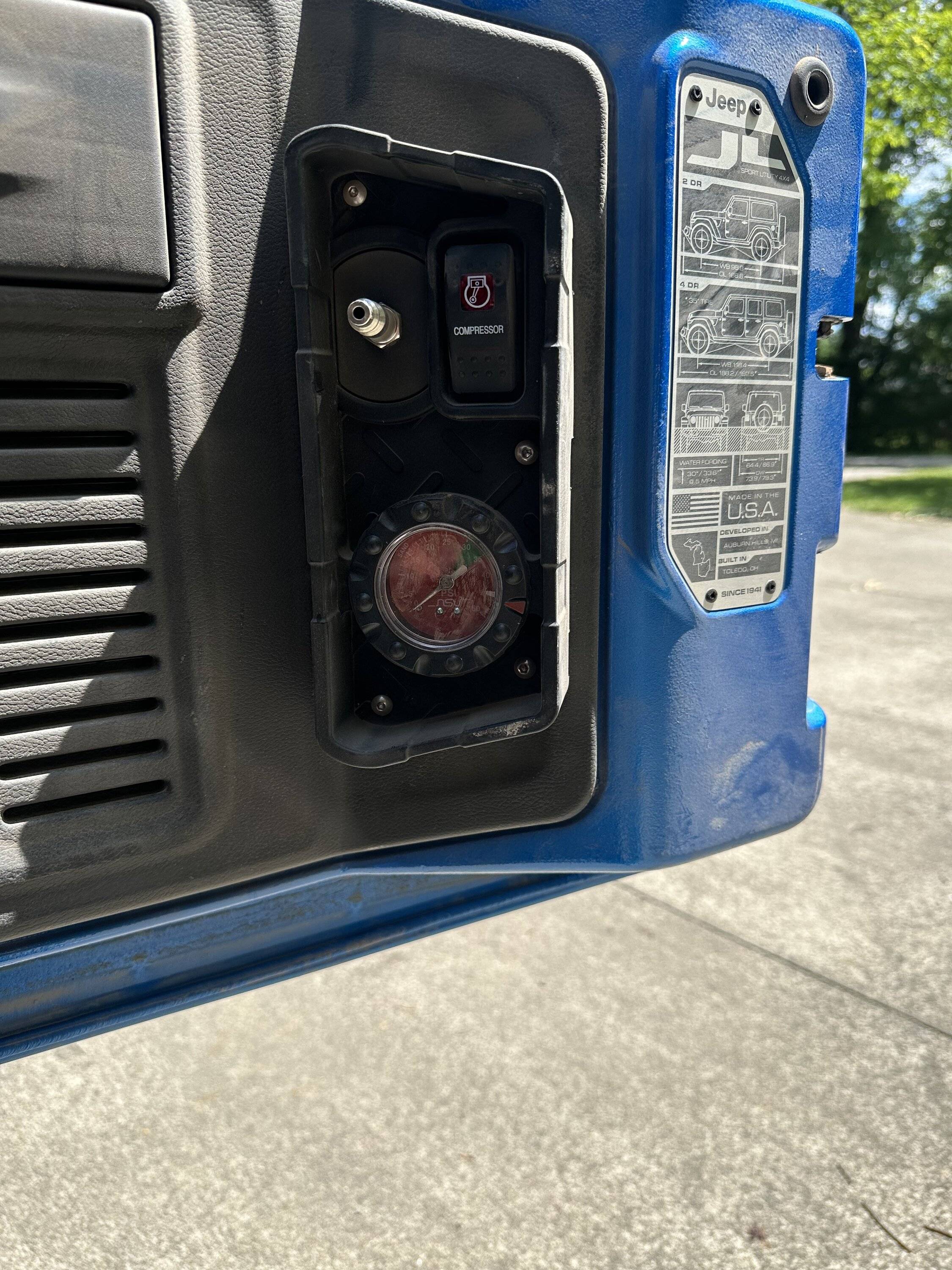

I highly recommend NSV’s tailgate mounted air compressor system. I had one in 2 different JKs for 5 years with no problems. I had a control panel get damaged. Instead of charging me for it, they sent me a complete second system. When I traded for my JL, I let the one go and converted the second system to my JL. The company even replaced the bad control panel for free. I just had to pay shipping. They are out of California. They make a unit for the JL for $1000 and the one for the JK is $700. I swear by it. The compressor mounts behind the spare tire carrier.

Perfect response.The only 100% duty cycle compressor is the ARB Dual Compressor. That said, PowerTank is just so awesome! Can’t go wrong with either.
I would never recommend a single compressor, or any double compressor that isn’t 100% duty cycle.
