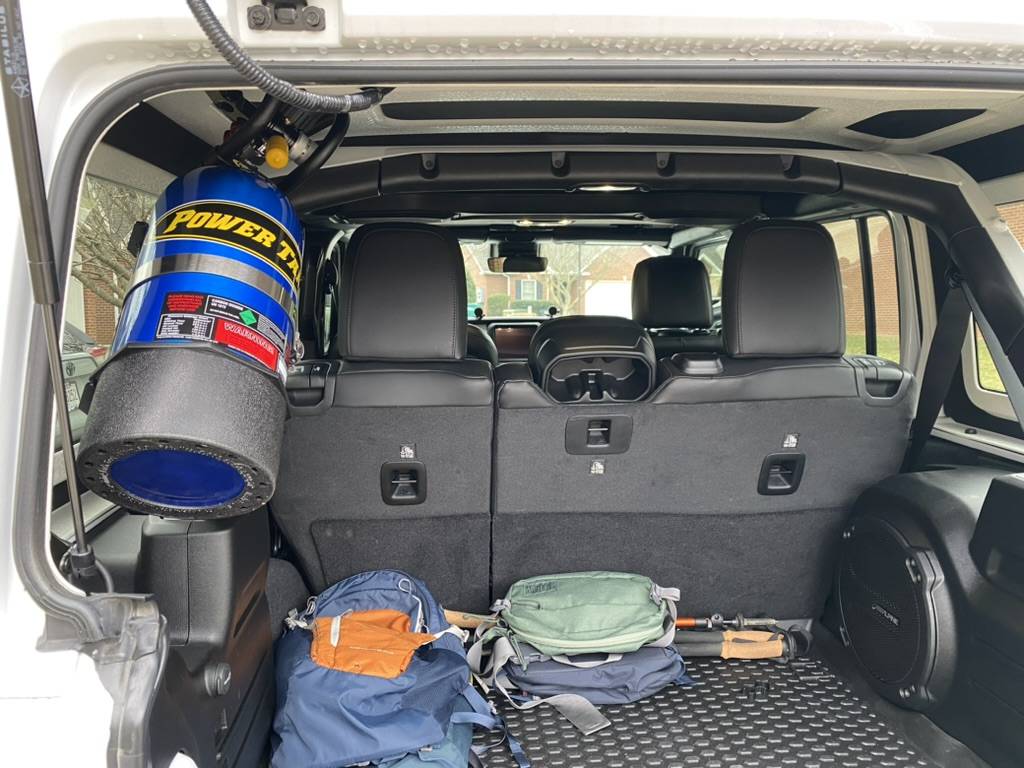

I know you said "Compressor" but have you considered the PowerTank route? I left the compressor world and went full-on PowerTank and love it.

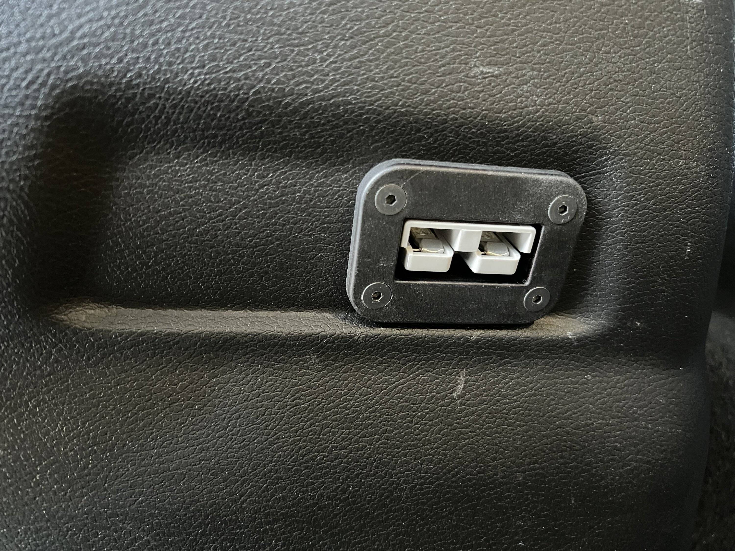

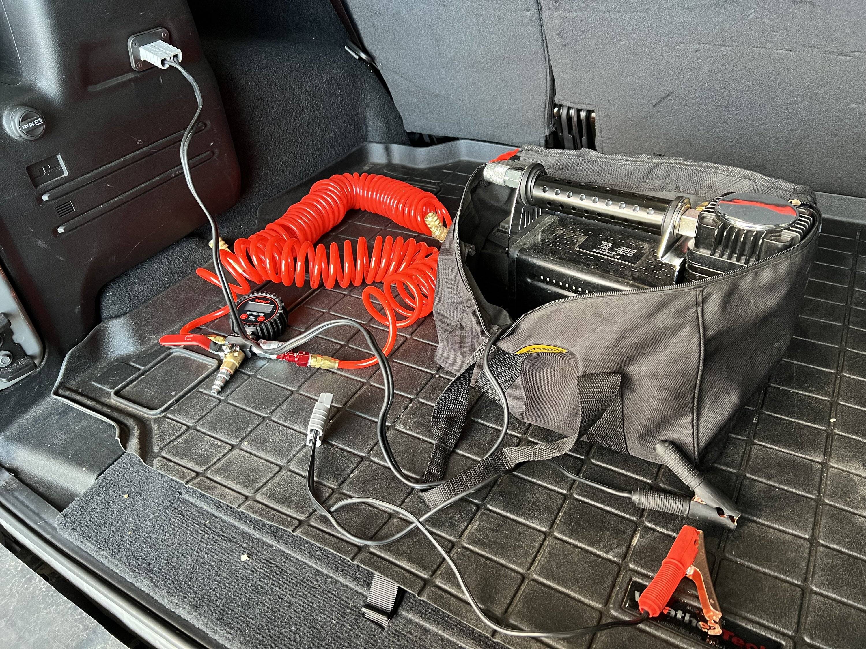

I have 2 Jeeps so wanted a compressor I could move between the Jeeps. I have the Smittybilt and a Speedflate system. I can go from 15 to 30 PSI on all four 35's in 9-10 minutes.
I swapped the Japanese style air hose fitting to a standard American fitting.
I also put a quick disconnect on one side of the Speedflate manifold because the hoses would get tangled when shoving them back in the bag. I disconnect one hose before storing it and it no longer gets tangled.
I also added a 50A Anderson plug in the rear cargo area and put Anderson plugs in-line on the Smittybilt power cord.
