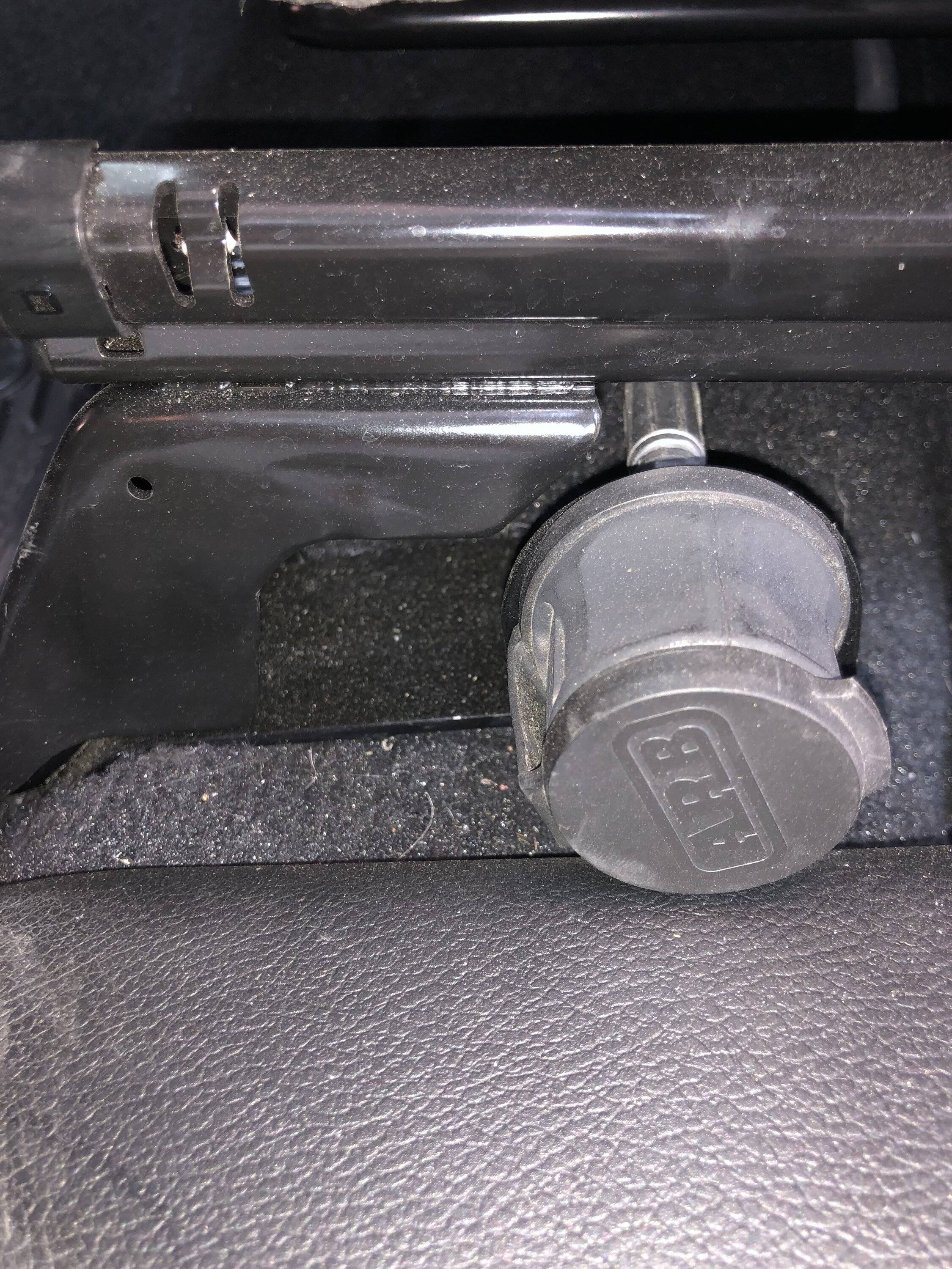

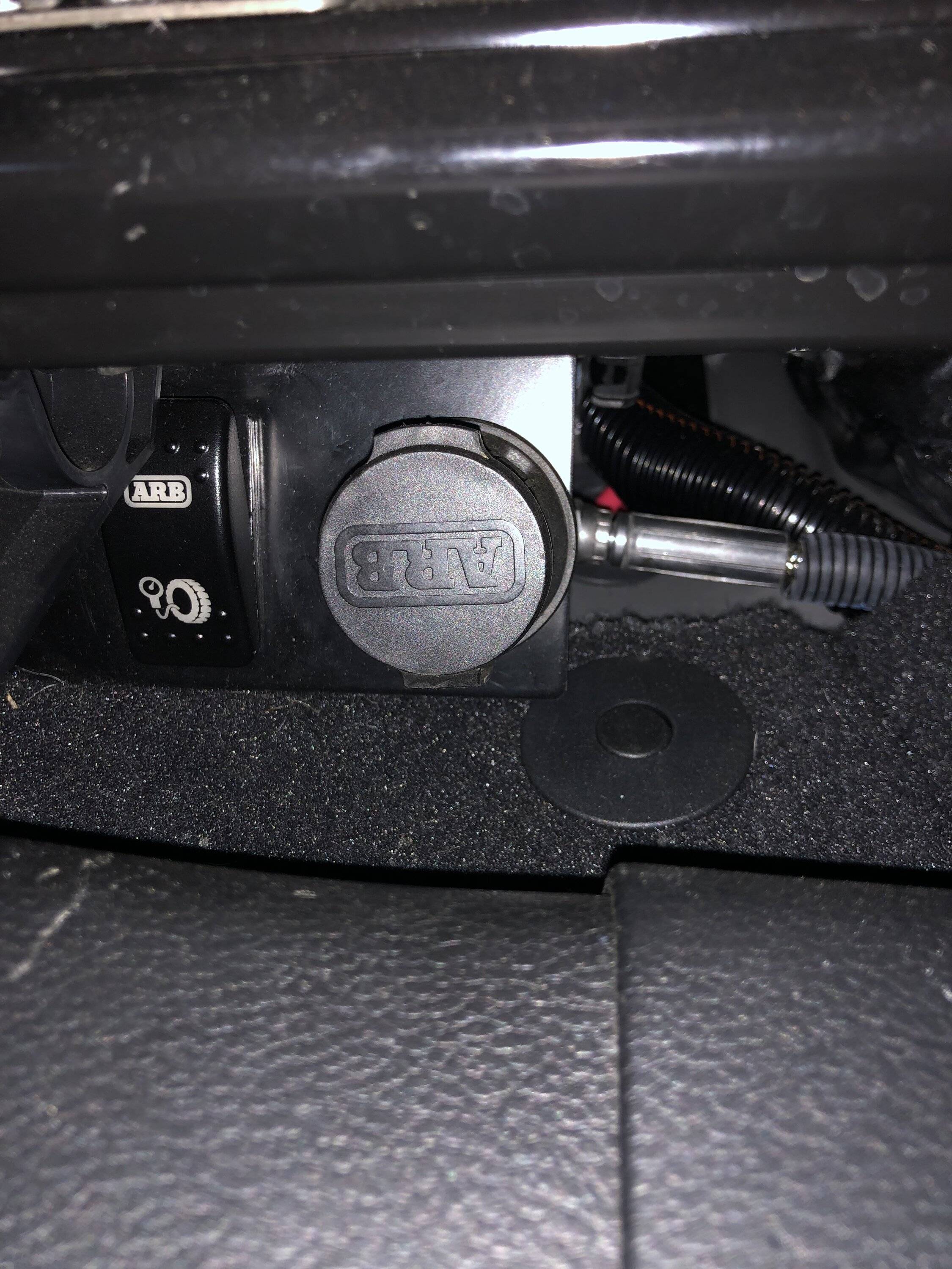

ARB Twin with the ARB under seat mount on the passenger side. I added a T fitting and a short length of braided hose to the drivers side. Used a piece of flat aluminum stock to make a cheap mount on the drivers side.
Passenger side with switch
Jeep Wrangler JL Hard wire or portable air compressor? IMG_1705
Drivers side
Jeep Wrangler JL Hard wire or portable air compressor? IMG_1706
