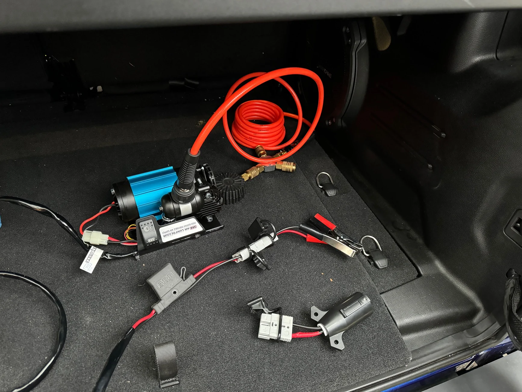

Not sure if this meets your definition of portable, but I got an ARB, cut off the battery clamps and installed anderson connectors for the hitch plug (and carry the clamps with andersons as a backup).
Please ignore the hose on the pic, using a 4-way system from Front Row Offroas these days

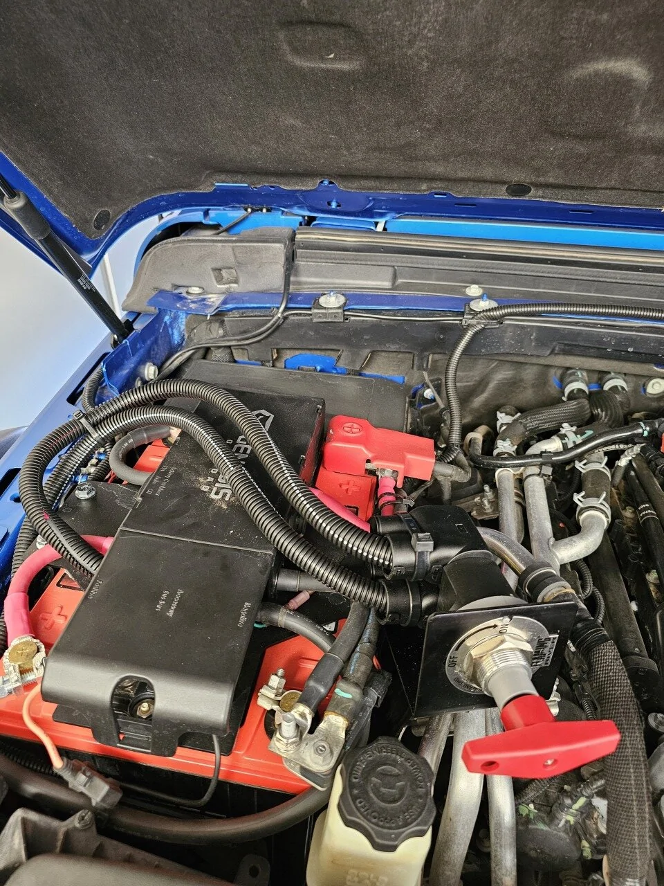

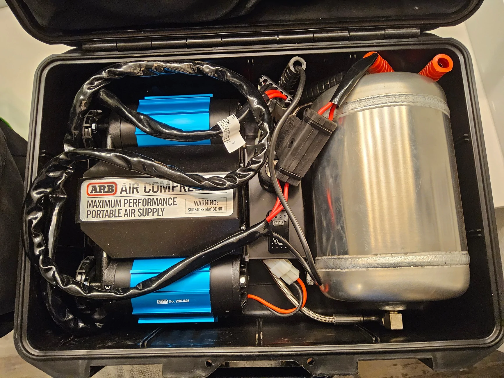

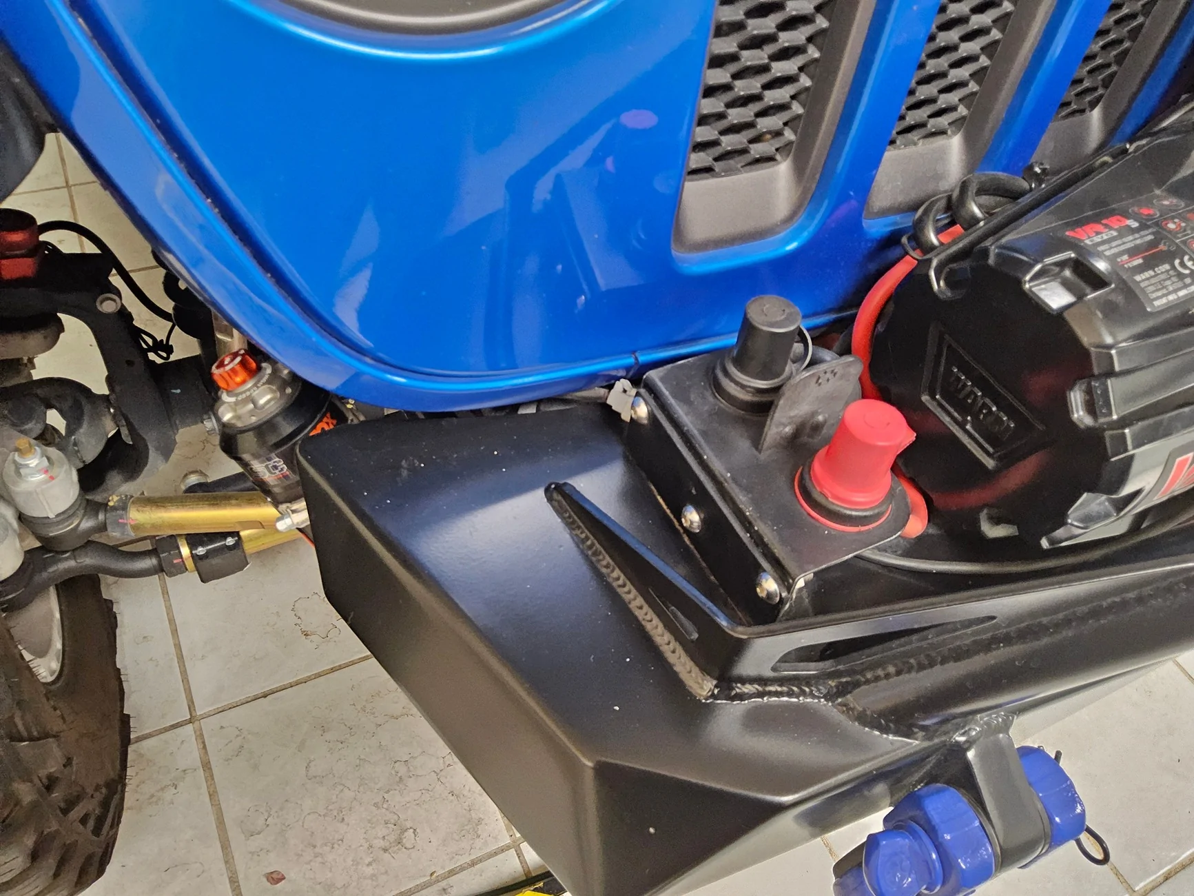

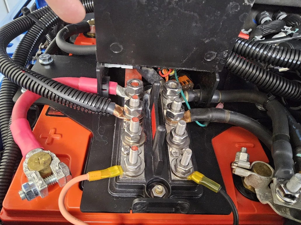

My ARB Twin Portable Air Compressor. It draws about 65-80 amps so you need a good power connection.
I have an external power connection that comes off of my Genesis Gen 3 Dual Odyssey 25 Battery System and I have a battery cut-off switch to shut the power down. With this setup I don't have to raise the hood to connect the air compressor.
