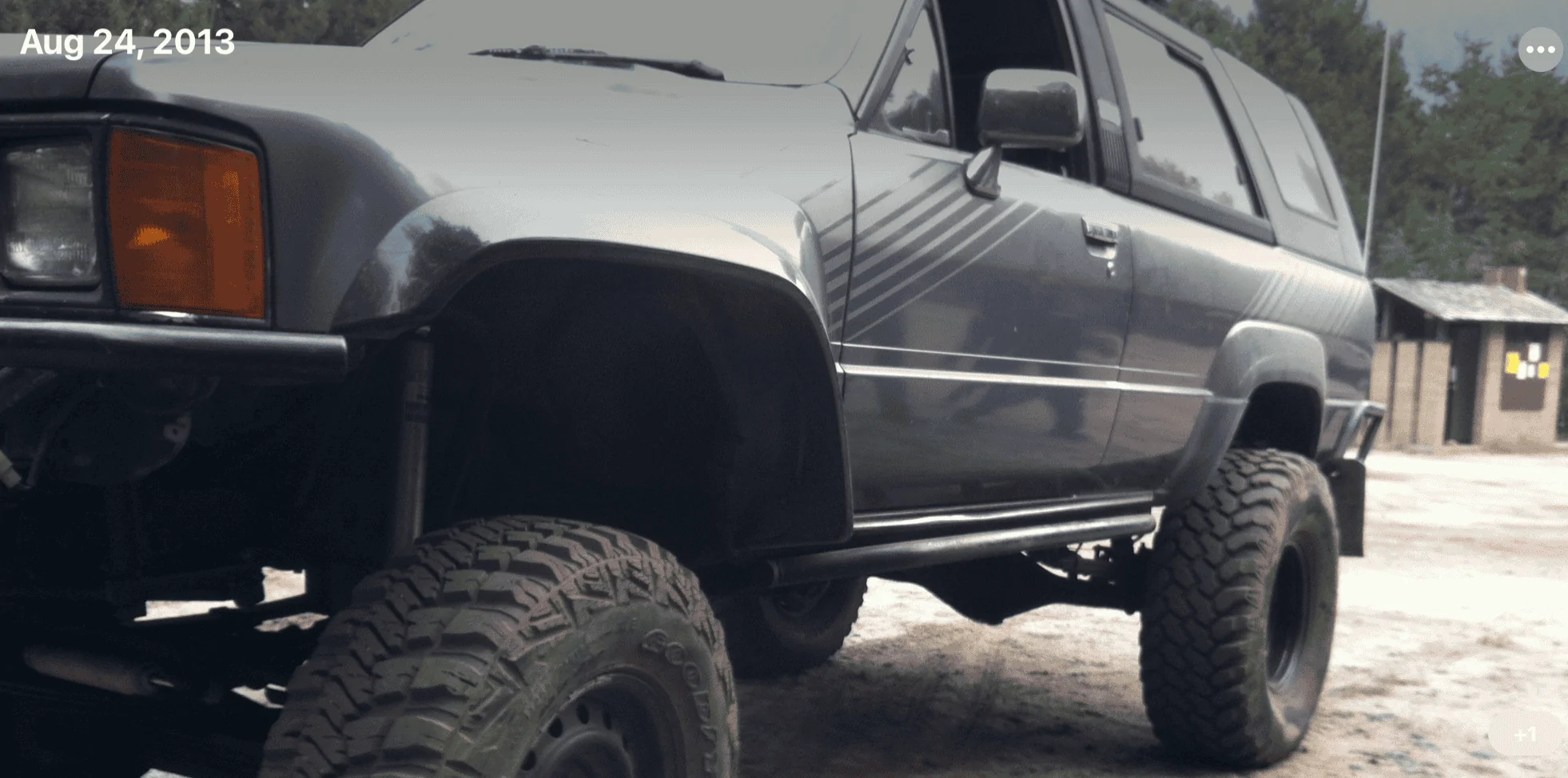

Here's my real world experience with off-size spares. In my Tacoma, the under-bed storage wasn't big enough to locate a 285/70R17 tire that matched the other four on the pavement, so I mounted a 265/75R16 down there - basically a 32" tire. (Later, I got a tire-gate bumper, and an exact match spare, but I digress)
Out on the trail one particular day, I chap in our group with an old 4-Runner tore a sidewall, and used his spare. He was running 35" tires. Later in the trip, he tore a *second* sidewall. (Turns out the tires on his rig were really old, and well past their "best-by" date... but again I digress.)
For the second flat, I lent him my 32" spare. We put it on the front. So he was running 35/35/35/32. He drove off the trail in 4-lo, then 2-hi for the roughly 200 mile pavement trip from the trailhead back to his place up north of Sacto, where I met him to reclaim my spare.
Didn't cause any problems that I'm aware of; though that was just a "trail buddy" and not someone I've spoken to since, so I wouldn't necessarily have heard if he had to tear down that diff a couple months later. I kinda doubt it though. Everything seemed copacetic for the trip.
