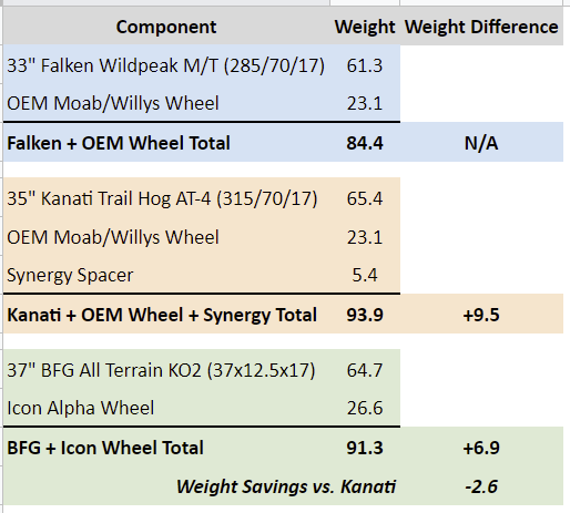

The weight savings of running a 33 spare vs a 37 spare is not that much.
Case in point --
9.5 pound increase from 33's to 35's (including spacers)
6.9 pound increase from 33's to 37's
Jeep Wrangler JL Payload vs Upgrades -- a cautionary tale 33 vs 35 vs 37

Case in point 37" mud grappler weighs 97lbs, raceline beadlock weighs 42lbs, and even the aluminum teraflex spare tire carrier weighs 62lbs (the cavfab version has got to be over 100lbs) for a total of 200lbs. Stock Rubicon wheel and tire weigh 71lbs. That's a delta of 129lbs, or more than most winches and winch plates.

I never said you were running an undersized spare, just commented on the weight not being that much of a savings. In fact, it is minimal in the grand scheme of things on a Jeep that weighs 5,000 pounds. I also did not say that running two different tires up front was unsafe, just not something I would do. The OEM rear tire carrier was never designed to carry a beadlocked 37, no argument there. If that is your argument for the fact that it is heavier, I don't get it never said a beadlock 37 is not heavier. This is weight that is leveraged out further and bounces up and down eventually wearing out the tailgate. You should absolutely upgrade the OEM tire mount if you move up in size. I went with the ACE tire mount that comes with new hinges it is beefy and makes zero noise.
