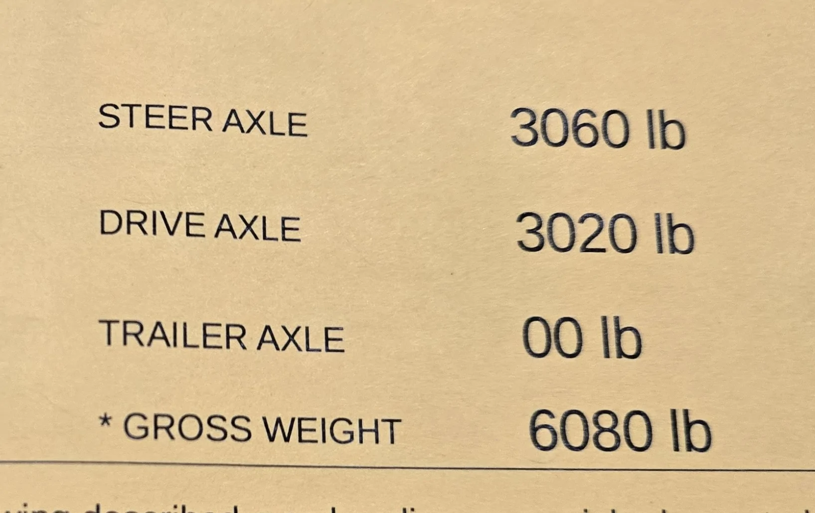

Much has been discussed in these pages about the low payload of our Jeeps and that adding armor and other upgrades could significantly affect the available cargo weight available. From experience with previous vehicles and the disadvantage of excess weight in off-road performance, I planned this build-up to limit weight increase while balancing relative costs. After finishing the major upgrades, I decided to weigh my Jeep and I was shocked by little payload I had available, even after limiting my mods and spending extra for lighter components.
I kept my OEM steel bumpers because I suspect they are lighter than aftermarket steel bumpers, and got creative making them work with a Hi-Lift and shackles. I added 37” tires but kept a stock (mini) spare for the lighter weight. The rock rails and underbody skids were specifically chosen for their weight savings. I also kept the OEM plastic flares and didn’t add any spare fuel/water containers.
In the attached pictures, you can see the stock Jeep had an 800 lbs. payload with a maximum vehicle weight 6100 lbs. (but each axle limited to 3100 lbs.). The scale receipt shows the Jeep now weights 5900 lbs. with full diesel and DEF tanks, but no people or cargo inside (besides the standard recovery gear always onboard). Add a driver and a lunch bag, and I can tell my wife to stay home!
While my Jeep (JLURD w/hard top & most options) was probably one of the most payload-limited, I suspect many of you that have gone with heavier bumpers and armor are probably very overweight. If you have upgraded your Jeep with bigger tires and armor, then weighted, please post your results.

I recently added 40s, swapped to HD steering, installed stronger axle shafts and driveshafts, swapped to aluminum fender flares and inner fender liners. It added 180 lbs.
