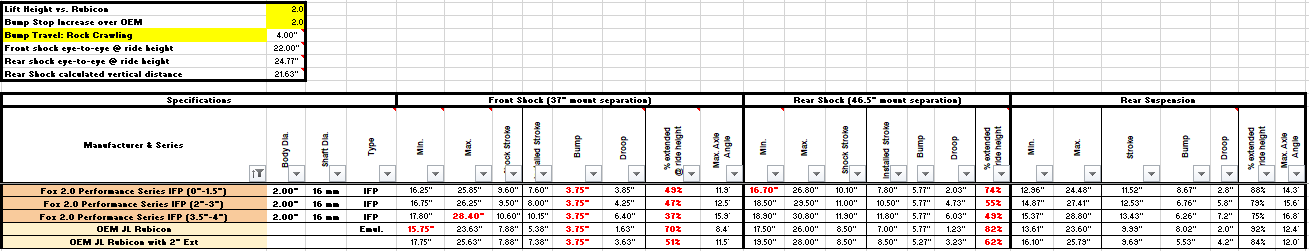

AnnDee444 made a kick ass spreadsheet with a ton of shock length data here: https://www.jlwranglerforums.com/fo...gs-suspension-information-chart-matrix.66591/
Using that, here's some info to support @Roky and @GrayWolf.Overland's recommendations with the Fox 2.0 IFPs.
Jeep Wrangler JL Need some shock advice, please. 1707484931735
With your bump at 2" you need compressed length under 18.25" up front, so all three versions work fine there. Then it's up to you how much flex you want. You can simply look at extended length for that. The 0-1.5s are basically the same as your Rubi shocks with extensions. The 2-3 gains you another half inch, and the 3.5-4 gains you another 2" on top of that.
So while they all accomplish the same thing, you'll gain the most flex out of the longer set.
