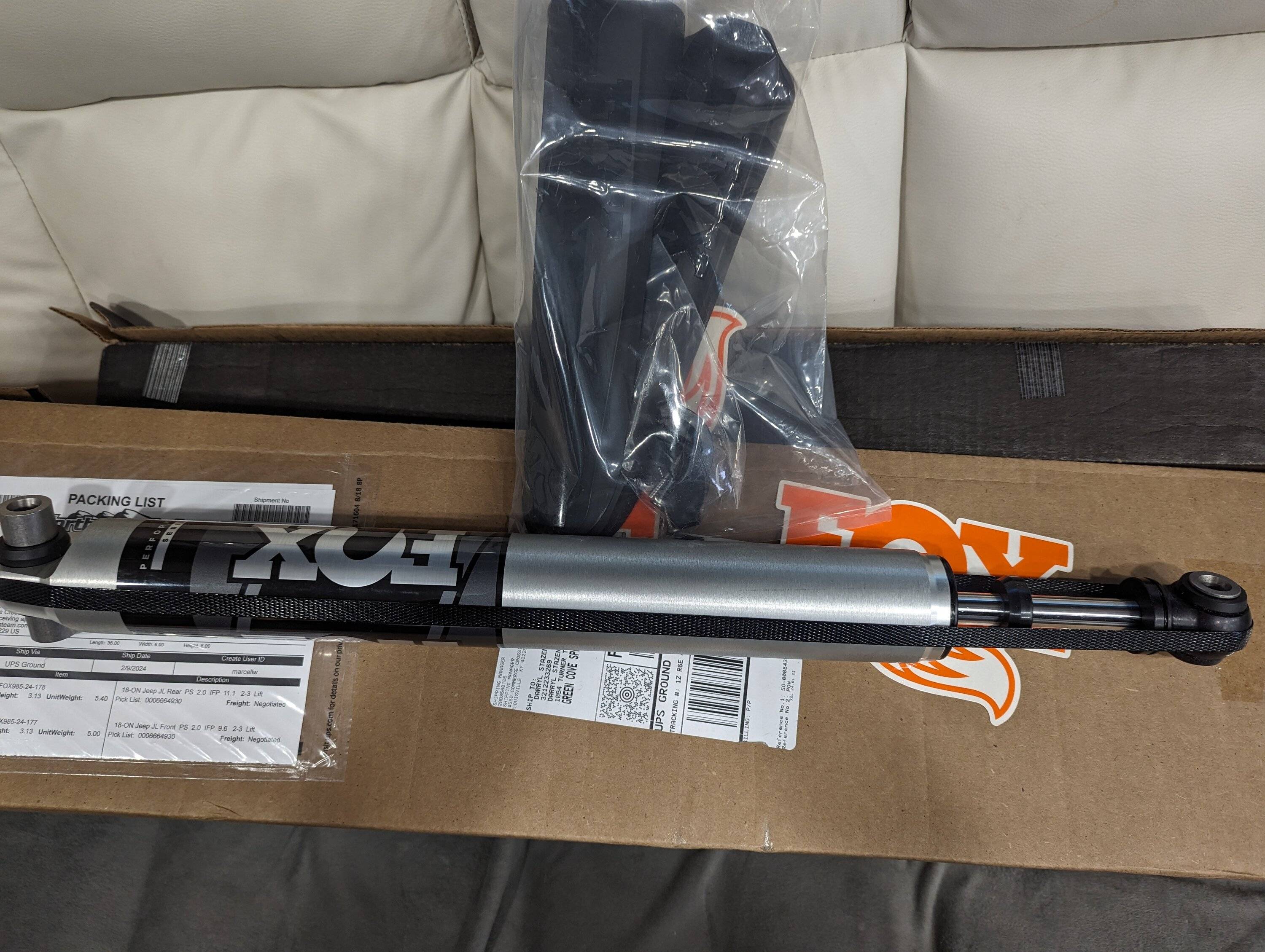

It's Christmas in February. Not really but I love getting new jeep parts. LOL.
New shocks came in. First impressions, wow! Super nice looking. Looks like great build quality. I watched a rebuild video yesterday. Seems to me to be very well engineered shock. When the time comes as long as I can get all the stuff, I can rebuild these no problem. I don't see how they won't be a lot better than the stock Rubicon shocks.
Also Northridge gave me a good price on the racing roost's for the rear shocks, so I figured a little more protection can't be a bad thing.
Install set for Thursday.
